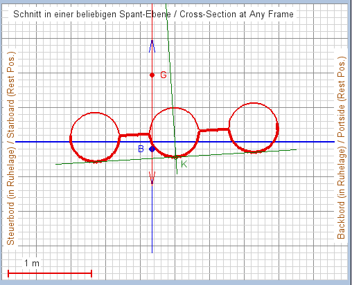

    Look at this calculating sheet (I modelled your pontoon roughly):
    http://www.bootsphysik.de/rechner/bootxp.php
    First click top right button "English", then "choose / alter frames"; in the last line you will find a cross section of your pontoon (if I understand ist right).
    Click this image, if nessecary "back to calculations", "restart frame"; if nessecary, "English" again.
    Top right you will find lenght, beam, displacement and draft (1730 kg, "all people on board"). Right column input box "Mass to Load / Unload"; first type 640 in and then click the button "unload" (4 rows under input box).
    The draft will change from 225 mm to 161 mm.

    Let 3 people enter the empty pontoon at its edge.
    3 times 80 kg = 240 kg, transversal distance to CG is -1250 mm (half beam in starboard direction).
    After click "load" you will see the shift of the new overall CG.
    Click "find equilibrium"; the graph shows an heel angle of 3.5 deg.
    That means, the edge of the pontoon on the starboard side will drop about 10 cm caused by entering 240 kg at this point (in the middle of the lenght).
    Also should be calculated trim effect, but this is not possible with the linked calculation sheet.
    Here is a roughly similar pontoon in 3 dimensions (draft, heel, trim):
    http://www.bootsphysik.de/rechner/boot_engl_pont.php
    Warning: a quick change from one calculation sheet to the other won't work, because the server uses the same session variables filled with "wrong" values. If possible, take another browser or close browser and try again half an hour later.

    There are differences between your pontoon and the modelling on the page.
    The longitudinal spaces between drums are not considered.
    The model has got 3 tubes, each 600 cm long and with 59 cm diamater.
    6 of your drums: 6 * 92 cm = 552 cm. A "loss" of 8%.
    Increasing weight of the pontoon with 8% (140 kg) leads to a draft of 24 cm, which will be nearer.
    (I assumed fresh water, in case of sea water the draft will be a bit smaller.)
    Another point.
    In normal use of this drums they are filled with liquid content. This causes hydrostatic pressure from inside, which is a very different case to what you are going to do.
    The drums are made of plastics and not constructed to withstand a pressure from outside. You must consider they could be deformed after immersing. This would mean a loss of buoyancy.
    Take one of them and submerge it to test it. Enable the air to escape the drum without entry of water. Look at the shape resistance of the drum.
