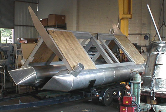

    Comparing the Rolling Barge with a Myark folding trailer barge, it is wide when towing also it needs a trailer to be loaded onto, with the barge structure not strong like the Myark folding trailer barge, Myark 10 metre folding trailer barge can float over 12 tonne and takes a short time to assemble.

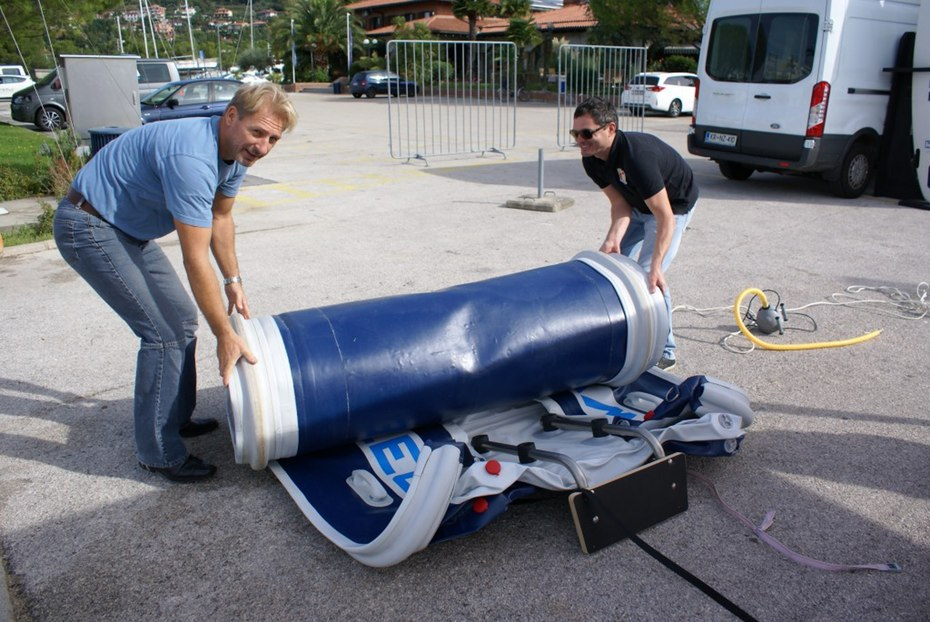

    This folding pontoon has to have a trailer and to wide and awkward to lauch and over weight with trailer, nice try though.

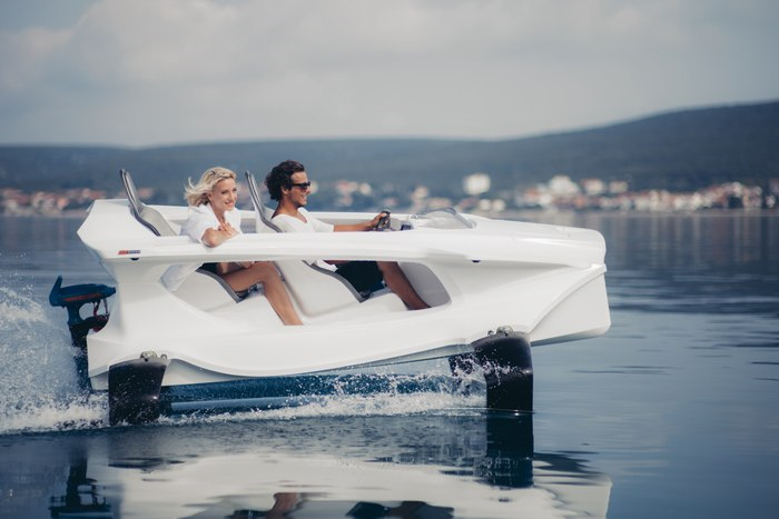

    Thank you Sam for that picture which is inspiring.
    The price is very good, and it works, but it would take a long time to assemble each time and take a lot of car space unless they have a trailer, also I would say not strong enough to hold 13 ton with out structural damage like my early proto type Myark folding trailer barge safely carried 13 tones in shallow water pictured.
    I read on your link they also created the Quadrofoil, what a great innovated company

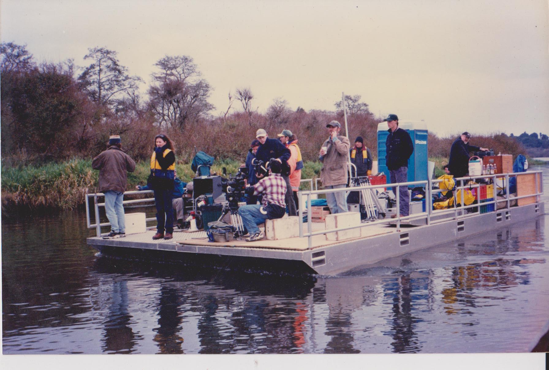

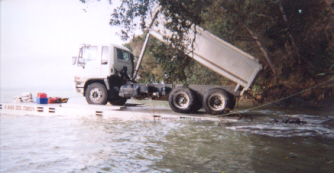

    In NZ I made lots of $ hiring out several Myark trailer barges to the USA movie industry and other commercial marine industry and many forms of work that I was only company available which is 10 minutes to launch and retrieve a barge that is capable of 13 tone in choppy seas and can be beached and launched in any location such as I had entered an extreme surf harbor entrances no other boat was able and used the Myark folding trailer barge as a super large surfboard, lots of fun.

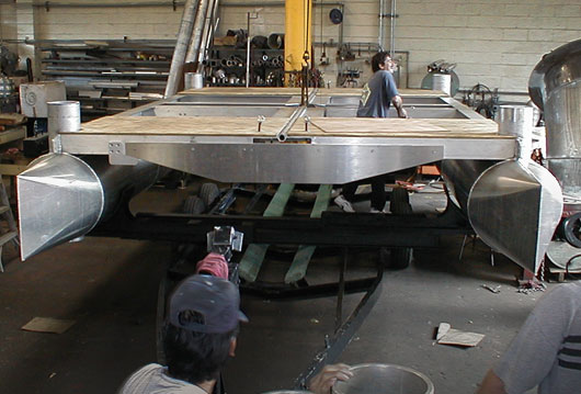

    Pictured below is my latest design Myark folding self-trailer-able pontoon barge that is 90% completed and soon on the market.
    Unfortunately, at this stage I cannot show on the public domain the workings on how the barge actually unfolds-folds, as its patents applications are still in progress, however I can give a basic sneak idea what it looks like in self-folding trailer-able stage as it stands and in the unfolded stage without exploiting the patents application.
    The Myark unfolds with one-person with a press of a button which takes in total 10 minutes on land or water.
    It's surveyed for 8-ton load on deck and the total weight of the Myark is 2.3 ton which my trusty AU Ford Falcon easily tows.
    I towed the Myark barge on a windy day over 70mph for a test trial and was incredibly stable which would be because of the plug-in torsion suspension and weight distributed correctly.
    I use my normal kick up in front and back bottom hull similar to my friend the late Brain Jacksons Caracat which allows the barge back end to act like a hydrofoil because the back-end levels of with the surface of the water and why Brain Jacksons Caracat won many open long distance launch ocean races including the best fuel consumption over that 60-mile distance race.
    This Myark pictured is calculated to float in less than 2'' of water and needs a 60hp electric propulsion pivotal drive surface propulsion to plane, also as from my experience with a larger prototype 10. x 4.8 Myark that easily planned with a 60 hp petrol out board.
    I have also a smaller pontoon model that is 650kg that does not need to be braked and floats 3 ton on deck which is suited for the 4x4 off road vehicles or a household small car that this design also is a pop out camper for land or water amphibious travel while camping in remote wilderness lakes, rivers, islands and harbors.
