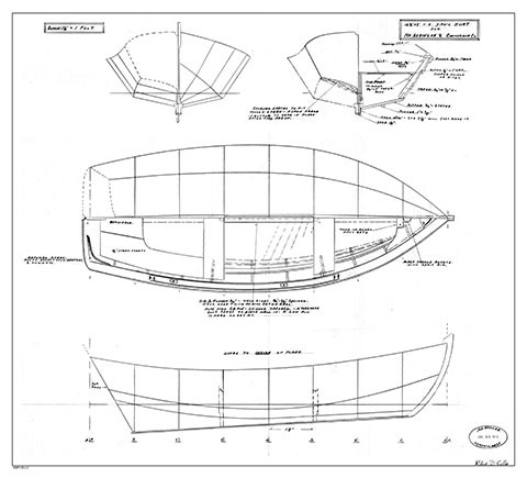

    I'm definitely more drawn to the look of the chine becoming softer and disappearing into the flare near the bow more like this Pete Culler boat (Plans at Mystic Seaport) than the plumb-stemmed dinghy in the link. Culler Vee bottom yawlboat lines Mystic.jpg
    I was just hoping to make mine a bit faster under sail than the Pete Culler boat, which is bigger (12'6" (3.8m) length, 5' (1.5m) beam), much heavier because it is traditionally built, and purely a displacement hull as far as I can tell.
    If I make the chine wider in the front half of the boat, with the knuckle harder and further into into the bow, it would be a sharper bend for the plywood. Last weekend I made a cardboard model trying exactly that, but didn't like the look of it. One might have to cut the bottom and sides apart almost completely, which is what I was trying to avoid. There is another similar design out there, Martha's Tender, that is built on chine stringers. Tenders - Prams - Martha's Tender https://www.woodenboatstore.com/product/plan_Marthas_Tender/tenders_-_prams . The chine knuckle of Martha's Tender carries right into the bow and the bottom and side panels are completely separate.
