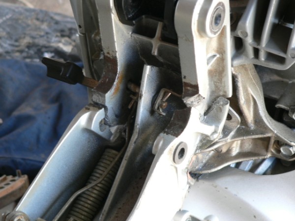

    I need advice from anyone familiar with swivel case removal/replacement on a late 2005 HONDA 8 BAAJ outboard. The swivel case was fractured right through when customers of the last owner (hire service) backed the engine into a wharf. I bought the unit at a very good price and with only 40 hours total use, it is certainly worth fixing
    The shop manual has been downloaded. good parts drawings/ part numbers found and the springs, tilt lever, arm, bushes etc have been removed. That was the good news.
    The bad news is I cannot remove the 2 bolts holding the tiller arm to the swivel - they are so tight I'm afraid of breaking them off inside the housing. The second problem is undoing the lock nut/sleeve nut at the bottom of the shift rod. The gear lever seems not to fully engage reverse and that might cause lack of clearance OR do I need to undo the main drive shaft too? The manual implies the engine itself has to be removed but from the drawings, this seems an excessive amount of work
    If the entire swivel case can be removed, aligning the bits and welding it is one option - another is to replace the part for a bit over $A150 (plus new bushes, pins etc.
    Any advice from someone who has stripped/repaired one of these units would be very much appreciated

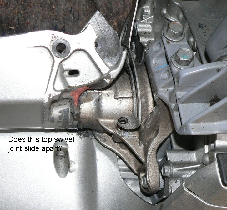

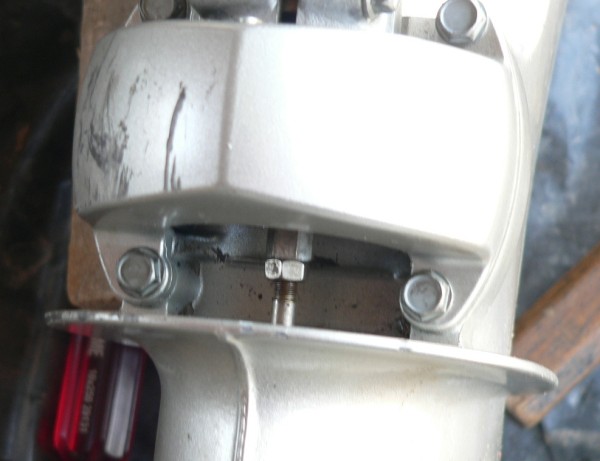

    HONDA 8 swivel case replacement
    OK here is an update - discovered that it may not be necessary to remove those two locked-in bolts IF the swivel disconnects - see pictures.
    Unresolved questions:
    1 Does the top swivel side apart?
    2. Why will the shift rod not undo completely? Do I need to remove the gearbox?
    Any help appreciated
