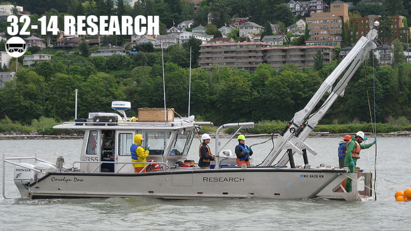

    So I have been asked several times by friends and fellow boaters to assist with their mooring maintenance and/or seasonal removal. This season alone I did 22 mooring wintersticks not including my own 3. The heaviest being a 4,000lb block that I actually dove on and swapped out chain. Many of the owners pay me $100 bucks and it is what it is.
    As a builder/carpenter/GC by trade I’m looking into building a “barge” that will make handling/hauling chain, buoys and even maybe haul some of the 250lb-500lb mushrooms. When not handling moorings I can use it to do some dock work and light marine construction nothing to big just little repair jobs. Where I live and work their are countless docks and potential clients and maybe 3 or 4 active marine carpenters or mooring haulers.
    What I have in mind is 8-10’ beam(I understand will be difficult to over the road transport) by 26-30’ length. Maybe a small enclosed helm station since I would be operating in all 4 seasons. Just quick research indicates an A-frame style hoisting point with a roll bar? Thoughts? Electric or hydraulic deck mounted winch and a moon hole or right off the front of the barge.
    Also not sure of the material to use for the hull. I know I want it to be a self bailing hull with a real shallow draft, able to not only haul out 1000pounders maybe more with break out force but also carry the weight. Conflicted on weather marine grade ply with glass is the way to go or start experimenting with paints and sealers.
    Any help and insight you guys have is greatly appreciated. I have included some of the barges I have seen.

    A common setup is a barge with a hole in the middle. You can pick up the weights without creating stability problems. There is an arch over the hole with a winch or chainfall.

    From my own experience with barges the greater mass they have in relation to the load they are carrying the better they work. Stability is better and draft in loaded vs unloaded changes little (and believe me the latter is a big deal). Since I assume you'll be operating in low speeds mass won't have a big impact on the force needed to push it. So I say steel – easy to work with, easy and fast to maintain and repair, sturdy.

    Two pontoons, 36 inch dia x 0.250 wall steel, 25 feet long, 11,000 pounds buoyancy @ 18 inch draft
    Hull weight, pontoons and structure, around 7000 pounds, leaving 4000 pounds for wheelhouse, machinery, plus lifting whatever.
    A rectangular barge would be more compact, but building a pontoon barge with steel pipe 25 ft long x 12 ft beam, would be far less labor intensive. A reasonably skilled person can pick up arc welding to an acceptable strength level fairly quickly. If I were building such a barge I would make it in two pieces, to be bolted together after transport to the launch site. Surplus metal yards around me have the material, at about $0.50 per pound.
