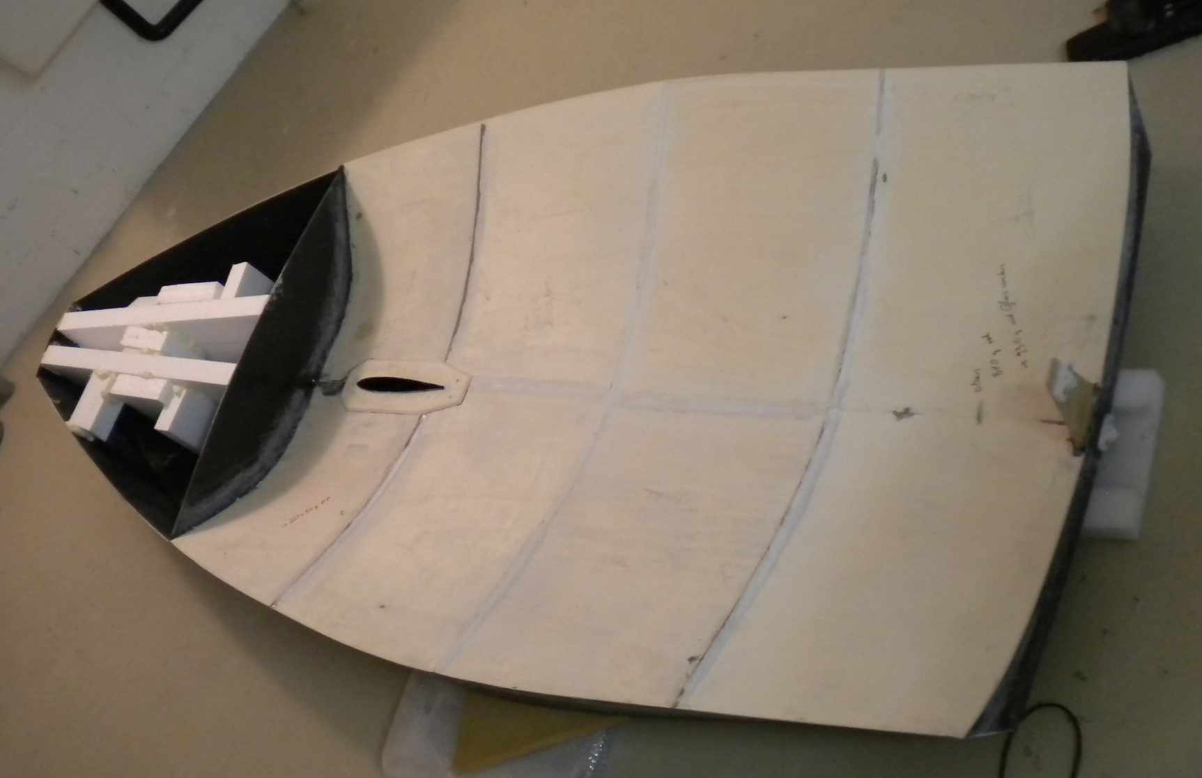

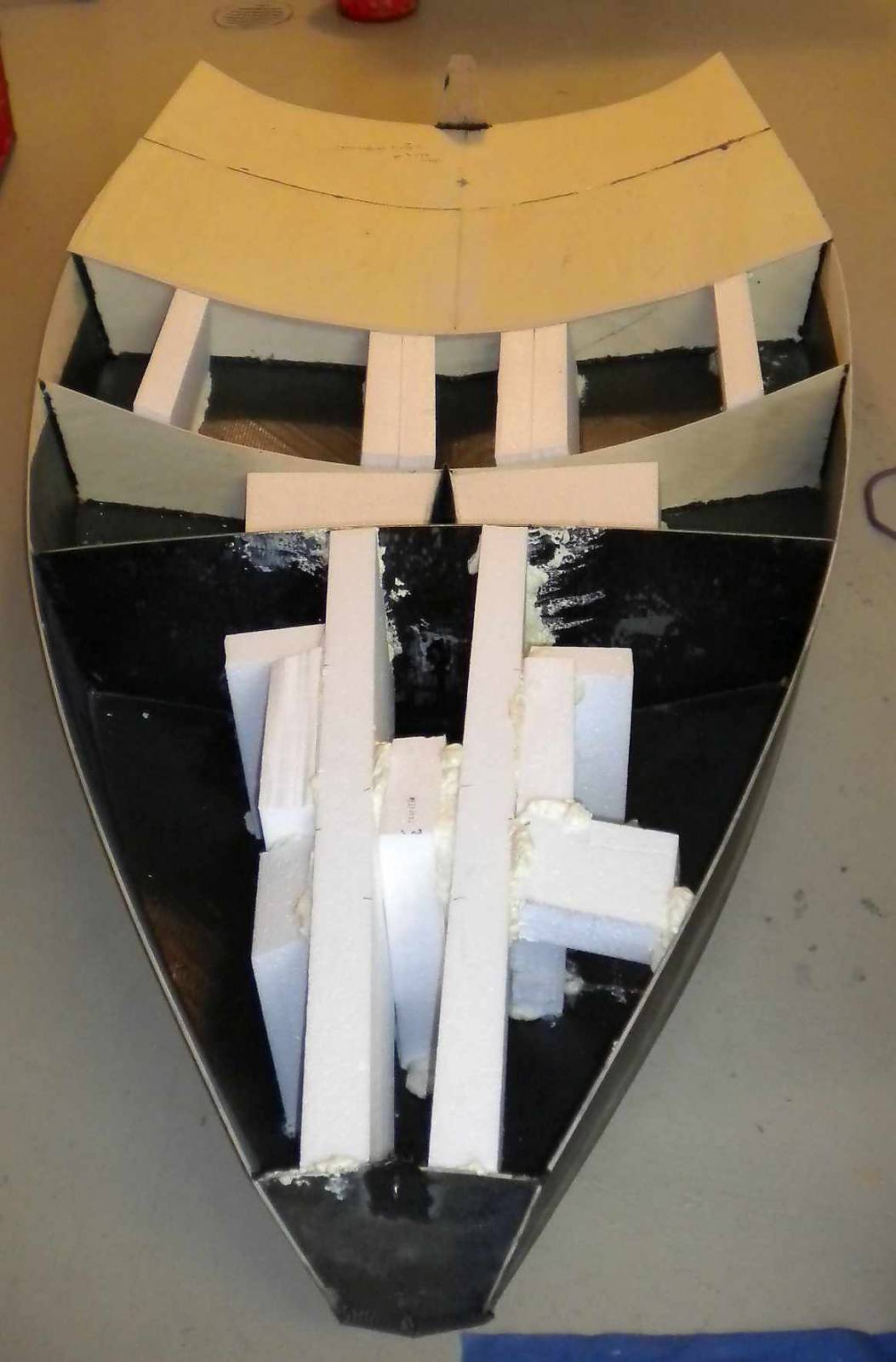

    Cockpit floor
    When drawing the lines of the cockpit (see post # 3) I intended to use a single plate of 3 mm plywood as floor. The centerline of the cockpit floor between main bulkhead and transom was drawn as a straight line, sloping slightly towards the back to get the water out of the cockpit. While building I changed this plan, because
    a) I doubted that 3 mm plywood would support my weight, and
    b) I doubted that I could apply two types of glue and place and fix the floor to all the bulkheads and styrofoam blocks before the glue was curing.
    The plan was therefore changed to four pieces of 4 mm plywood with scarf joints. The underside was coated with glass (80 g/m^2) while the plywood was bent to shape. Starting from astern the pre-bent pieces were glued in. For the connections between glass, epoxy and wood a mix of epoxy with short carbon fibers was used. The connection between the floor and the buoyancy styrofoam was done with polyurethane foam. Since this foam is curing very quickly, the whole job had to be done as fast as possible. To avoid that the expanding polyurethane lifted up the floor, I used all available clamps, weights, and adhesive tape.
    With kind regards
    Ara

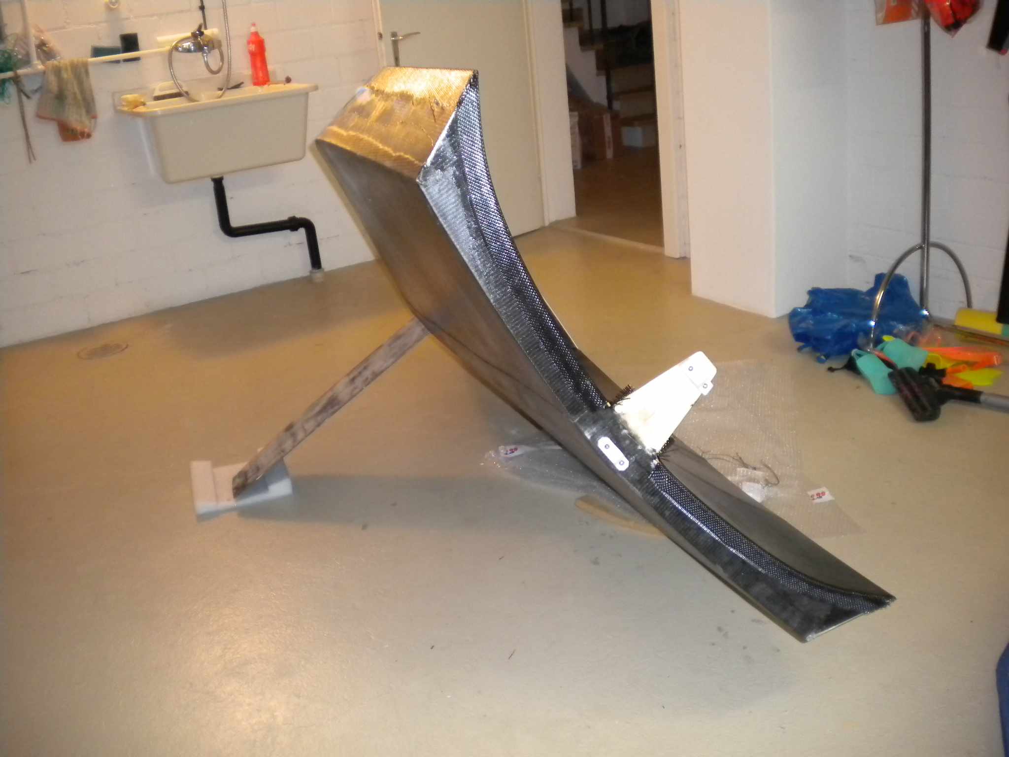

    Foredeck
    The cockpit floor was covered with carbon cloth (linen, 160 g/m^2). Before the front compartment was closed, attachment points for shrouds and forestay made from 4 mm stainless steel were installed.
    The foredeck was glued in place, again with epoxy and polyurethane.
    With kind regards
    Ara

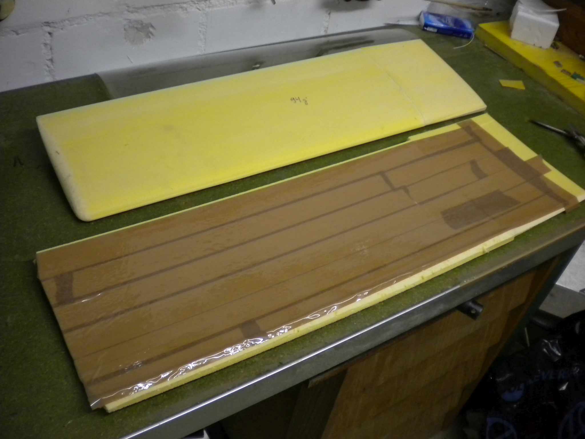

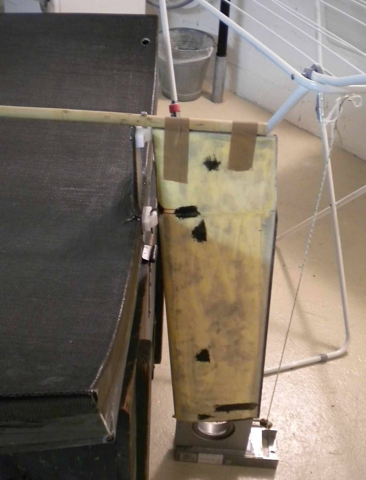

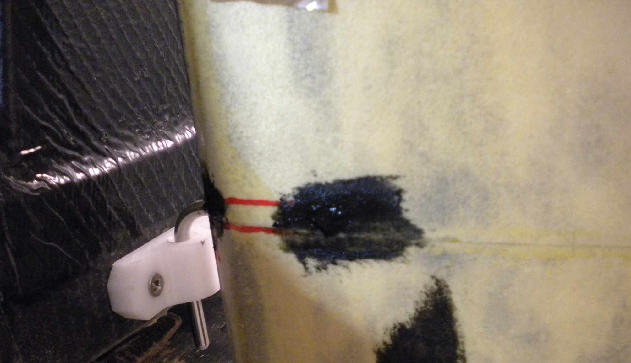

    Rudder
    The rudder has a NAC0012 section, 195 mm chord at the water surface, 185 mm chord at the bottom end, and draft is about 520 mm. The core was cut from yellow styrofoam (30 kg/m^3). After covering the first side with carbon (2 * 200 g/m^2, biaxial, 1 layer +- 90°, 1 layer +- 45°), two holes were drilled into the foam core for the lower pintle. One to take up the pintle, and one at its end, perpendicular to the pintle, to transmit the forces to the carbon shell. Rudder, tiller, and lower pintle were aligned on the gudgeons, and the pintle was glued into place with an epoxy/short carbon fiber-mix.
    Then the second side was laminated with carbon, and the tiller with the upper pintle was glued on.
    Including the bamboo tiller, but still without tiller extension, the rudder came out at 580 g.
    With kind regards
    Ara

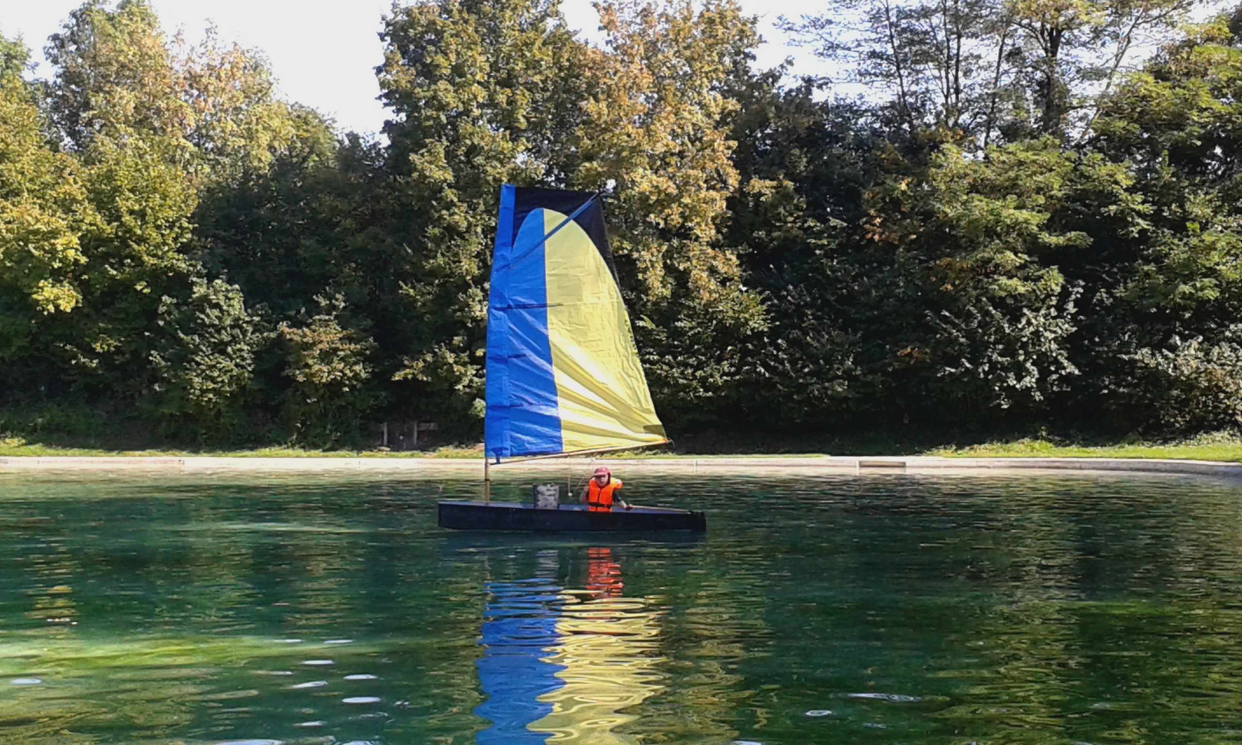

    Rigging and first trials
    For the beginning I built a simple rig from materials I had at hand. The whole boat building story started about a year ago, when I was sailing with my son and a nice bamboo stick came floating down the river. We picked it up, and it looked just right for a mast.
    My brother, a passionate kiteboarder, donated an old but rarely used 17 m^2 Cabrinha tube kite. The sleeve for the front tube became the mast sleeve, the other tubes were removed, the size was cut to about 3.2 m^2, and my father helped with sewing of a batten pocket. The lines of the kite, made from some low-stretch fibers, became shrouds and forestay.
    Up to now the whole rig is very preliminary, but we wanted to bring her to the water before the end of the season.
    With kind regards
    Ara

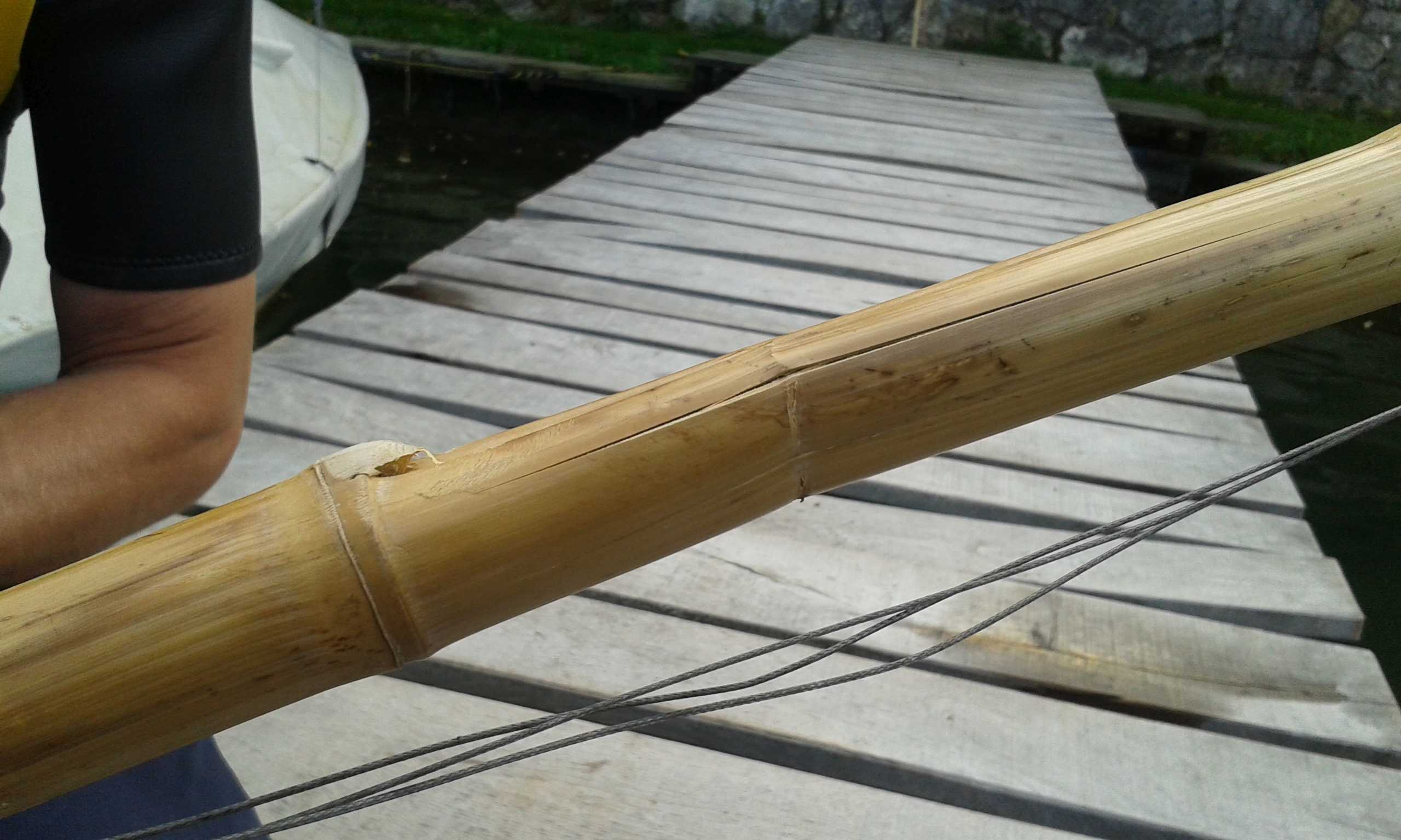

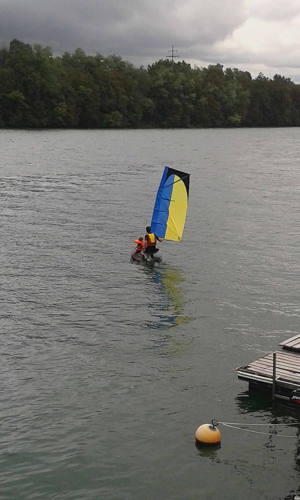

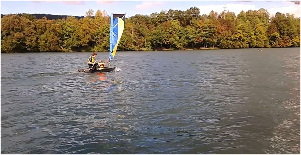

    Choosing a new mast
    For Sunday afternoon windfinder.com had announced 12 knots with gusts of up to 19 knots, i.e. perfect weather for some training on the new dinghy.
    Initially, everything went really well: The dinghy is easy to handle, stable enough even when loaded with two people of 16 kg and 70 kg, the cockpit is self-draining, and it looked like there is some potential for good boat-speed...
    It also looked like there was quite a lot of twist in the sail, the boom was bending, and then the rig came down... Probably not an unexpected happening for readers of this forum. In post # 5 of the thread "Bamboo as mast and spars" PAR wrote: "Bamboo would seem a terrible choice for spars on all but the smallest boats. Even on these you're paying huge weight penalty for the convenience of using bamboo."
    The sailing season is anyway near its end, so I have the time to buy or build a new mast. The overall dimensions of the rig seemed to fit to the dinghy, so I would stay with the same mast length of 3.12 m. The bamboo had a diameter of 40 mm at the bottom and 17 mm at the top, and weight was 700 g. Shrouds and forestay were attached 250 cm above deck, and the batten ended in a "camber inducer" tied to the mast at a height of 220 cm. The mast broke at a height of 190 cm, where the bamboo had a diameter of 29 mm.
    Options are:
    - buy a used standard windsurfing mast (certainly strong enough, probably stiffer than necessary)
    - buy a used children windsurfing mast (harder to find than a standard one, lighter, still strong enough)
    - build a hollow wooden mast, maybe in combination with carbon/epoxy (fun, but necessary dimensions, strength, flexibility are hard to predict)
    - find a thicker bamboo (see PAR's quote above)
    And a smaller sail for really windy days is also an the to-do list.
    With kind regards
    Ara

    looks like a fun little boat, nice work.
    structural properties of bamboo are not very good, I would not even consider using it at all.
    a solid wood mast of clear pine should be inexpensive to make, though a bit heavy, but not that big a deal on a 3 m mast. A hollow one would save weight, but a lot more work to make. it probably is not necessary to wrap a wood mast with carbon/epoxy, a carefully made laminated hollow wood mast should be strong enough.
    Or just find any used mast off of any small sail boat, or sailboard, and cut it down if too large.
    Good luck.
