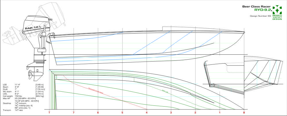

  7. PAR
    Joined: Nov 2003
    Posts: 19,126
    Likes: 504, Points: 93, Legacy Rep: 3967
    Location: Eustis, FL
    PAR Yacht Designer/Builder
    The image shown above is the very old style, with shallow, warped bottom hull forms. These are fast, but beat the crap out of you and handle like crap.
    This is one of my designs and more typical of the modern interpretation of these old class racers. This will get up and scoot, with a 10 HP outboard and fly with a 25 HP outboard. This one is shown with a long shaft, which I consider a safety issue, but a short shaft cutout is also indicated. An inboard could be fitted, but with this deadrise, you'd be hard pressed to get a reasonable shaft angle. Maybe a tunnel hull would be a better choice.
