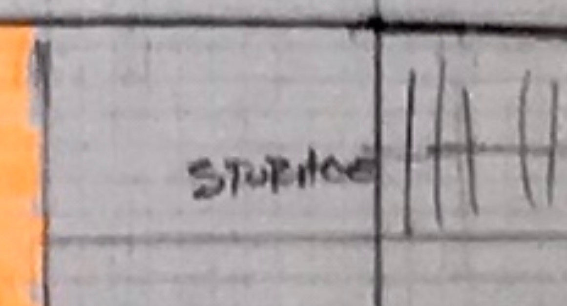

    Does anyone know what it says here . . ?

    Most of the letters match STORAGE.
    Thanks for posting the additional info.

    Ah, that makes sense, thanks . . :)

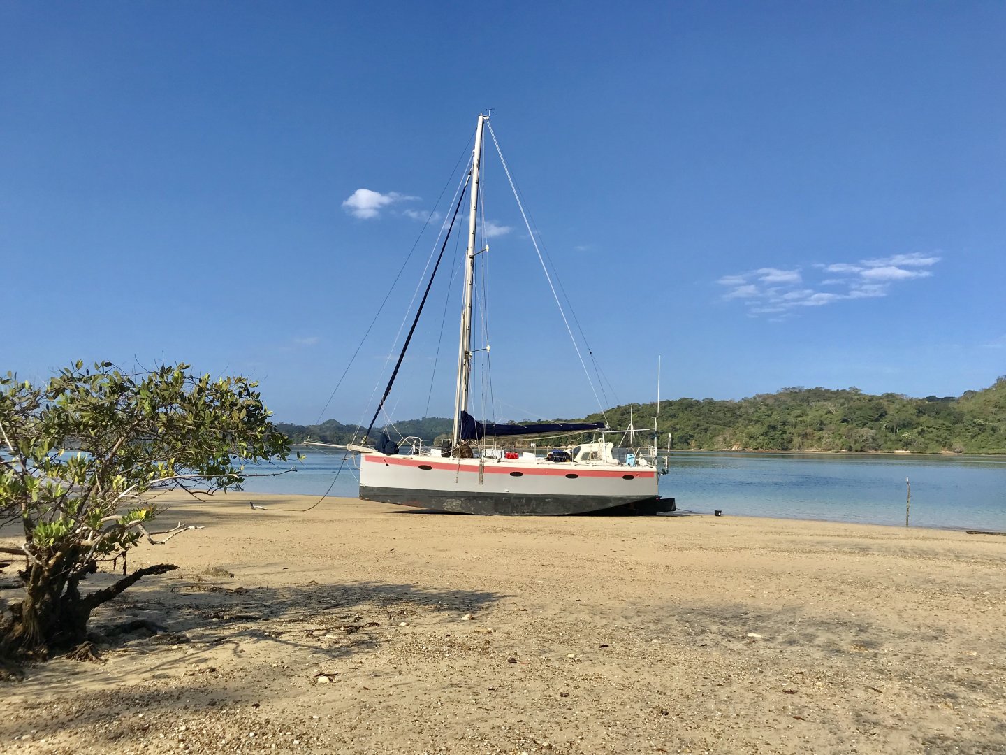

    132865CA-DD85-4BF6-9C46-DCBC6491D636.jpeg E8AF50B1-4996-4A7D-A1C2-6B9986129F2B.jpeg 7ED9D320-17A9-493F-BFC7-0C8364DE7FD5.jpeg Hi everyone, sorry but have been busy this past time building boats and sailing about. Today finds me anchored on Hogfish Maximus off of Rapa Nui Easter Island. Took 21 days to sail non stop from Panama via the Galápagos island where we sailed down the Lee of San Christobal Island for a look see before turning SW for Easter Island.
    Mileage was 2985 miles for this leg which took just under 21 days. I used the motor to cross the ITCZ for 80 miles only. Best days run was 190 miles.
    Next stop is Pitcairn and onto Mangareva, Marquesas, Tuomotus, Tahiti, Hawaii and on up to BC where we will cruise from for a couple of seasons.
    We sailed 90% of this leg with the daggerboard up so in essence we crossed the Pacific keeless.
    Wind was 75% close hauled sailing.
    Look us up in BC to go for a sail on the ole, now 20 year old boat. She has logged now 33,000 offshore sea miles.
    Not bad for a plywood box boat.
