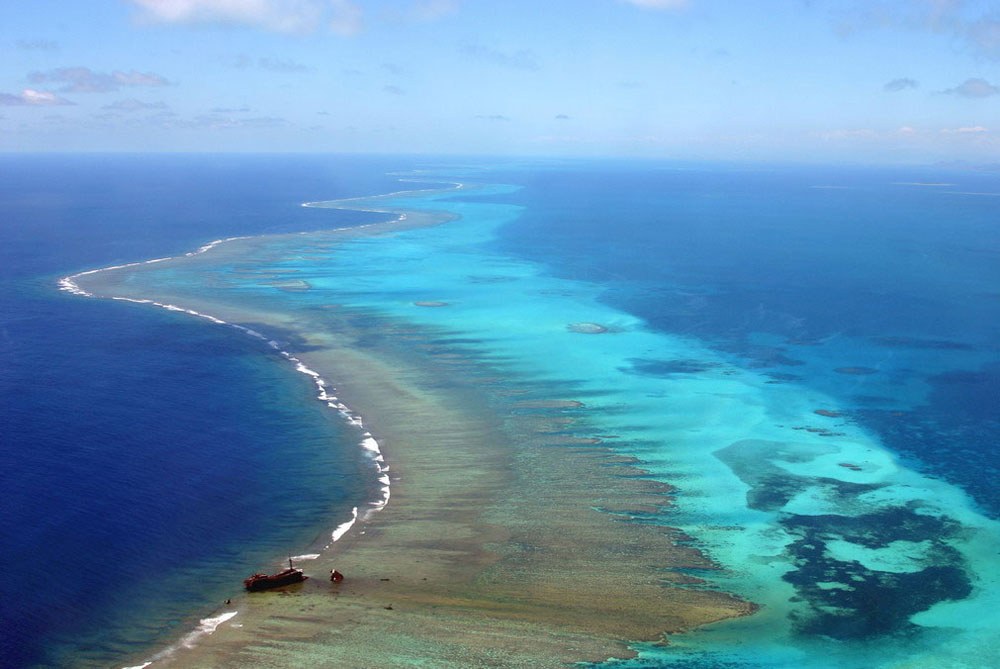

The cause is often fatigue of the skipper when wooden boats are lost on a reef where steel would have survived after being dragged of the rocks.
Below the stories of two beautiful wooden boats (too small for steel) that both were lost by this cause on their maiden voyage . . . . :(
The fact that the skipper of Happy "spen(t) the night on the overturned hulk of a steel wreck" would seem to indicate that steel boats don't always survive and get dragged off the rocks, though.
Right, there are several wrecks of freighters there that maybe were too big to drag off with the equipment there available, or just not worth the effort, so they were left there to rot away....
Below an example of one of those long time New Caledonian wrecks, don't know the exact location of this one...​
Here's a remarkable story of two the same Liberty Ships with both the same name Ever Prosperity, sequentially named I think, that were both wrecked there by the same captain on almost the same place just off Nouméa, the capital of New Caledonia . . . .
Below the Liberty Ship Ever Prosperity, grounded in 1965.​
Below the Liberty Ship Ever Prosperity which was grounded in 1970.​
The next one is the same 1970 wreck taken from the other side.​
The one wrecked in 1970 lies at 22°27'20.7"S 166°22'00.7"E, just south off Nouméa on New Caledonia, the one wrecked in 1965 lies a bit NW of it at 21°54'38.5"S 165°45'19.0"E, zoom in to see the wrecks, zoom out to see the distance of the reefs and banks to New Caledonia and its capital Nouméa, there are clickable pictures at the bottom of the linked pages of which the supply changes when zooming in and out on the satellite view.
Howard could well have sought shelter for the night in one of these Liberty ship wrecks as they were 12 and 17 years there at that time (1982) and must have been in a better shape than in the above quite recent pictures where they are rotting away for almost half a century.

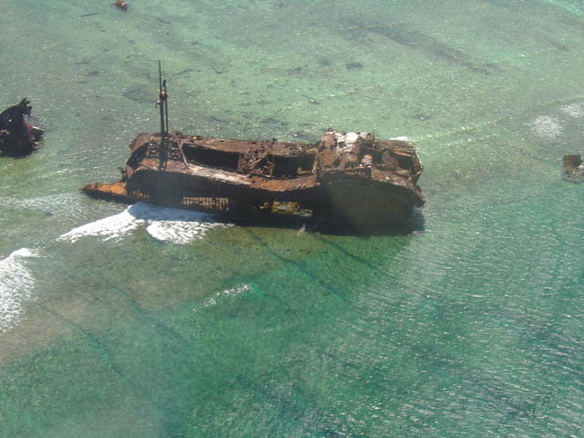

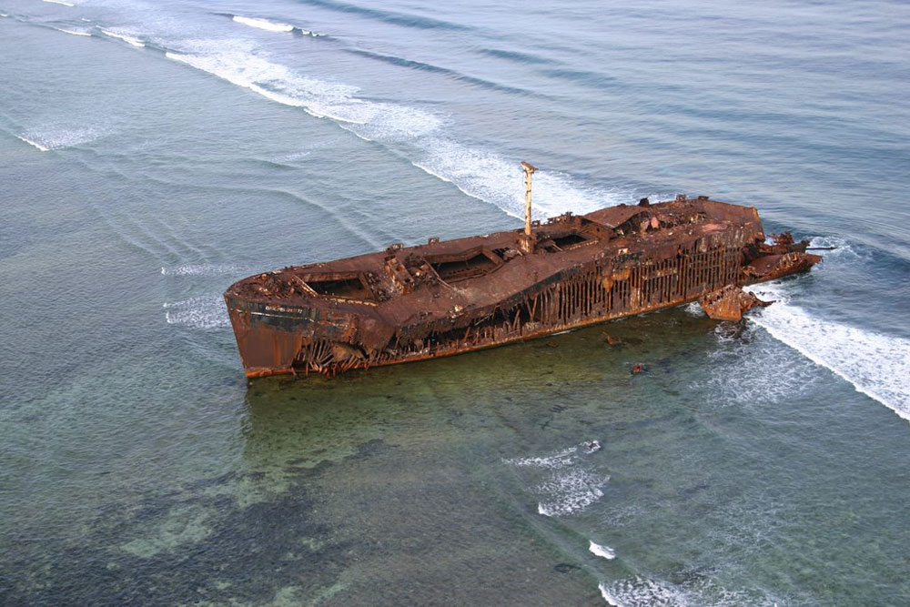

- - - SS Ever Prosperity [+1965] - - - MV Ever Prosperity [+1970] - - -
The appearances and the locations and dates are consistent with the above post, except for the below 1979 picture which was uploaded in 2005 and in the 26 intermediate years looks to be swapped between the two . . .
Notice the view obliquely from behind, which doesn't provide a good visibility of the steepness of the bow, but more displays a view on the longitudinally hull curvature towards the bow I think.
Here and on the 1970 wrecksite link it says above picture is the 1970 wreck, but from the Google satellite view and the more recent pictures, on which alas the wrecks also are more deteriorated, it looks more like the 1965 Liberty Ship wreck to me, so it could be a copied mistake, also it looks like a Liberty Ship to me, which is in contradiction with the other info on the linked 1970 wrecksite page.

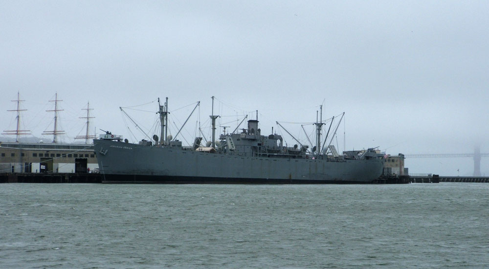

For comparison below the SS Jeremiah O'Brien, one of the only two preserved Liberty Ships...

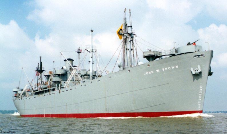

I don't agree with the general disparage for their appearance though, when looking at the SS Jeremiah O'Brien and the SS John W. Brown I think they're beautiful . . . . :)
SS John W. Brown on the Great Lakes in 2000.​
The general disparage for their appearance could have been caused by the often heavy and chaotic burden these Ladies had to carry, and being badly maintained after the war while suffering from many war wounds that were poorly patched just to survive for the time being....
- click pic to enlarge -
Aerial of SS John W. Brown outbound from the United States carrying a large deck cargo after her conversion to a "Limited Capacity Troopship."
It probably was taken in the summer of 1943 during her second voyage.

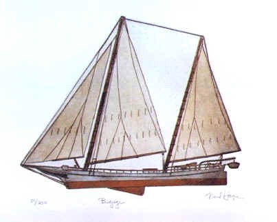

The reason I do not like the two mast set up like on the Cheaseke Bugeye for small offshore boats under 50' are as follows... The mast rake is terrible for going up in a bosuns chair. The booms in light airs want to swing in so have to be vanged. The forward mast is right where you want a nice cabin bunk. Also makes working on the fordeck a real pain as not much space. The mizzen always is in the best spot for accommodations. When reefing the two masts do not give very good luff drive. You end up with over 45% more mast weight, windage and rigging.
If sailed properly trim is never an issue. In going to weather the mizzen if not spread out far enough aft will slow the boat down by being back winded from the mainsail. In order to win races a boat must be very fast and efficient to windward first. All the sled type wide boats do not win around the bouy races because they are not fast enough when going to weather. You must sail to weather very well or you will not be safe and will not enjoy your boat.
In small boats like Rodger Martins Presto the two mast rigg works great with great expense and a well designed hull. Build this boat heavy with solid wood masts or larger diameter aluminum masts she will still go along but at nowhere the same speeds or as well to weather.
The mast on The HFM can be lowered by one man to the dog house cabin top. Then I need some help in moving the base forward if in a hurry.
