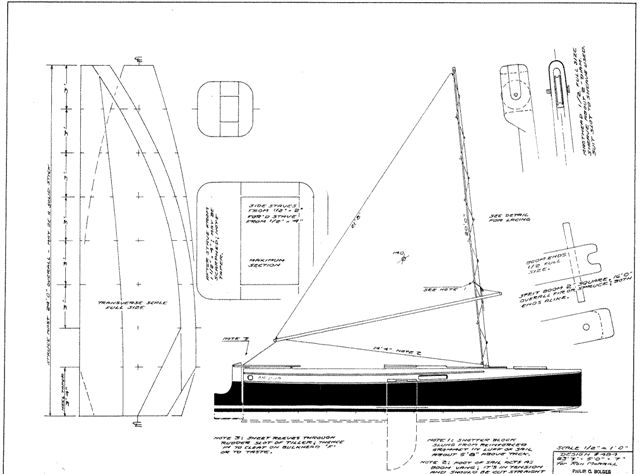

Currently I am involved in designing and building a sailing dinghy for the Hardware Boat Challenge.
http://www.boatdesign.net/forums/sa...input-proposed-rules-42343-55.html#post736278
But I am already thinking about the next boat. I am tempted to build something like a scaled up Bolger EEK, possibly with water ballast. I wonder if any such have been built, and if the hull actually works.

I agree with the comments about the EEK, Anhinga, and Economy Cruiser, a boat with a similar rate of change of displacement at each end like the Bolger Birdwatchers series should be vastly easier to sail than EEK. HOWEVER, being of an inquiring nature, I am at least considering building such a boat, merely to find out.
It's profile is a bit like the old Scandinavian cruisers, the Tumlare in particular, which I admire greatly. I know profile is just one dimension, and a relatively unimportant one at that, but the thought is there. Like the Tumlare, its ballast, and indeed rig CP would need to be rather further aft than 'normal', but that is a matter of detail. It's also why I am considering water ballast.
Having said that, the vast majority of 'flat' bottom sailboats have more, or less, rocker. See the Atkins family of flat bottom sailboats, Brewer's dory series, and especially Bentford's dory's, these latter all having an immersed forefoot.
Unless you make a fairly good copy of the Merry Weather, or Active 3, above, I would avoid absolutely straight flat bottom profiles.
Plenty of 'flat' bottomed sailboats have rudders protected by a keg, or keel, the Brewer designs are excellent examples, including full keels and fin keels, often available on the same hull.
I have mixed feelings about protecting rudders. Most of my sailing, even offshore, ocean crossing, has been with spade rudders, often transom mounted. Though theoretically easy to fix, they can collect nets, fishing lines, plastic bags, and kelp, etc. This can be removed easily enough, but needs a vigilant crew to spot it, something we take for granted on a racer. My limited experience 'cruising' suggests some sort of guard, or skeg, in front of a rudder protects it from some forms of contamination, and also prevents premature stalling when subject to extreme rudder angles (in the heat of the moment shall we say). I would still tend to favor a spade, and transom attach, as easier to see and fix.

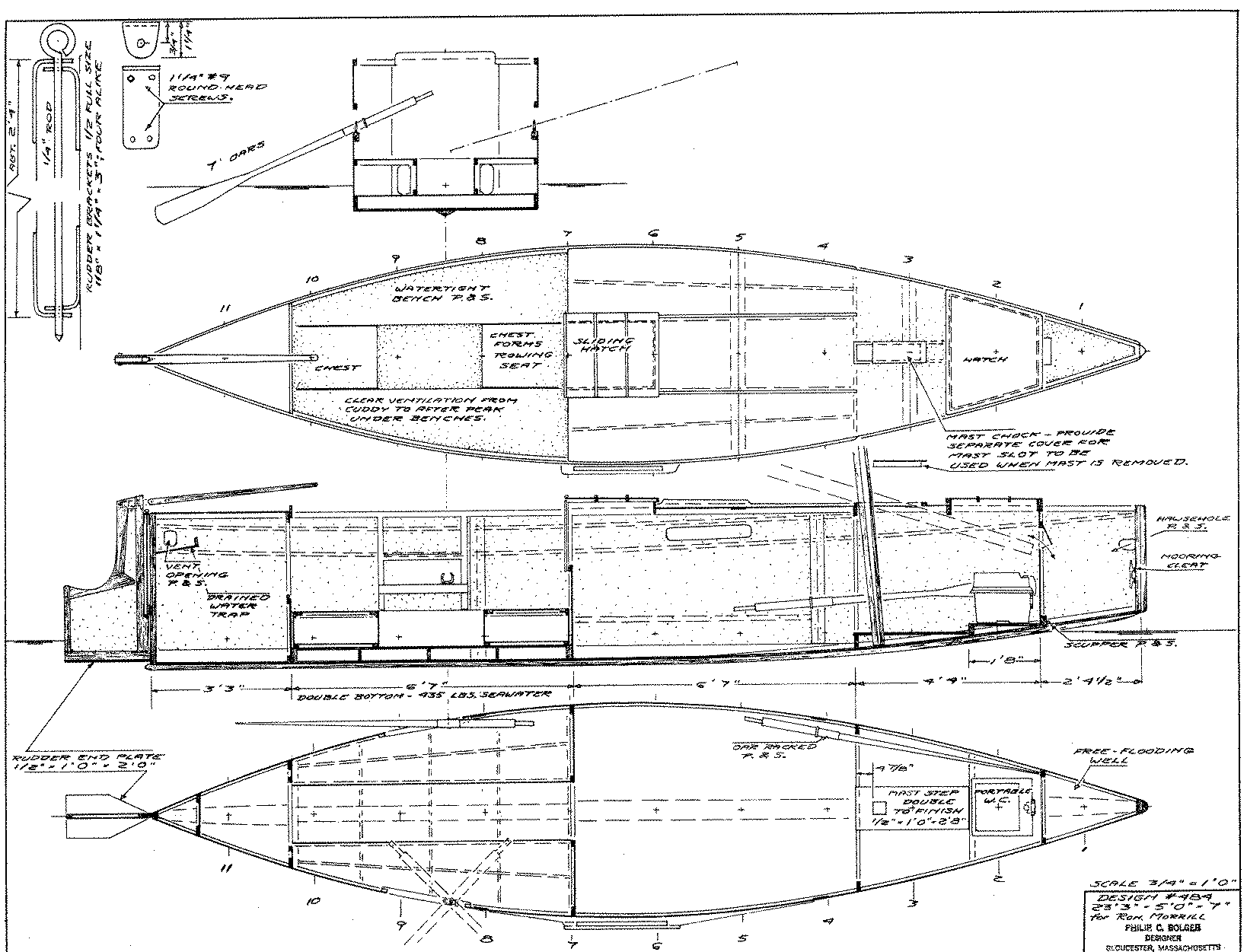

Some info on the larger versions of EEK!
The boat built is called Sandy Bottoms.
Thank you Tad,
I am very impressed with these having never seen the Anhinga plans before, and only having the "hallman.org" illustrations, and half remembered images from Bolger's books for EEK and the Economy Offshore. Now I know what the mysterious black bars are on these boats profiles. My imaginings were rather similar to Anhinga in fact, including the water ballast. I notice the builder seemed quite pleased with initial performance at least.
I think my proposed version might carry the displacement further aft, making the plan form less symmetrical fore and aft, and the aft quarters more full. I will probably rig it Gunter Ketch, with a jib, but a straight Ketch will be considered too.
My earlier imaginings saw a 40' Economy Offshore, so it had more headroom, using the space under the cockpit floor for an engine, horizontal shaft, to a propeller between the transom and the rudder. I would have raised the 'seat' hight, and filled the space with water ballast.
When I return to my CAD system in Seattle in July, I'll work up a sketch.
I'm uncertain about the effectiveness of that rudder end plate. In aerodynamics, end plates are roughly half as effective as the same span added to the actual foil. I might favor a vertical sliding blade, but then again, I sail transom hung rudders a lot.
Bolger drew, and used, a double, or biplane, rudder. Old theory had it that biplane wings needed to be at least 2 chords apart, though this 'rule' was complicated by stagger, and differential sweep. This sort of worked at lower speeds, but now we know better from tunnel testing etc. As his biplane rudders were about 1 chord apart, interference drag must have been severe, especially as speed increased.

Regardless, I am still interested in building a sort of Anhinga analogue, with a Ketch rig, water ballast, and slightly revised lines, as an experiment, but I have to get the 14'er finished first.
Hi SailorAlan,
we have conversed before....
Bolgers EEk the 34 foot version is only a partially thought out design. She had the Bolger flaw ( my opinion) of having the forefoot slightly out of the water. My opinion is based on conversations with Bolger box boat owners and my experience with the Meadowlark, which of course has an immersed forefoot that almost never slaps or pounds. As designed Bolgers EEK 34' displaces 8000 lbs , virtually the same as the Meadowlark design. The designs are very comparable in length displacement and form....
EEK should carry at least a similar sail area, with added light wind possibilities.
The sailing CG should be as low as reasonably possible. This will make for a quick motion, but will reduce healing and ensure self righting. Healing....as designed I suspect you would spend a fair amount of time 'well-healed' The space would be a tad difficult as aaliving space. I am not sure water ballast is the best, because you use up livable cabin space with relatively light ballast. As an offshore boat there is no advantage to having water ballast..... I would consider winging the ballast out as close to the chines, to better control angular momentum when rolling. Poured cement with re-bar in the bilge might work, I'd guess between 3000-3500lbs.....not less, probably not more.
I too am charmed by the relatively simple plan...but as I say it was not well thought out. In the end I would recommend designing a new boat on the same basic plan...very simple minimalist cruiser for mainly offshore sailing... I would develop the hull a little. The advantage of the box hull is negated by the simple fact it does not meet standard lumber dimensions..... really anywhere ....if you have to plan long ply joints you can definitely improve the shape...reduce inverted stability...a little easier on the eyes...easier to sell when you are done scratching this wild hair. You will still be investing a lot of time and money even for the box..with almost no further investment in time and really no investment in money you can have a better..stronger, visually more interesting boat....
You would be most welcome to come for a visit and sail...right now Whimbrel is in my front pasture, I hope to relaunch within a month, but everything is slower then I wish....I am a month late now..grrrrrr
Bolgers work on Shallow rudders with end plates is worth considering, particularly with a double-ender or a boat with balanced fore and aft ends....no question though for offshore you want substantial rudder, pintles and gudgeons.
