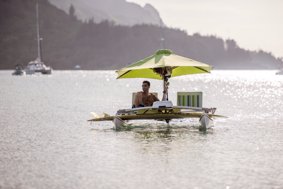

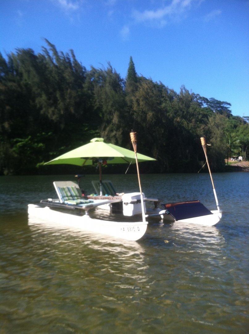

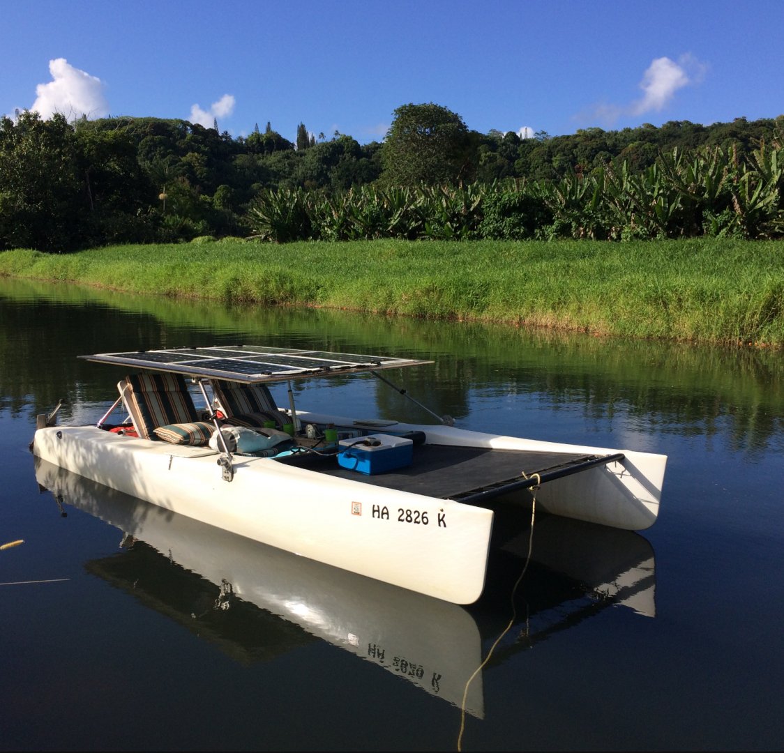

    Thanks. That was a fun build. Some of the design elements from that one, like the Ipe center console stringer which splits the trampoline in half and the HDPE plastic folding table seat backs, made their way into my current conversion SolGato.
    Based on a rotomolded Getaway, SolGato features dual 1.5kW brushless motors, 600W of solar, and a LiFePo4 battery bank.
    I’ve also designed a Crab Claw flying Lateen rig for it as well.
    3FFB1752-8404-4049-899B-F36E40394FC8.jpeg FD120979-0ADC-469B-9B9F-6B4D5809C141.jpeg
