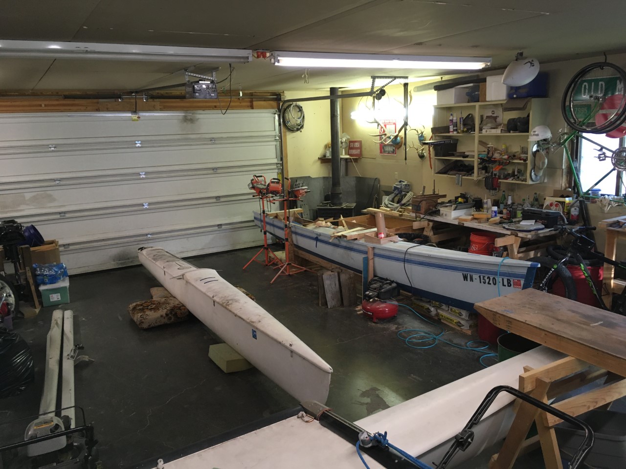

    Well the Solcat 18 starboard hull is in the shed along with the 10' beams (to the left on the floor). Before I go berserk, I may as well ask some questions.
    1. Beam overall: The picture shows a mock up of 7' (center to center). This would give me an overall beam of 14'6" or so (14' center to center of ama). 18' tri with a 14' beam ?? Sound OK ? :)
    2. Beam placement: the Solcat has 14 more inches of bow than the H18; the tramp is further towards the transom on a solcat. My current medlings on the H18 have put the front beam 3" in front of the original beam pocket. If I line up the bows, the rough beam location on the Solcat is where the parallel blue tape lines are, circled in green. You can see the rise aft leading up to the original beam pocket. That works right? no matter. I'm leaning towards hinging box beams still (a-la Waters W17). Moving the beam location on the solcat shouldn't hurt anything right? I plan on opening up the hull and installing a couple of partial bulkheads at the beam mount location to create a solid mounting surface.
    The solcat 18 length overall is actually a couple inches longer than the H18 center hull. Is that a problem? If my amas are slightly longer than the vacca?? This was part of my reasoning behind whacking some off the solcat transom, shortening the floats.
    As it is now: amas, vaca same length= approx 18'
    Beam 14'
    Thoughts?
    Thanks folks!

    Hi Big fork, the beam width looks fine to me and the folding mechanism idea, I don't think the amas/floats being the same length is an issue,. it would be better to have the 3 hulls bows in line, having the amas back has some forward floatation and steering/turning issues, but if you had the rudders on the amas that would be less of a problem., then higher dihedral would negate that some I think.
    It's kind of hard to find your thread, that's why I think more people aren't making suggestions , some other opinions of people with more experience than me would be handy.
