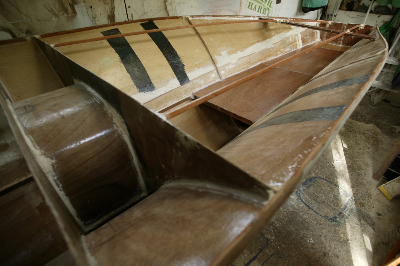

    Groucho Marx slowly coming together after almost being destroyed.

    Gary
    Could you please tell us some details about SJ hull (which I think is Groucho main hull). Was it tortured ply, did it have glass on the outside etc. Multihull Structure Thoughts thread is trying to build up a knowledge base of multi structures to use as a reference guide for others.

    Frog (see photographs) was built the same way as Supplejack but of thinner 3mm ply; SJ was 4 or 4.5, I've forgotten. The Gougeons' Adagio was 6mm I believe and that must have been very difficult to bend/tension/torture. On Frog and SJ outside was glassed and some high load areas inside too plus some areas in carbon on Frog. In late 1970s building the cat we didn't know about carbon, or we did but couldn't obtain it. However we used uni directional glass tows for chainplates; that was radical in those days, no metal. Old guard made faces but we have never had any breakage problems.

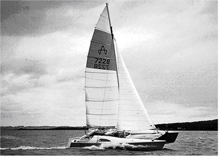

    Excalibur was David Knaggs Great Barrier Express design, one of the earliest Tennant GBEs. Here's a shot I took from Supplejack.
