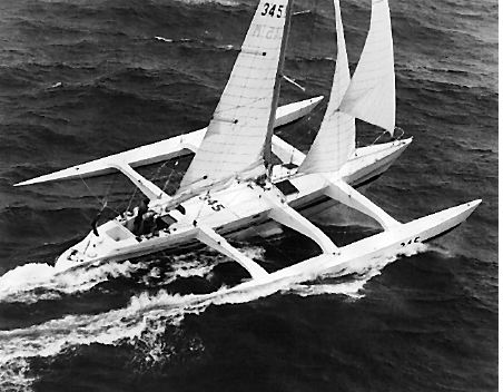

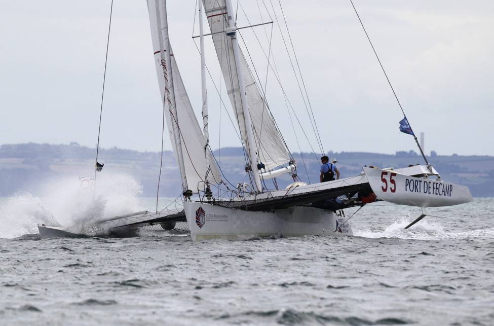

    Richard you're welcome. I've worked a few years in the field as an "outsider" consultant when racing multis were plagued by structural problems and had a tendency to disintegrate in bad sea, or at least being crippled by local failures. My main job was pretty far from multis...
    The present multis are the result of a collective work that lasted more than 35 years. Everybody added his stone, and the failures gave a deep understanding of the involved factors.
    Thanks to the success of multis racing in France and its returns in advertising, a lot of money have been poured by the sponsors. That permitted a professional and scientific approach of multihull design, with experienced NA, able consultants and excellent shipyards, so good that I know at least three working also for the aerospace industry with very stringent norms. You can imagine the quality of the boats they build. It's a synergy.
    The Crowther story is a very sad one. I have been said that the first original one built by the shipyard was not at the performance level of the competition designed by French NA. The shipyard had to modify heavily the following ones and that did not solve all the shortcomings. I agree that the shipyard was not "ethic" at all keeping the name of Crowther even if the boat was very modified by not paying the fees or reaching an agreement...
    The good boat is the boat that fills your own requisites. It's a very personal choice. You have to be able to know what you want, what is needed to get the desired results and finally to know if you can afford it...Any decision is respectable if there are not internal contradictions.
    In the good conditions some "vintage" are roadrunners. In the small sizes good fast boats have been designed very soon as the structural and weight problems are "easily" solved with cheap solutions. They are designed for light weather, not to affront oceans and storms. The thing becomes more and more difficult after 30 feet. For example aluminium beams have no use on bigger boats because of fatigue and corrosion, on a 25-30 feet multi it's a very good solution.
    Five years ago I was asked to repair a crack on a front aluminium beam (round tube) of a 60 feet catamaran used for charter, a big Tornado. The boat was only 5 years old and made 3 very quiet Atlantic crossings. I told to the owner the beam had to be changed, and probably the rear one also...He didn't believed me, so I made 4 magnaflux tests on the upper sides that revealed the myriad of microscopic cracks in the zones of fixation with the hulls. Very bad day for the poor owner, I was so sad for him that I "forgot" my fee...
    Fatigue of the metal. The beams were discretely losing their strength until the failure...A fourth Atlantic crossing, some bad sea and the cata falls apart. Using aluminium tubes as beams on a big multi is an engineering sin. But you can make a good aluminium multi if above 13 meters, the proof is Pir2, a 15.24 m 1983 trimaran foiler by Sylvestre Langevin, bullet proof, decent weight 4500 kg, it would make a good fast cruising boat nowadays with some mods to improve the amenities, after all it made the Route du Rhum 2014 in the honourable time of 18 days skipped by its amateur owner, a 58 years old car mechanic. But Langevin is a master engineer of metallic structures...
    Skyp, I'm not good in psychology but I have learnt something from my experience working in teams; a fresh sight of an "educated outsider" is needed in every big project if possible. Even naive questions may reveal sometimes that something was flawed. When you have to work in a closed team for questions of secrecy, you must be very critical about the design choices and the picked solutions; failure is very close to success. Overconfidence is a killer in a lot of fields, but over-doubting paralyses. And when exploring a new field, you need luck, a lot of luck...Same for choosing a boat.
    Coming back to multihull design, I do not disrespect the Ancients, some did a very good job when you consider that multis were terra incognita. A lot made very deeply flawed designs now forgotten. But all these designs are obsolete and this fact must be taken in account. That does not mean they are intrinsically bad, that means simply that the security margins, the speed capacity are not the same, and the boat has to be used accordingly. And not to make impossible claims, maybe they be were winners, now they are vintages. You can win a local regatta, but no hope in front of a serious opposition as you can find in England or France.
    The Alpine 110 is a fantastic car, it was the rally world champion in 1973 but nowadays it is nothing in a serious rally competition in front of a Citroen. Obsolete...If you want one, you have to take as it is; a not so fast vintage with serious flaws of safety for the pilot and co pilot. In racing and sport motorcycles it's the same, 40 years ago the Tourist Trophy record of a lap were around 160-170 kmh, now it's 214 kmh...
    The same for boats...A 1987 a top notch F40 catamaran had a top speed of 27-28 knots, a 2005 40 feet catamaran designed by Loday 40 knots 30% better...
    The 60 feet Rogue Wave by Newick made the Route du Rhum 1978 in 23 days 15 hours. In 2002 the 60 feet Geant in 13 days 7 hours. In 2014 Fenetre A, only 50 feet in 11 days 5 hours, half the time of Rogue Wave, 100% faster...no need of comment.
    That do not take off an ounce of their historical interest, their beauty nor pleasure of sailing. I love old multis when they were the state of art of a period.

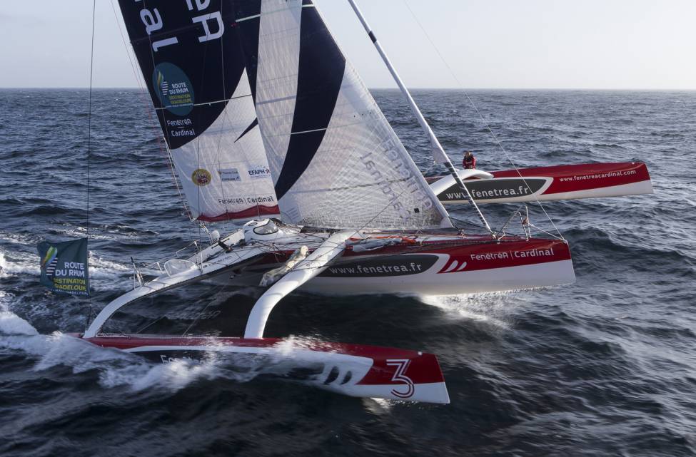

    Pics added: FenetreA a modern 50 feet twice faster that Rogue Wave. The bullet proof 32 years old foiler PIR2 (considered as patrimonial historical interest by the French authorities) and its athletic "young" skipper...
    Last pic; Brittanny Ferries GB 1982 by Shuttleworth. The perfect illustration of lack of volume of rear of the ama with insufficient diagonal stability ; the rear is sunk and the attitude of the boat is not appalling.
