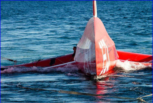

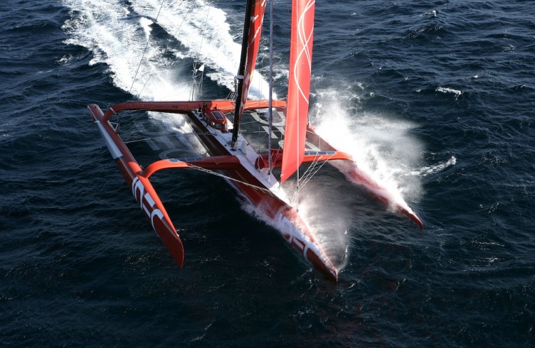

    About diagonal (and longitudinal) stability. A lot of people, beginning by Mr Woods, have given answers;
    1- On the flats decks that are a death trap when submerged with a negative angle. The brake is enormous, the boat is stopped in seconds and the real wind catch the sails. No way to save the situation, it's too fast. Jet Services 5 capsized dramatically with several people injured, the maxi cat Royale suffered of a similar situation and the skipper disappeared in sea, too many accidents occurred. It appeared that rising the bows and flares was not the solution.
    Add not enough volumes in the amas and you pass in 2 seconds from an exhilarating run to a capsized boat with a broken mast, and people maybe trapped under the trampolines.
    2- Rear diagonal stability. As Mr Woods said with rear pointy amas in a storm if you are stopped and begin to go backwards you are in a very perilous situation. Add not enough general volume of the amas and too much rocker. A good wave coming from behind and breaking on a ama's rear flat deck and you're capsized with no hope.
    3- Longitudinal stability. As the pressure of the sails rises, the ama is taking more and more loads both static and dynamic. In statics it's simple the volume of the ama has to be equal to the displacement. That was the big mistake in NA at the beginning of the multis. They did not analyse the dynamic part, a boat moves and the interactions grow exponentially with the speed.
    It's the dynamic part which is tricky combined with the hydrodynamics. One goes with the other.
    A- acceleration, the apparent wind goes forward and speeds up, the multi sits on the sterns. If you have not enough volumes the sterns sink and drag badly.
    B- sudden deceleration. It's the most dangerous phase. The multi goes on the bows, the apparent wind goes backwards and will catch the sails, pushing forward. If you have a gennaker you're in a big trouble.
    If the bows cannot clear the water, and act like hydrodynamic brakes you're f....d. It will engage in green water in seconds. It's the classical forward capsize. That's the problem with flat decks and flares; whatever the height of the bows, one day they will go into green solid water...So the purpose of rounded decks is to no create an hydrodynamic brake and that works pretty well.
    C- constant speed: you must get an acceptable longitudinal horizontal attitude whatever the direction of the wind, but also you must have a stable system able to counteract automatically the external perturbations (waves and variations of wind) in a very short delay, without over-reacting, and as any "pendulum" system must return to an equilibrium state in a minimal number of cycles, not wobbling half a minute like a 1960 Cadillac.
    The Hobie 16 was the perfect illustration of what not to do; low volume, small sterns, flat decks, too much rocker. This cata(strophe) wobbles and capsizes in any direction like a (bad) dream; front, back, side. It's funny on a beach cat, it's unacceptable on a cruising or racing multi. Many historic multis had more or less that defect.
    The mathematical analysis is rather difficult as it has to integrate many and many factors. There are simplifications that give good predictions for some narrow ranges of speeds, wind and wave systems.

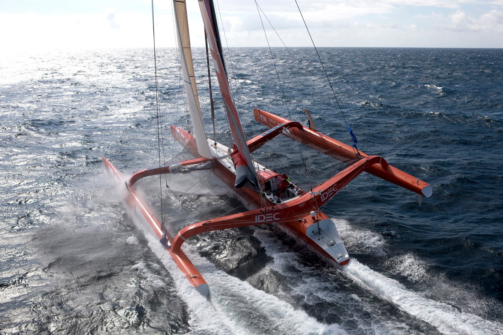

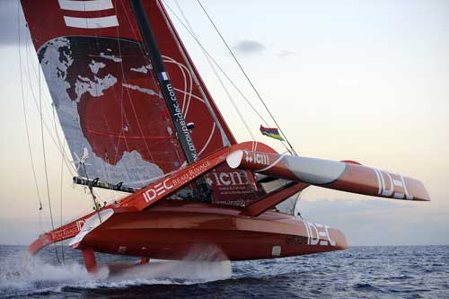

    Happily the French built a lot of racing multis, with a very fast evolution the new generation correcting the defects of the former generation and we can say that since 2000-2005 the obtained results has been excellent. All the records show it; relatively safe, faster in instant speed and far faster in mean speed over long periods. Bursts of speed mean nothing in cruising or racing, the true goal is to get a fast constant speed in a wide range of conditions.
    We can note that the shapes have gone to very simple ones, and that the riggings and masts are very similar and rather simple. All look a bit the same...This shows that the engineering and techniques are mature and that the new way are the "flying" multis.
    The application of the racing "recipes" on the shapes of cruising boats is a factor of increased security. Like the disk brakes over the drum brakes, or independent suspensions over rigid axles 1850 chariot with spring leafs suspensions.

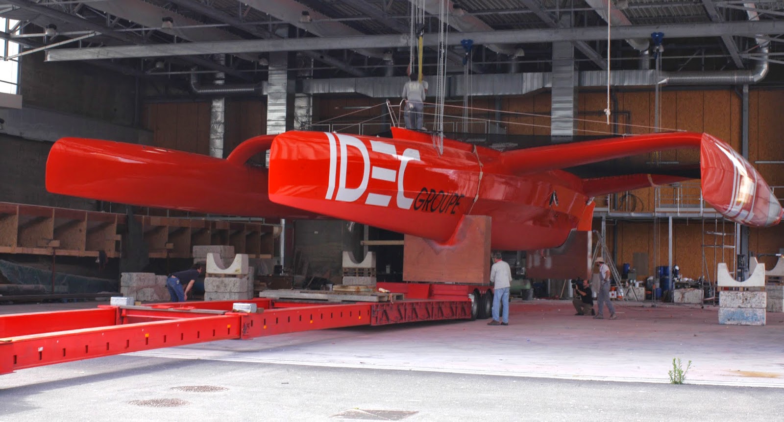

    The IDEC philosophy is one interesting path for a cruising boat. I'm repeating myself but Joyon, 51 years old at the time, crushed to 57 days the record around the world (and the record stands always), with a very simple tri. Big but simple and built of a tight budget. The secret is in the shapes of the hulls and the placement of the rig. That can be used virtually on any tri above 40 feet.
    For those who say that all this is useless on a narrow cruising multi, I'll answer why to bother to build a complicated and expensive multi, sacrificing amenities, while you can get a similar result for the same price with a bigger and more spacious monohull? A monohull is simpler to design and build. If we go to multis it's to get speed, fun and if capsized to stay alive in the inverted hulls rather than sinking upright, and trying to survive in a small rubber thing...
    A few pics of IDEC to have an idea of what is a modern multi with a good repartition of the volumes and placement of the rig. Further the spectacular side, these pics give tons of information if you have the eye. Note on the second and the last pic the impeccable attitude of the ama while the sea is not so flat, with and without lifting daggerboards. You have even the main section very typical of Irens, while capsized in 2011. Note that the inverted hull is high and "dry", with batteries, radio, water and food...Not the best five stars comfort, but far better than being the *** in the water, sea sick, in a rubber inflatable with 2 litres of water, 500 gr of biscuits, and a dying small battery on a VHS.
    I hope that long post will be instructive.
