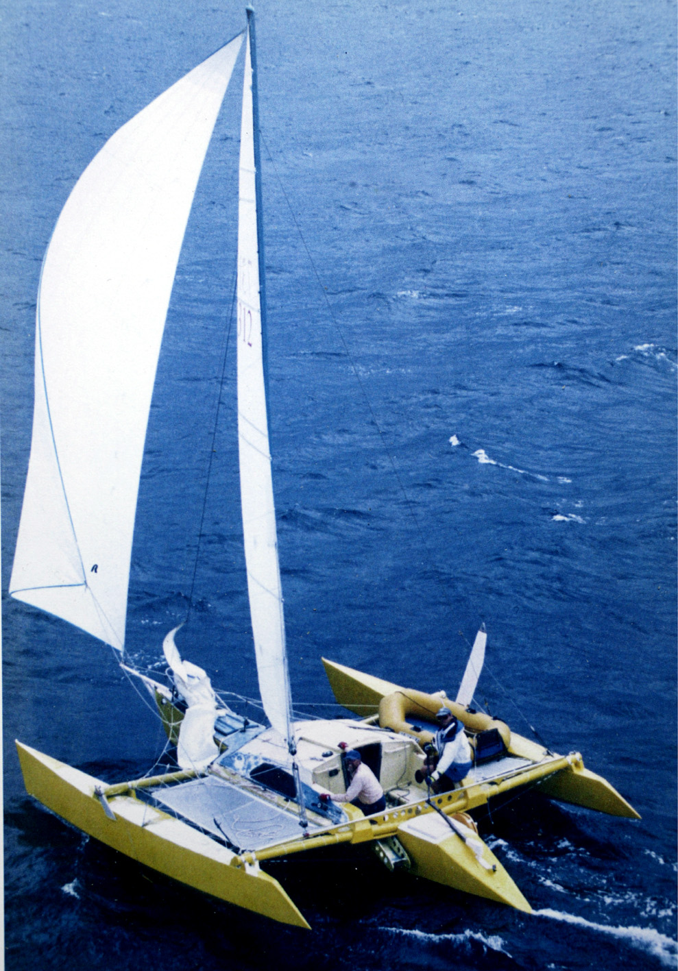

    A B24 I doubt is faster than the 28 or 33 - but it is certainly a high end performance design for its time, and its size and even today. We altered B24 Miranda, angled float foils, no main hull dagger, longer stern floats - but very pointed, lengthened main hull in stern sections, reduced the rocker, (most important) new rudder, rotating small foil mast, changed rig to 7/8ths - so it was definitely a more performance version than stock - also was kept light (but haven't got figures), floated high.
    That boat has sailed many miles and the only time we ever looked to be getting into trouble was when close reaching two handed with shy spinnaker, the halyard jammer let go and the kite flew out to leeard but remained sheeted ... so the boat reared up, buried lee float, lifted main hull out until sheet was eased and halyard cranked back in. I thought we had reached the point of no return but really, although we pulled the right strings, the B24 saved its own self. Buoyant floats, light weight and lifting angled foil would also have contributed.
    Check out the clean wake.

    Thats a wonderful picture of a "tweaked" B24. :cool:
    Note how the bows are extended at deck level, and the sterns at water level, giving the benefits of extra float length without excessive increase in weight.

    Any vid of this pimped boat ? :) Looks from distance beautifully...

    I should mention that a couple 35' Nicol Wanderers capsized. They had short floats but went over sideways in big wind, unattention scenarios. The Wanderer then got the longer Vagabond/ Cavalier style amas. The only thing I'd do to mine is similar to the Bucc Gary showed and add a stern ama stem extension instead of the small transoms for less immersed drag.
