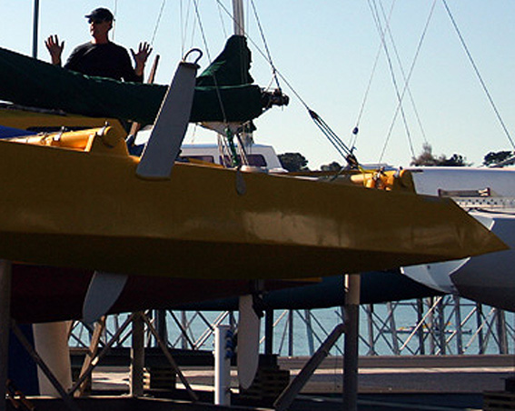

    By the way, when we lost steering on the Crowther Buccaneer 24 (B24 for short, not a plodding J24) we would have been doing over 20 knots in heavy gusting and cold (in New Zealand) southerly winds - because we averaged over 15 knots for over an hour period ... so when rudder was over ventilated, working in completely aerated water (because the B24 rudder was transom hung and the main hull had exaggerated rocker profile) there was no solid water for the blade to work in. Even the Tennant cats have considerable rocker in the after section profile of the hulls, a steep upwards turn aft of amidships - and that plus the air sucking transom rudder design - is maybe doing the same thing that we experienced on the stock B24?
    Here's the new and underhung rudder shape and size.

    The Bucc 24 plans come with an alternate underhung rudder.
    The Bucc28 comes as standard with an underhung rudder and believe me, we experienced wild high speed broaches when a big gust hit.
    As Gary said we had to rapidly push the tiller away to re-establish the lamina flow over the rudder. The AYRS has an excellent book, which is the bible on rudder design. Still available for a modest sum :D http://www.ayrs.org./ayrslist.htm. List # seventy nine.
