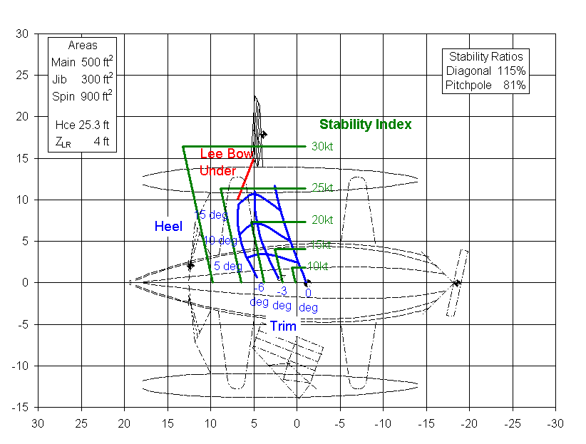

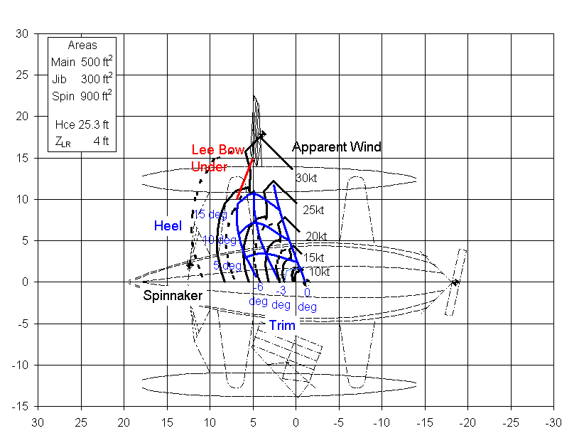

  15. tspeer
    Joined: Feb 2002
    Posts: 2,317
    tspeer Senior Member
    Here are some papers that describe different design philosophies for determining the shape of trimaran hulls. Note that design of the topsides can be almost as important to performance as design of the underwater shape. Antrim selected wide, elliptical sections for the aft end of his ama, not so much for planing, but for reducing windage of the windward hull. Both Shuttleworth and Antrim cover the change in total wetted area with righting moment for trimarans compared to catamarans.
    Shuttleworth and Antrim both talk about the fore-aft shift in buoyancy as the righting moment changes. Shuttleworth's stability indices can be converted to a footprint plot that shows the importance of providing reserve buoyancy forward in the ama to prevent diagonal capsize/pitchpole. From the looks of the drawing above, I'd say the amas are way too far back - their center of buoyancy needs to be ahead of the center of gravity by an amount that depends on the L/D of the rig.
    Shuttleworth, John, "Reflections on the Design of Brittany Ferries GB", Jan. 1982.
    Shuttleworth, John, "Multihull Design For Heavy Weather", Heavy Weather Sailing 4th Edition, International Marine, Camden, Maine, 1992.
    Shuttleworth, John, "Beyond the Tektron 50 - the design of the new Dogstar 50", Mar. 2002.
    Antrim, James K., "Design of a 40 ft Multihull for Offshore Racing," Marine Technology, Vol 27, No. 5, Sept. 1990, pp 285-299. (Available on SNAME Small Craft CD)
