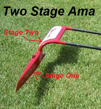

    Uses Two-Stage Amas-see attachments below. They consist of a planing ama hull(Stage One) coupled to a "curved piece"(Stage Two) that provides extra buoyancy in the event of a knockdown. Curved piece facilitates high dihedral crossarms which keep the crossarms clear of the water.

    3) the first trimaran in history to use Two Stage Amas.(see below for Two-Stage Ama pictures)

    two technical additions to the prototype:
    1) already added to the last revision of the "advantages" of the boat above under #12(post 2825)--
    12- Planing ama hulls designed for incidental contact with water at speed and for inadvertent contact at slow speed.
    Adjustable angle of incidence of planing surface of each ama simultaneously. Angle of incidence of ama foil has to be changed when this is done. Planing surface starts at +4 degrees.
    2)
    crossarm dihedral will be adjustable on the prototype to allow the angle to be refined during extensive testing. Dihedral is critical in this design because it allows the UptiP ama foils to remain down w/o having to be retracted each tack or gybe as is required on every other boat that utilizes UptiP foils. The boat will be sailed at approximately a 10 degree angle of heel to facilitate this.
    Further, the dihedral angle helps raise the center of buoyancy of the "curved" piece to make it very difficult to capsize the boat while allowing self-righting from a 90 degree knockdown. The effect of the high dihedral angle on the combined center of buoyancy of the ama planing hull +curved piece also acts to help recover from a pitchpole.
    curved piece:
