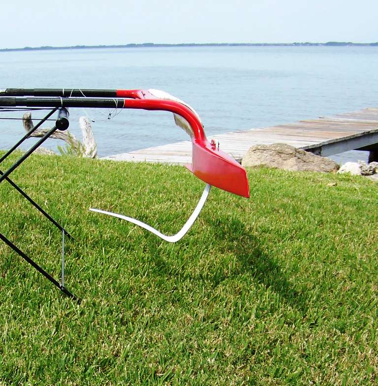

    Doug Lord Flight Ready
    WOLF---daughter of fire arrow / Specs
    Updated 2/1/17 specs and notes:
    LOA 15.458' (4.7m)
    Beam max-18.3' (5.58m)

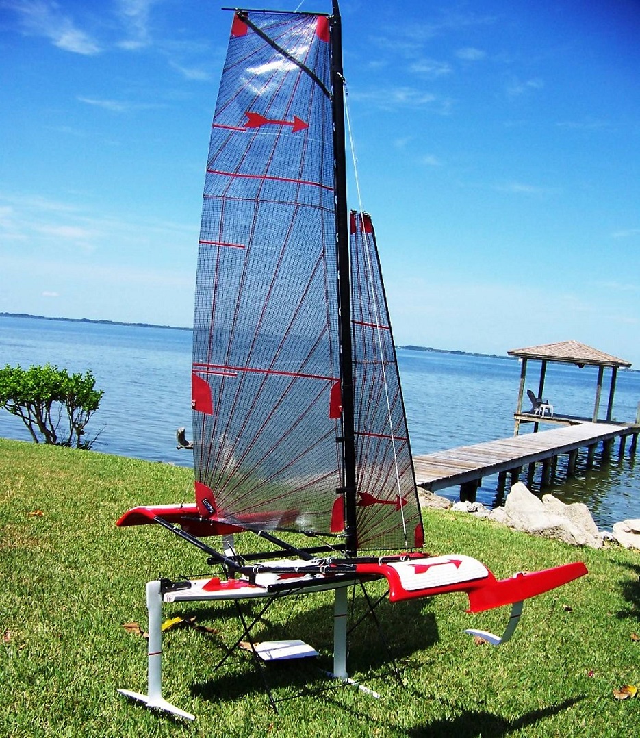

  3. Doug Lord
    Posts: 16,678
    Location: Cocoa, Florida
    Well, the main hull and two-stage amas have been filled and rough sanded. A few more days and the concept model will be assembled. This along with the Fire Arrow Test Model will be a couple of the "tools" I'll use to get the WOLF project off the ground.

  4. Doug Lord
    Posts: 16,678
    I've filled and sanded the boat and will Duratec it then wet sand. At that point, the crossarms will be assembled to the two stage ama's and then to the main hull. Next will be installing the seats and possibly some aero fairings.
    I still have to finish the wing mast and make and install the foils and sails.
    There is the rudder T-foil, Daggerboard T-foil and an UptiP foil for each ama hull.
