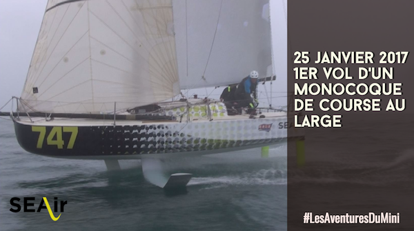

  14. Doug Lord
    Posts: 16,678
    Location: Cocoa, Florida
    Doug Lord Flight Ready
    Thanks, Tom. I posted a couple of things about it in the "New Monohull Foilers" thread under "Sailboats". Surely is very cool! I still remember the bad old days on certain forums where I was lambasted for suggesting a monohull keelboat could foil! Thank you, Hugh Welbourn!
    It's hard these days to keep up with all the foiling development-just incredible!
    Seems almost like if it sails it can foil......
    http://www.boatdesign.net/forums/sailboats/new-monohull-foilers-2016-a-54975-3.html post 39 and others
