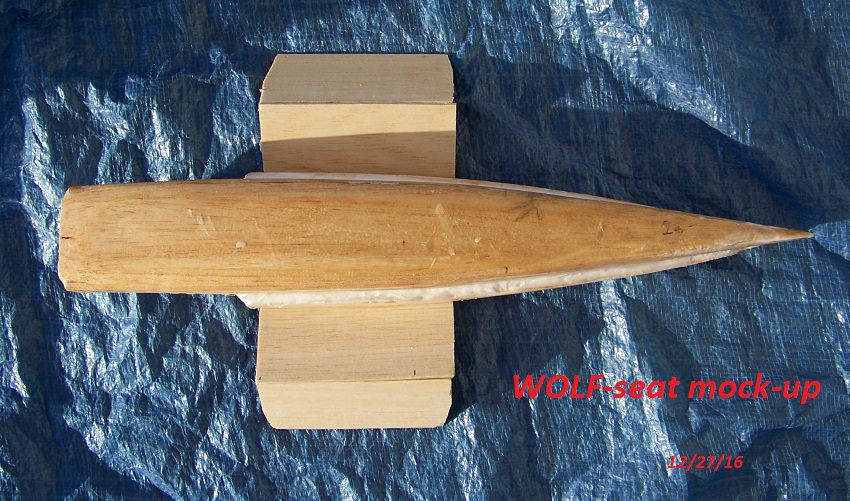

    Two pictures of the unfinished parts-not properly oriented with respect to each other--just a rough preview showing the two ama hulls, two curved pieces and the main hull:

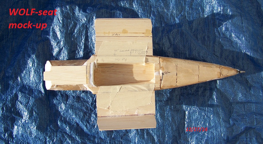

    The first priority of this new boat(should it actually get built) is that it starts to foil in a 5 knot wind. Second priority is that it is really, really comfortable. These seats will be very light, adjustable(probably) and have waterproof 3" cushions with relatively high backs.
    I've ordered Duratec and filler-the next job-as time permits- is to "cosmetisize" the model and, eventually, get it painted. Need to assemble crossarms and curved pieces to ama and then the whole assembly to the boat on each side.
    click on lower images for bigger picture:

    I'm stuck until the middle of next week on doing the finish work on the pieces already built. The company, US Composites in West Palm Beach apparently took off between December 23 and January 3 though nothing stopped them from taking my order and I missed the fine print about their holiday plans. They are the only company I've found ,so far, that carries Duratec in quart cans so thats the way it goes.
    I'd really like to increase overall beam to 17+ feet but the limiting factor is how the amas will fold-the 3" carbon tubes are plenty strong w/o waterstays.
    The wider the boat the better the ama foils work and the smaller the "Two Stage Ama" can be-within the limits of the structure and stiffness required for the foils.
    At this point the Wolf main hull will be built of foam and carbon starting with blocks of EPS foam cut as in the picture below, then glued together, shaped and carbonated. The fullsize foam blocks ,cut, is about $250......
    click for larger picture:
