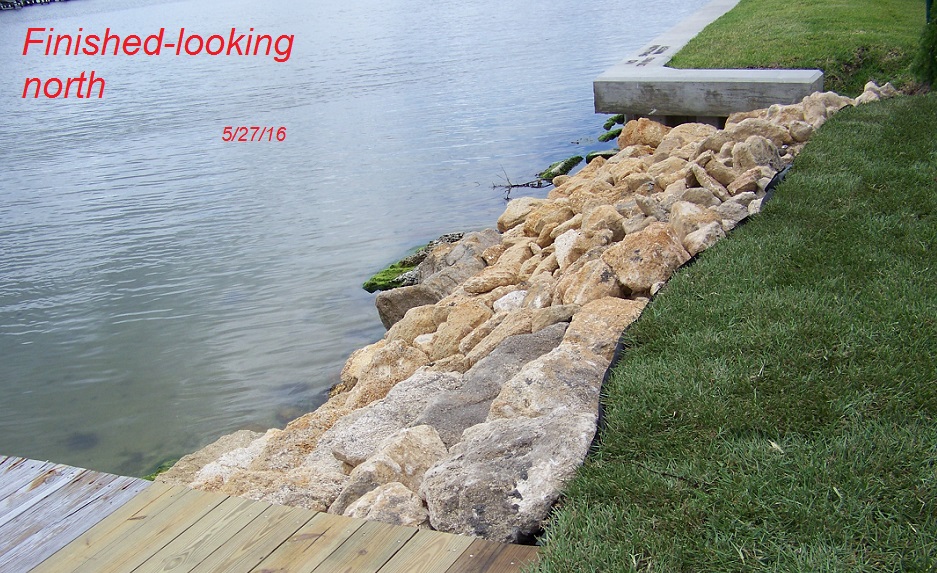

Sewall
After almost one years delay they actually started today. Supposed to take just two weeks. Theoretically (all else being equal) I should be able to launch my boats right here when they are done.
The seawall is done-a lot different than I was led to believe-and the steps are ridiculous-very, very unfortunate. The last step is a lulu: I tried to get it changed but no luck. Imagine putting a step in place already covered with grass! Just absurd. These are so bad I'm afraid they could be considered an "attractive nuisance"!
See the "before" pictures of the shore line, p154, post 2304.
click on image for best view of the finished seawall:

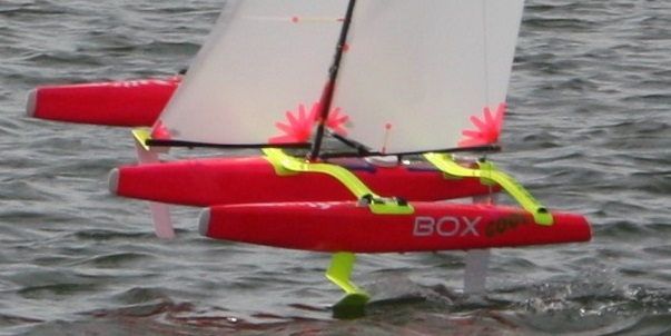

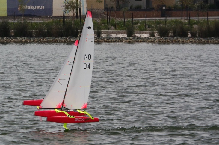

Z foils
We have made some good progress with our Z foils, and now have moulds for port and starboard. These are a definite improvement for strong winds
Video is here
https://youtu.be/Qqfh3PTWqtI
Ian

Z foils
Ian, have you two boat tested-one with the "normal" surface piercing foils and one with the "Z" foils?
Also, the MultiOne* class allows over square platforms-have you considered that?
*One meter multihull class with max beam of 48"
The steps look potentially lethal. Are you allowed to modify them by adding your own concrete (and ideally a handrail)?
Your best bet then may be to build a removable set of wooden steps that you can rest on top of the stone ones, wheeling them into place whenever you need them. Hopefully the stone steps are stable enough for that.
