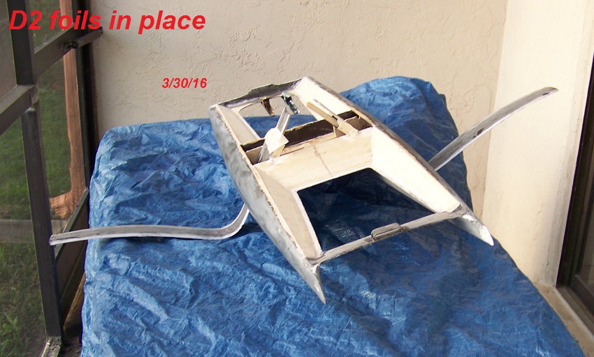

Outward pointing foils-
Thanks Corley. Jim and I have discussed this a bit on rc groups and here. His foils are just prototypes using bent flat sheet aluminum-as soon as he is satisfied with their position and area he'll build proper foils. Jim is doing a lot of experimenting with outward pointing foils. I think these foils could have applications on full size trimarans particularly under 20' where when they're retracted the beam of the tri is street legal but when they're deployed the RM of the boat is much greater. See more here: http://www.boatdesign.net/forums/hydrodynamics-aerodynamics/outward-facing-j-foils-cat-54044.html
My latest test model based on Dominion(1898-first tunnel hulled scow) uses outward pointing foils patterned(loosely) after Hugh Welbourns foils on the Quant 23. Hugh's foils (and mine) are designed to work with the boat at an angle of heel and his windward foil is retractable. To reduce the rc complexity my version is designed to sail a bit higher and at a slightly greater angle of heel to keep the windward foil clear w/o having to make it retractable by radio. The D2 is also designed to be a self-righting foiler.
D2=Dominion 2-HW.... Build Log here: http://www.rcgroups.com/forums/showthread.php?t=2434531
D2 and foils partially finished:
CLICK- Dominion 2-HW / Quant 23

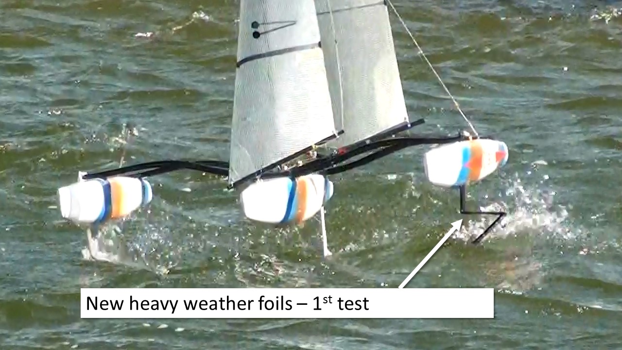

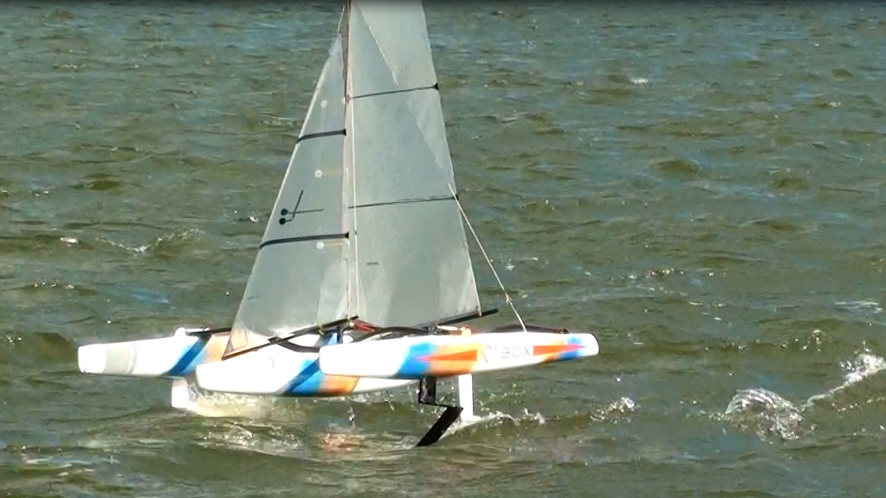

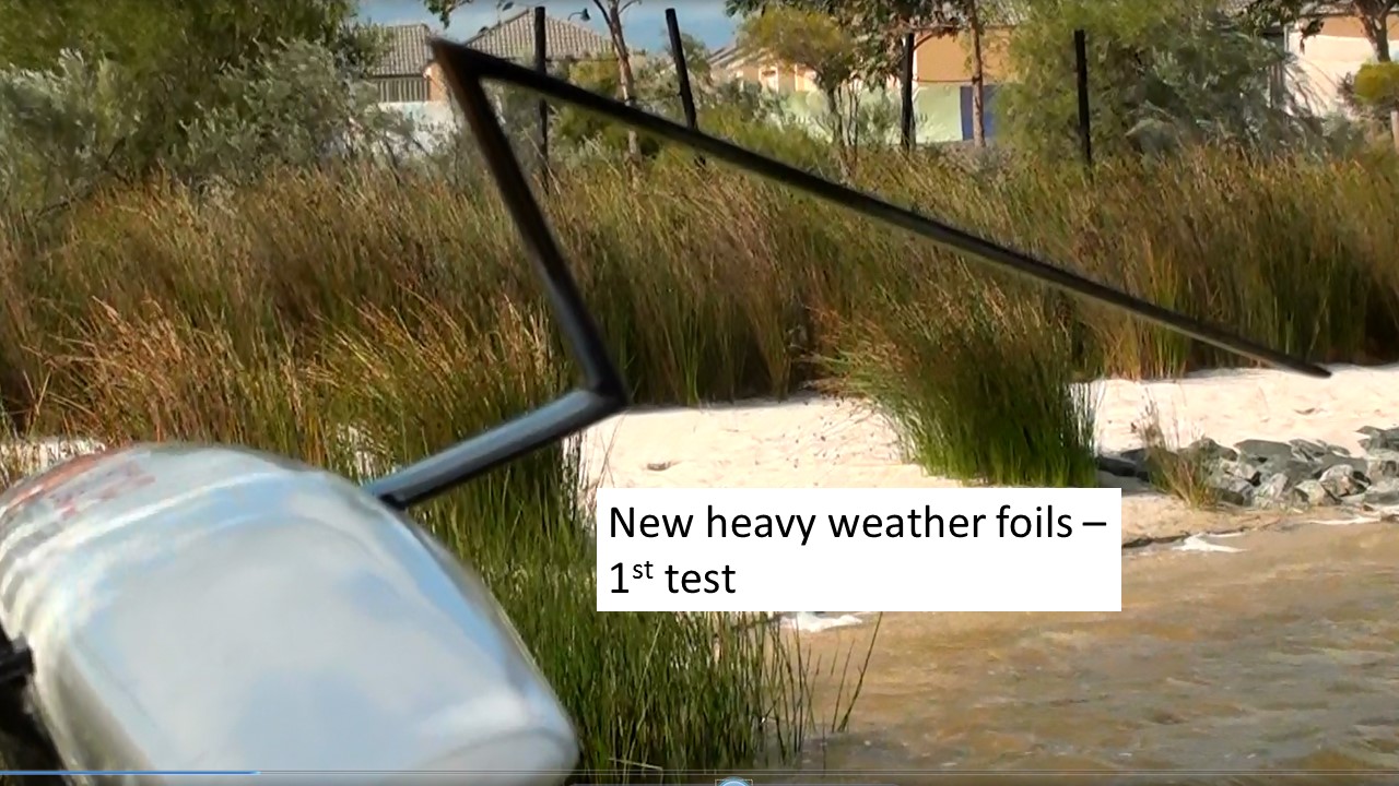

Z foils
We have made our own version of the Z foil and first trials have been promising - have a look at this video. So far we have only made the port foil mould but we'll now go ahead and make an identical mould for the starboard hull. Our "Z" has a 9.5cm horizontal outboard section before the lift section of the foil commences. It appeared to work well in the strong gusts we experienced on Saturday. The waves on the lake were large for a one metre hull length but the boat coped well
The video is here:
https://www.youtube.com/watch?v=m2Fv9dc3DjA&feature=youtu.be

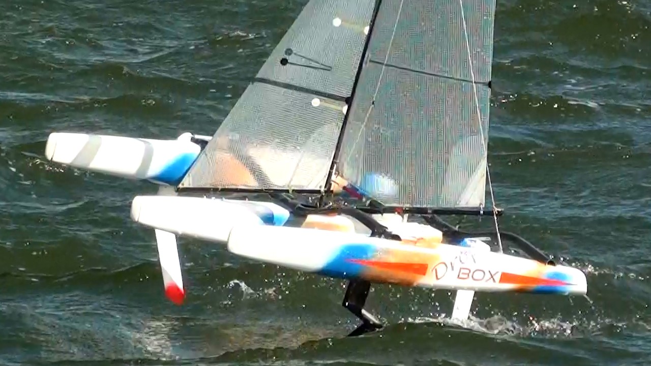

RC Foilers
Interesting, Ian! I'd think that the acute angle between the horizontal foil and lower angled foil might be draggy when the joint is in the water but it didn't seem to have much of a negative effect in those conditions. Could you make the joint with a radius?
--Just out of curiosity doesn't a foil like that take the boat out of the mini40 class? Why not go for a wider overall beam of the platform? I guess with the new foil you can gain RM and easily change foils to race in the mini40 class?
The small white trimaran is ours, built in Australai and shipped to Gerd Mentges. He won two of the races and finished 4th overall - not bad for a one metre tri racing aginst Mini40s. Apparently he also had fun foiling around at lunch time too
Sorry, correction. He came second in two of the races. I miss-read the score sheet
