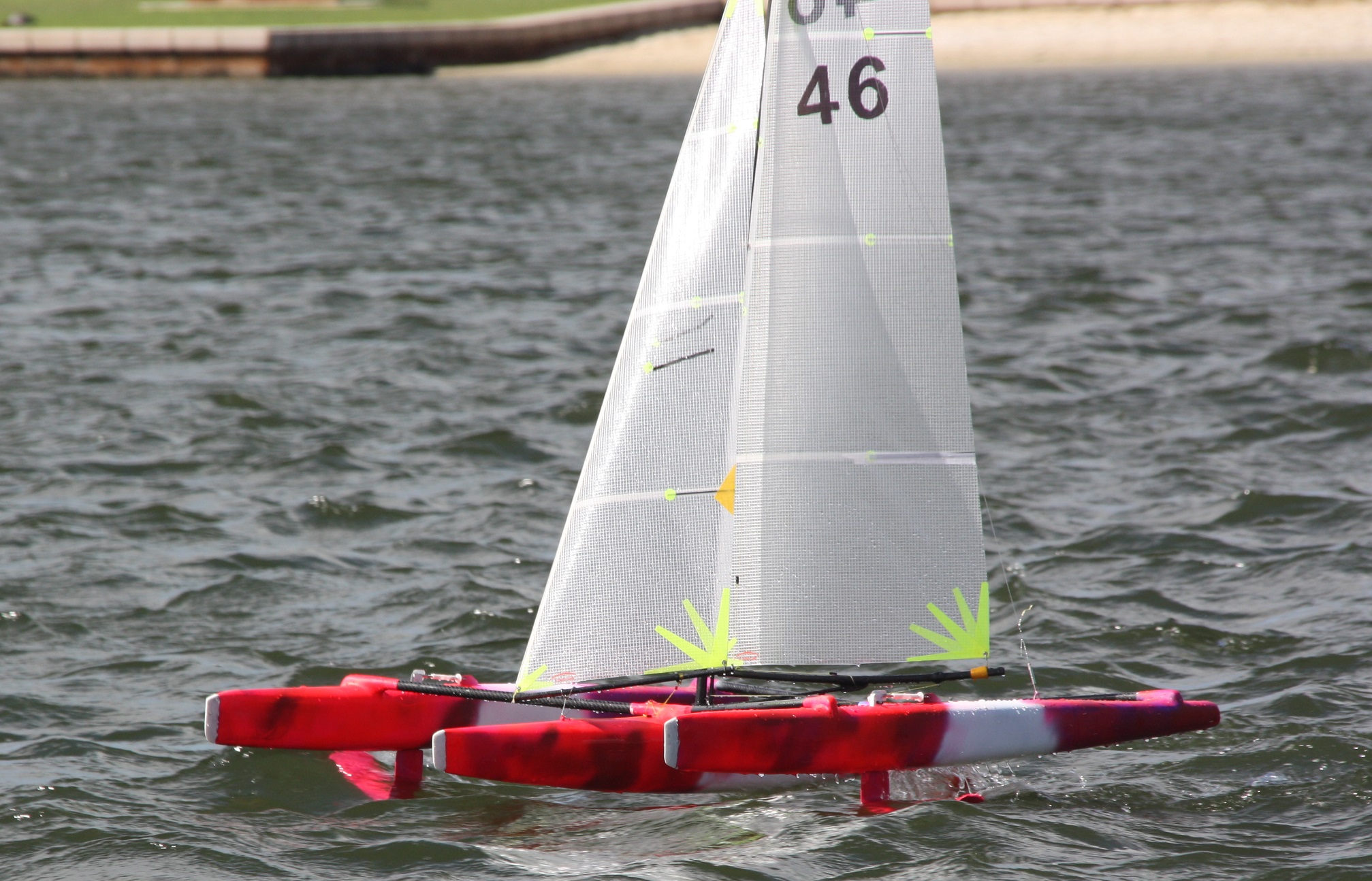

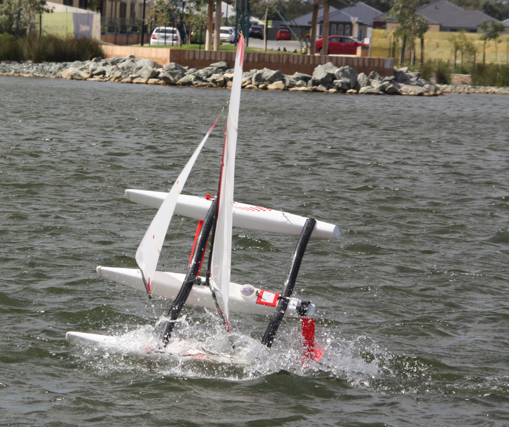

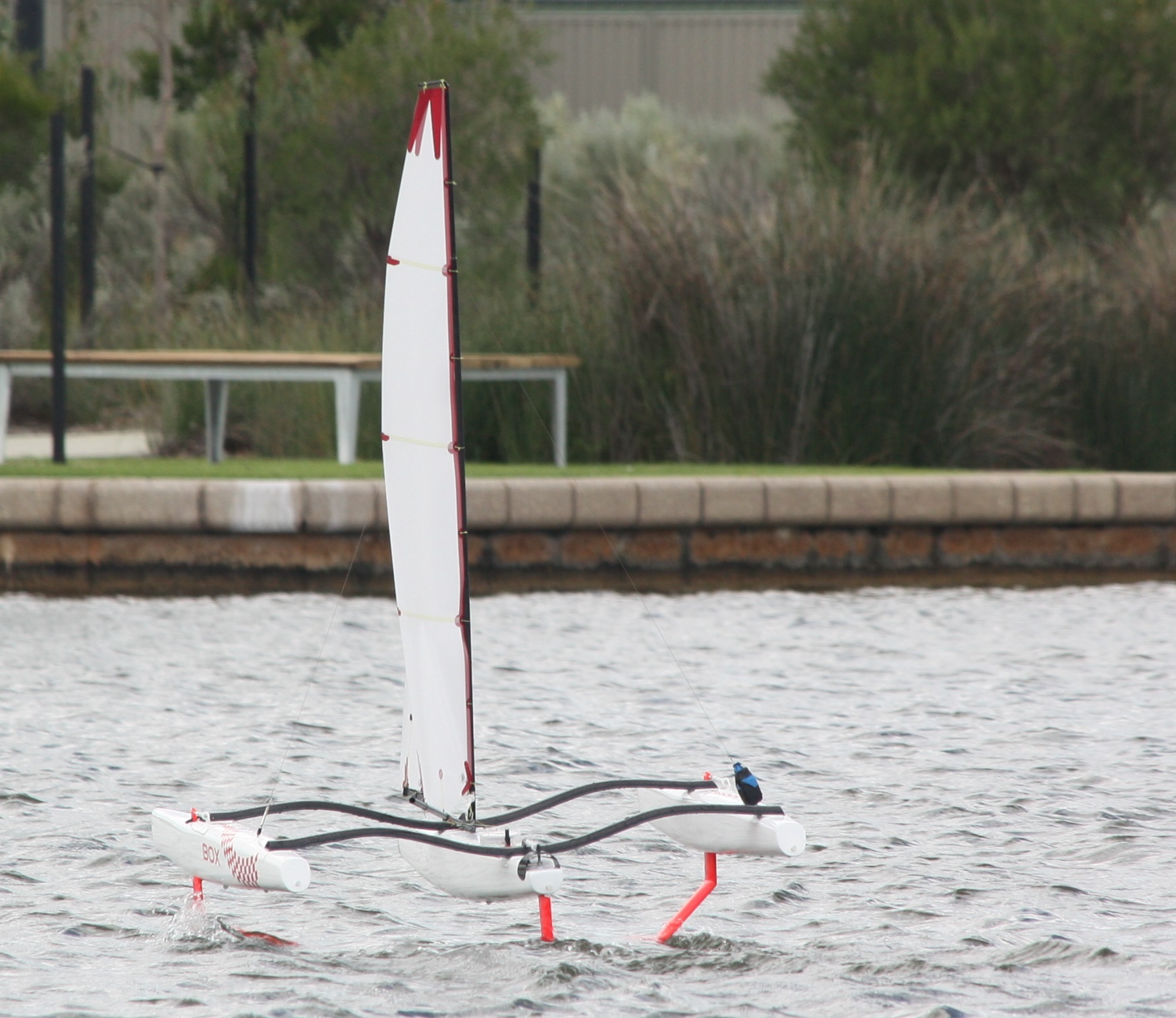

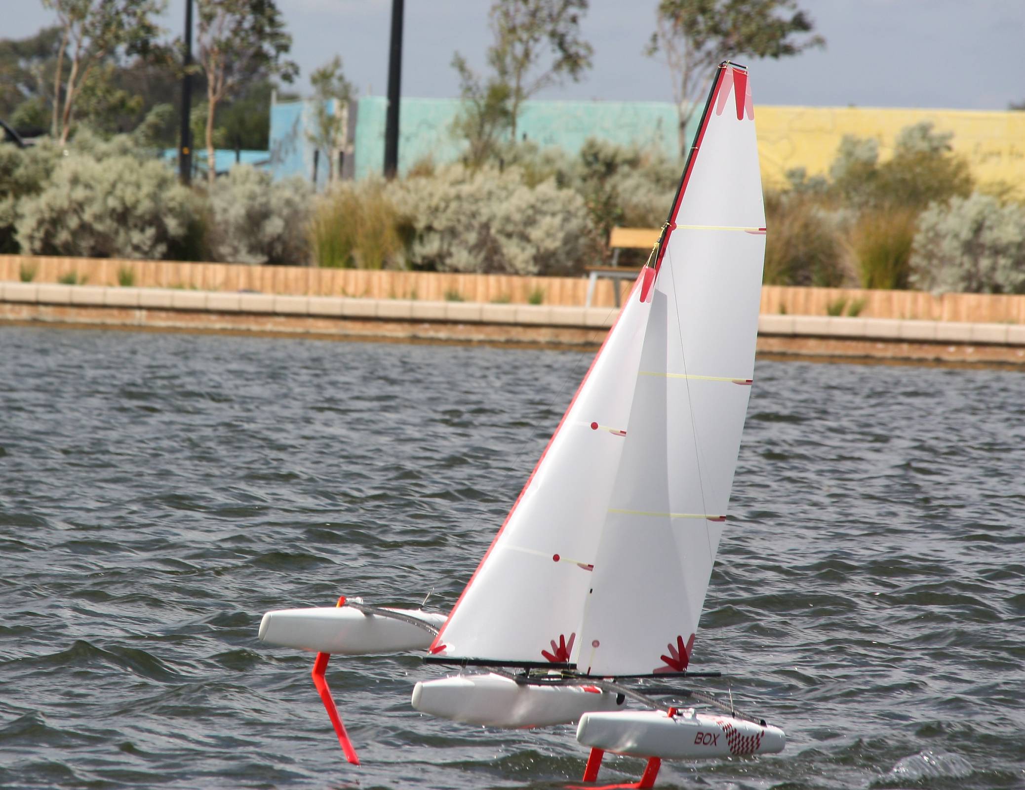

Some videos to compare Doug's foiler with one that has gone through a test and development program guided by real–world experience. PerthMini40man has worked through various foil configurations and sail plans, the result is a pretty stock looking foiler that works very well.
Turn the sound off first.
Doug video short version (1 min 51 sec): http://www.youtube.com/watch?v=7Mok3d4KiMI
Doug video long version (7 min 47 sec): http://www.youtube.com/watch?v=4YBOEolFqiE
PerthMini40man video (7 min 5 sec): http://www.youtube.com/watch?v=nzTf9pedWdE
Fred it's all been said before, the only thing that seems to matter to Doug is word count.
