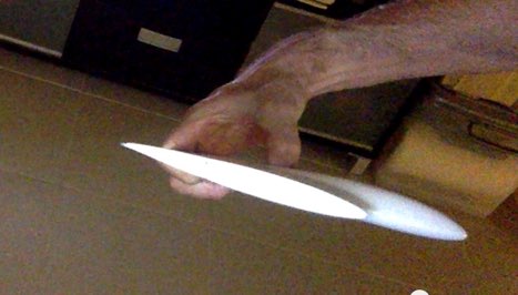

    Fire Arrow Foiling System Testing and Development
    This is a variation on the original Fire Arrow system. The only difference is that the ama foils are based on Hugh Welbourns Quant 23 foils. These foils can allow the platform to be narrower if the center of lift of the foils coincides with the center of lift of the original UptitP ama foils. The may be able to operate in shallower water than UptiP foils as well:

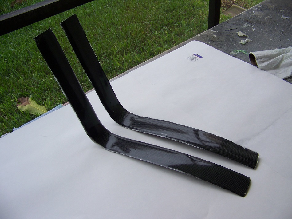

    I've already built a set of Welbourn foils for the Dominion model and I still have the quickie molds so I'm considering building a set for the Fire Arrow. They would have to be able to take twice the load of the D2.
    Problem is finding a way to install a different trunk in the Fire Arrow amas and/or building new amas-which I don't want to do at all.
    D2(Welbourn type) main foils:
    click--
