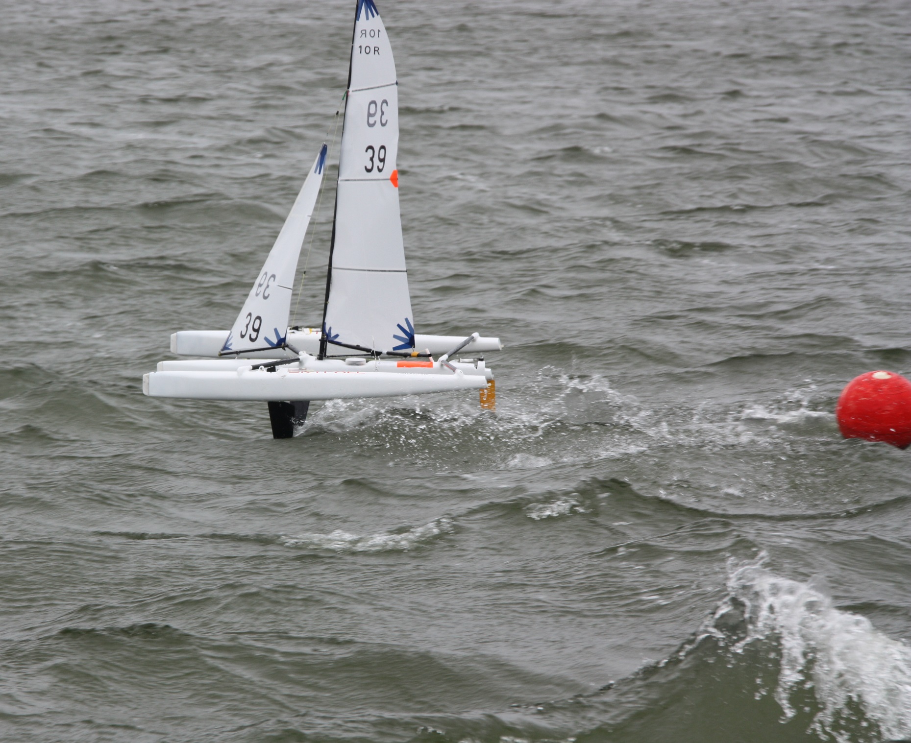

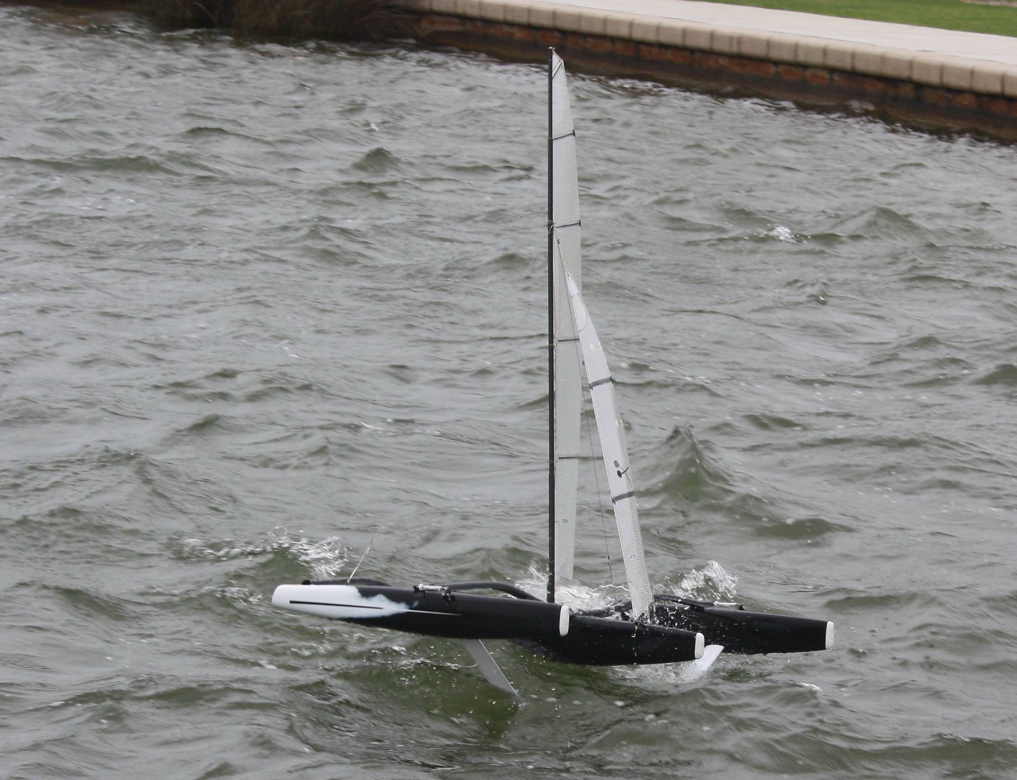

    Partially Planing Foil(s)
    Here is a shot of the fullsize Q23 illustrating its main foil partially(if not fully) planing-one of the unique characteristics of that foil design.
    The second shot is of the Fire Arrow on a reach with the ama foil partially unloaded and maybe planing:

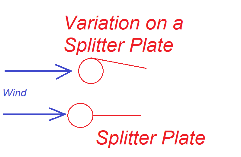

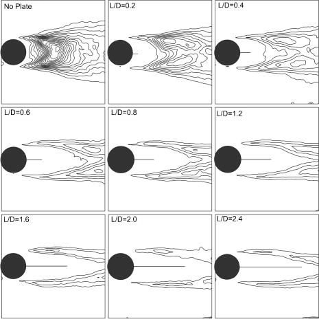

    Aero Drag Reduction of Sailboat Rigging
    Just found this posting of yours Doug while looking thru some google images. Looks like a looong subject thread.
    I'm wondering if there are more positive responses to your call for help with this drag reduction effort. On this page of the discussions it appears as though a number of respondents dismissed the problem.
    I'm interested in some simple methods to reduce the drag of the 'bare mast' of my aftmast rig. Some sort of 'flexible splitter plate' idea seems most appropriate?
  11. Doug Lord
    Posts: 16,678
    Location: Cocoa, Florida
    Doug Lord Flight Ready
    splitter plate
    Brian, I'd think the problem would be changes in the apparent wind direction that cause the flexible splitter to generate lift/drag. Maybe some way to rotate the thing?
    I'm not going to try anything until the basic testing is compete but I'm convinced it could be just as important on the model as it is on a Moth.
