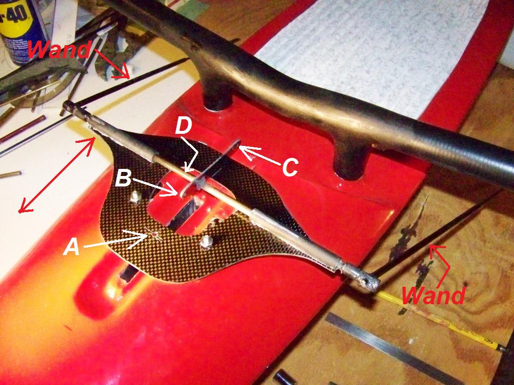

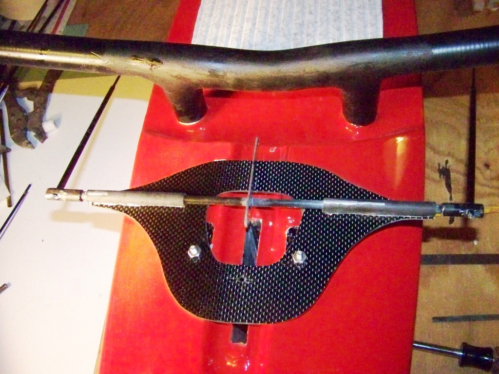

    Ian there are two rough illustrations on page 144, post 2146 showing the wand system and the one below. The wand can be set as shown(32 degrees) or even at 45 degrees for flap neutral. The rocker arm set up should be as shown. The wand system uses a 5/32" SS rod bent to take the wand. So the SS rod serves as an axle to mount the rocker arm. On the F3 there was a ss bearing on either side of the rocker arm but you could probably use brass tubes.
    You can set wand length for the flight altitude you want and even make the wand length adjustable. The nominal flight altitude should be with the main foils 2 chords below the surface. The top of the rocker arm should be attached to a spring that tends to hold the wand against the water and should be set up so that as the wand moves forward the tension on the spring increases.
    My foils used partial span flaps that were 20% of the total area. The flap can be up to 30 % of the foil area.
    The F3 was 8lb(3.64kg) of which 80%(6.4 lb/2.9kg)) was supported by the two mainfoils.
    The main foil area was 17 sq. in(109.68sq.cm), including the flap. The foil loading was .188lb per sq.in.(.013kg/sq.cm). Don't use use the same area but match the foil loading to your boats weight.(see next post) It is very important that the mainfoils lift 80% of the total weight.
    The mainfoils (flap neutral) should be set up with a +2.5 degree angle of incidence with the rudder T-foil set at zero degrees relative to the static waterline(roughly parallel to the flight waterline after takeoff).
    I used very thin mylar as a hinge with holes punched either side of the hinge line of the flap. The mylar was laminated into the foil during layup in a split mold.
    If you're using wood you could sandwich the mylar between two pieces. It's not critical that the hinge line is smooth(though it wouldn't hurt).

    To be proportionately the same as the F3:
    1) main foil loading=.013kg/sq.centimeter
    2) main foil area=129.23 sq.centimeters(20 sq.in)
    a. flap area at 20%=25.846 sq.centimeters
    b. flap area at 30%=38.77 sq.centimeters
    c. mainfoils set at +2.5 degrees
    d. foil section must be symmetrical
    3) Rudder foil=same area as one main foil or slightly larger
    a. rudder foil set at zero degrees
    Wands should be directly connected to the flap as described in previous post and shown in sketches. This will give you the maximum possible righting moment from the foils.
    You can use a rectangular planform with full span flaps if you want for the sake of simplicity but don't fudge the area.On a multihull where you are using the foils to develop all the Righting Moment for the boat it's probably not a good idea to have the point of contact of the wand with the water much,if any, ahead of the longitudinal CG of the boat. Multies that are using wands ahead of the foil like the Vampire and the Stunt 9 also use movable ballast-you don't- so keep the wand as shown for the F3.
    The F3 used the planform below with a partial span flap at 20% of total area.(see and click on picture below sketch)
    It used a nominally 9% thickness/chord ratio.
    Keep in mind: the phenomenal ability to generate righting moment will allow these foils to be very fast even though their immersed area when foiling may be greater than a surface piercer. Reducing the foil area will be a mistake because doing that reduces the ability of the foil to generate RM. Just because these foils can generate their own RM doesn't mean they can take any amount of sail in any wind-the sail area will still have to be reduced as the wind picks up-testing will tell you when and how much. I had a little pamphlet- that I can't find- that described exactly when and how much to reef the F3 sails.
    If you have any questions don't hesitate to post here or e-mail me. I'd like to help in any way I can.
