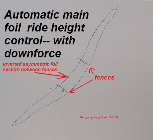

    One major element in this one of a kind configuration is the wand controlled main foil on the daggerboard ,which allows the main hull to fly in very light air.
    After the main hull fly's a unique characteristic of the main foil is that it unloads the faster the boat goes, reducing drag appreciably with the lee ama foil taking most of the load. The reserve power of the main foil is then used, with the rudder T-foil, primarily for pitch and heave control* giving much greater control and pitch authority than on a tri without the variable lift main foil.
    * maintaining a constant altitude of the main hull and the preset angle of heel of the whole boat.
    In addition, the main foil is capable of generating substantial downforce in response to gusts, which increases total RM(righting moment). This response can be controlled and limited, if desired.

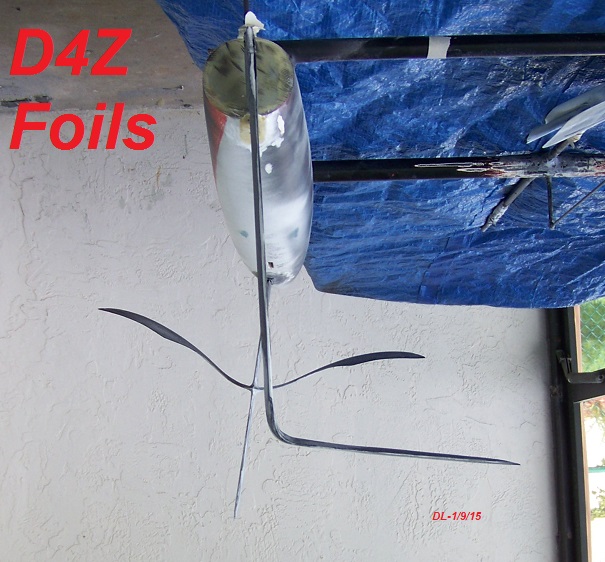

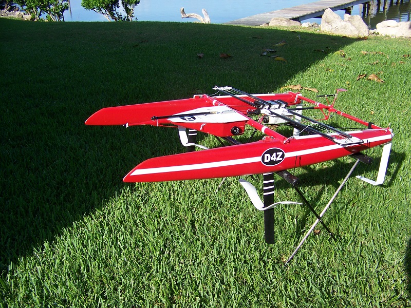

    D4Z
    Because I need help to sail and video the Fire Arrow, testing has been limited which allowed me to use some time to modify a 20 year old RC cat model to test various concepts for use on an AC 4.8RC model. The boat utilizes a "Trapeze Power Ballast System" which allows weight to be moved fore and aft and side to side very quickly. This system has been used on several different RC boats in the 90's and is well proven.
    The most experimental aspect of the initial testing of the foiling version of the D4Z are the "batfoils"-surface piercing T- foils. The batfoil is curved and twisted from zero to plus 3 degrees and has an iFlap on each end which works like the single iflap on the ama foil. It provides high lift at low speed and reduced lift(and drag) at high speed ,again, similarly to the way a wand controlled foil works but no moving parts. Further, the batfoils are canted outboard at the bottom 10 degrees which allows the windward mainfoil to clear the water at a small angle of heel.

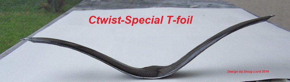

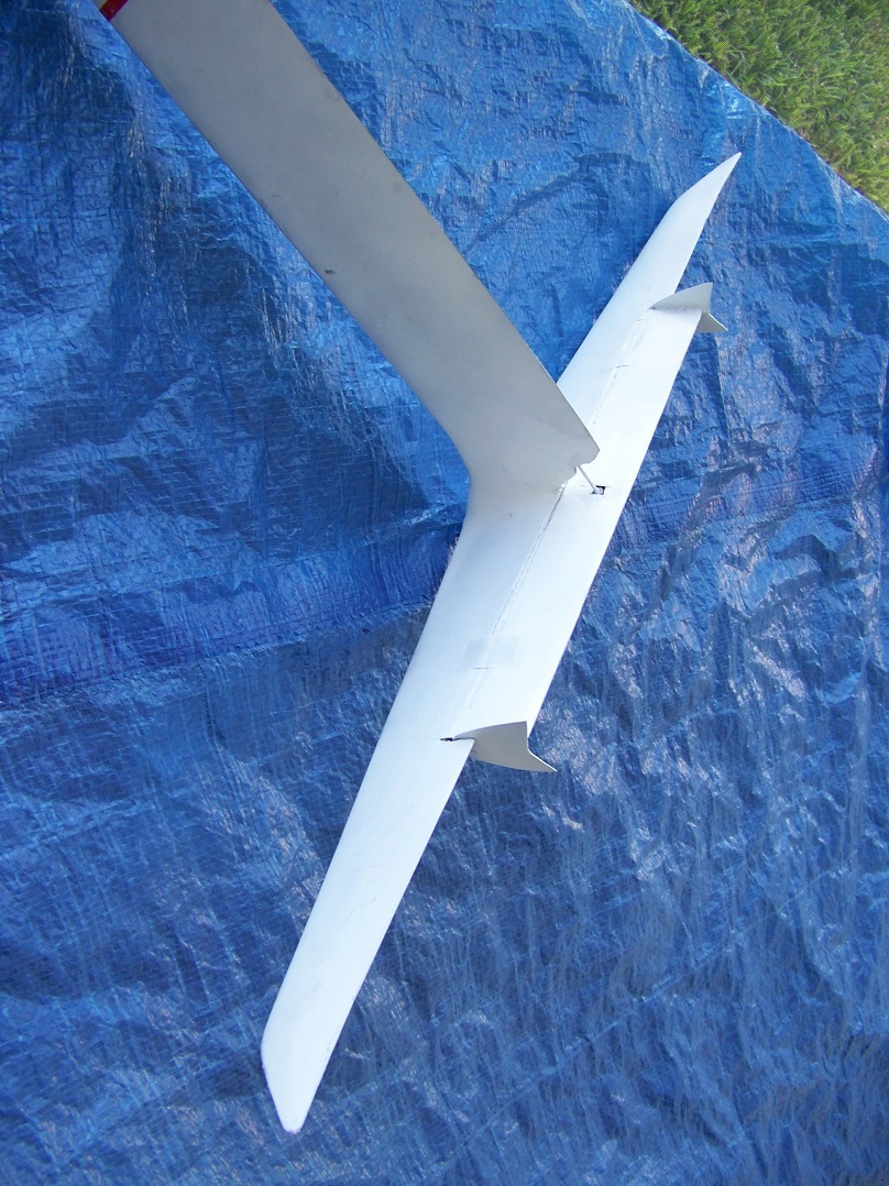

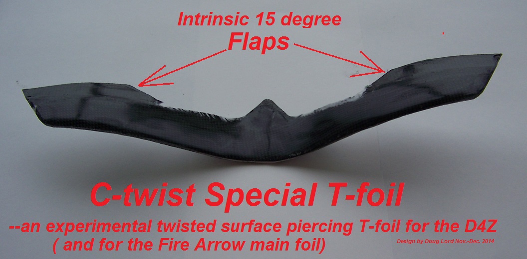

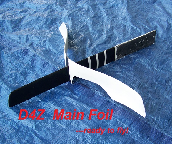

    Basically, they have the surface piercing T-foil in common because of work I did last year in trying to find a solution to getting rid of the wand controlled main foil-but only with something that would work equally as well ,but simpler. Thats a tough problem because a central advantage of the wand controlled foil is the fact that when the boat heels too far, the wand causes the foil to develop downforce ,increasing RM(righting moment) instantly in response to a gust. I did a lot of work and may have come up with a solution using an upside-down asymmetric center section that might be able to generate downforce automatically as the boat speeds up and pitches down.
    It dawned on me while working on this fairly complex theory that right in front of me was a potential lifting foil for the D4Z(minus the downforce section) that would be as simple as you can get-not requiring any servos to move or retract the windward foil(as required by UptiP foils used on an RC cat).
    And in playing with a fullsize drawing of these proposed surface piercing T-foils on the cat, I found that if the foils were canted outboard at the bottom 10 degrees, then it would take only 4 degrees of heel for the windward foil to come clear of the water. This was major because it allowed a huge reduction in drag by a small increase in heel!
    Because of the way these foils looked before they were assembled they have been nicknamed "batfoils"(by a guy on rc groups). And before I go any further these foils were inspired, to a degree, by work Mal Smith did on a surface piercing T-foil for a Laser which I always thought was really cool.
    In order to make these foils work well from the slowest speed to the fastest, along the lines of the way a wand controlled foil works, I drew again from the work on the Fire Arrow UptiP ama foils where I had devised an iFlap to create lots of lift at slow speed then have the flap ,or a portion of the flap clear the surface at speed,reducing drag.
    On the batfoils, I put an iFlap on each tip-larger in area than what will probably be required-so that they can be trimmed down in testing. In fact ,the probability is that the inboard iFlap may be completely removed from the batfoils in the course of testing. Each batfoil is set at a 3 degree angle of incidence and twisted 3 degrees from the center to the tip.
    So a search for a simpler replacement for the wand controlled main foil on the Fire Arrow led to the development of surface piercing T-foils that, while very experimental, may be a great solution for the D4Z in terms of making simple foils available for the AC 4.8 class. We'll find out before too long, I hope.

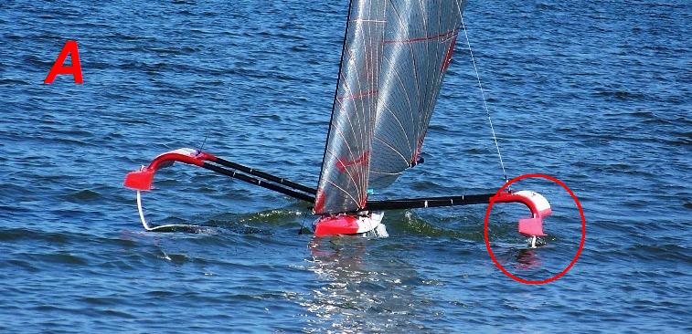

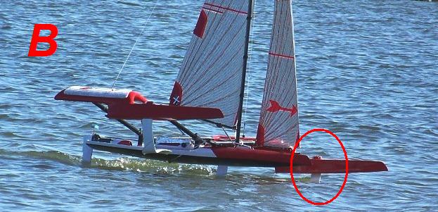

    C) This boat foiled using two completely different altitude control systems-for the first time on any size trimaran anywhere, as far as I know:
    a. The main hull uses a dual wand controlled flap equipped main foil to help the boat fly in light air and to add righting moment in stronger wind,
    b. The amas used a refined version of UptiP foils, pioneered by Team New Zealand in AC34, for the very first time on any trimaran anywhere as of July 24th 2014! My design for the Fire Arrow foils attempted to create a foil that would require little or no adjustment while foiling while keeping the ama flying as the main foil unloaded and the boat sped up. There are pictures showing this actually happening-"A" and "B" below illustrate the ama flying before the main hull while keeping the ama at about the same altitude even when the main hull flew-so these UptiP foils worked under two completely different load and speed cases-can't get much better than that. I think that the ama foils may have to have their AOI(angle of incidence) adjusted down during high speed sailing but we'll see down the line. No adjustments were made to the ama foils while making the last video.
    D) The foil configuration used by the Fire Arrow, as mentioned under altitude control systems above, is a one of a kind with tremendous advantages-particularly for an over square platform: Thanks to the wand controlled main foil the boat will fly the main hull in very light air which would be impossible if one waited for the sail force from the rig to allow the main hull to fly. The significance of that is that the oversquare beam is not a hindrance to light air performance and adds tremendous righting moment in stronger wind due to the very wide platform. But, the main foil isn't finished yet: as the boat speeds up the main foil is unloaded but as soon as it is required the wand controlled foil will add righting moment to the boat equivalent to half the boats weight or more! It does this because as the apparent wind increases and the boat heels a little more the leeside wand reacts by raising the main foil flap and that causes immediate downforce(righting moment).
    a. when the mainfoil is unloaded or creating downforce it "works with" the rudder foil in pitch control giving this platform tremendous resistance to pitch excursions compared to almost any other boat.
    b. the main and rudder foil together control the ride angle of the ama foil so that it is incapable of any sort of pitch reaction on its own-either up or down.
    This was one of the things so evident in the video and one of the great successes of July 24th.

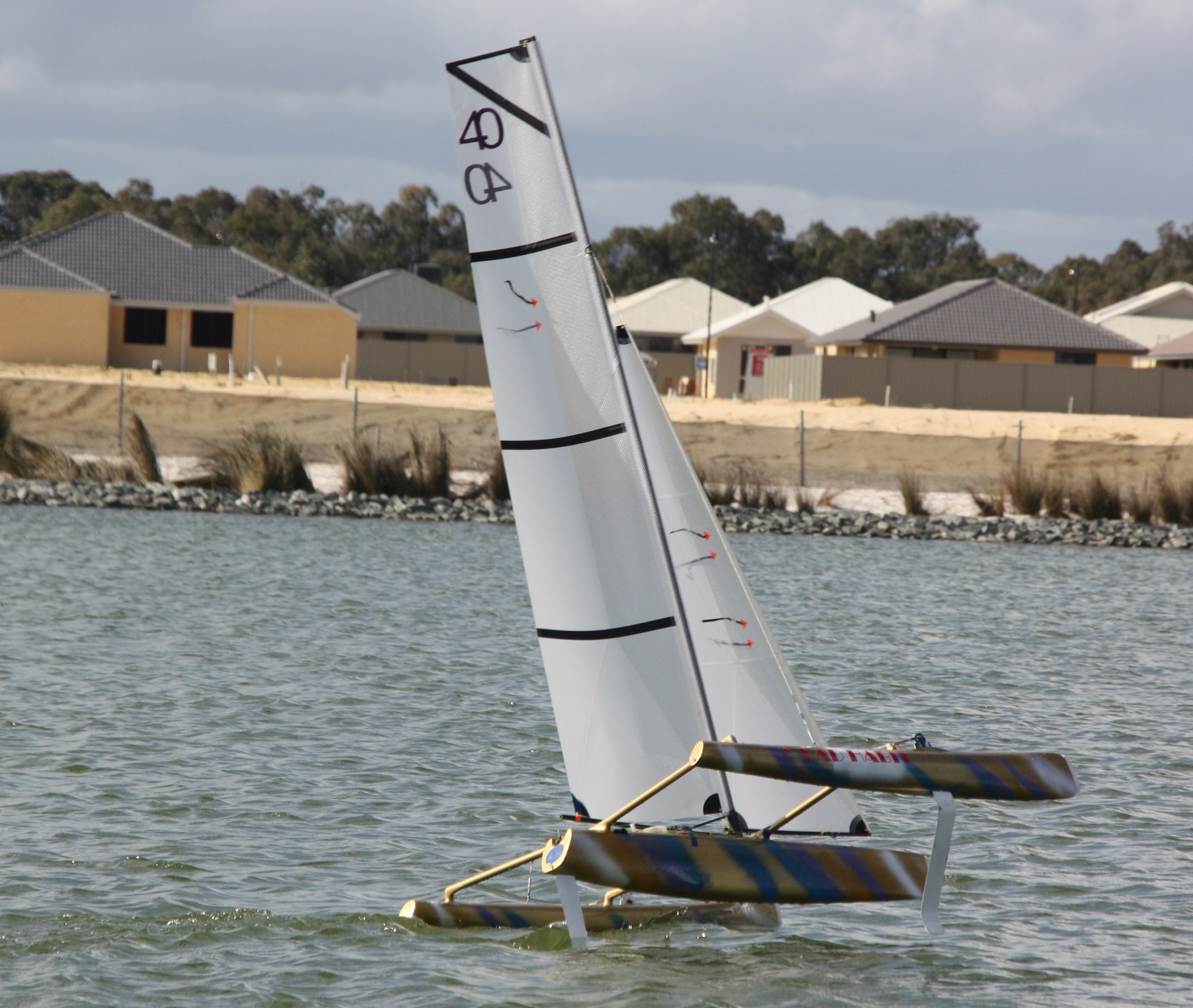

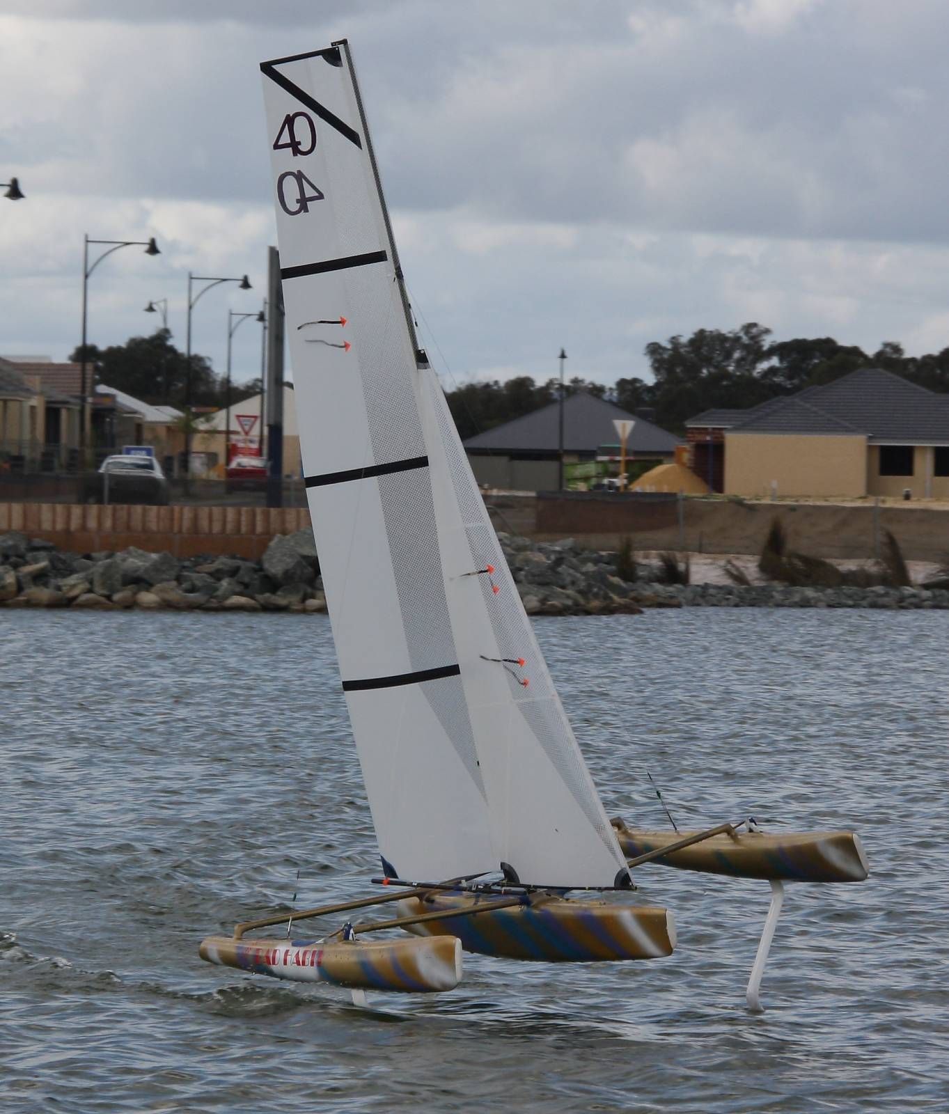

    Had quite a successful Saturday with the Mini40, foiling with the top suit up
    https://www.youtube.com/watch?t=14&v=_8lmu54sZ1o
    Not so good with the One Metre tri - had some long, deep, thin foils on which did not work. Back to my shorter thick ones . . .

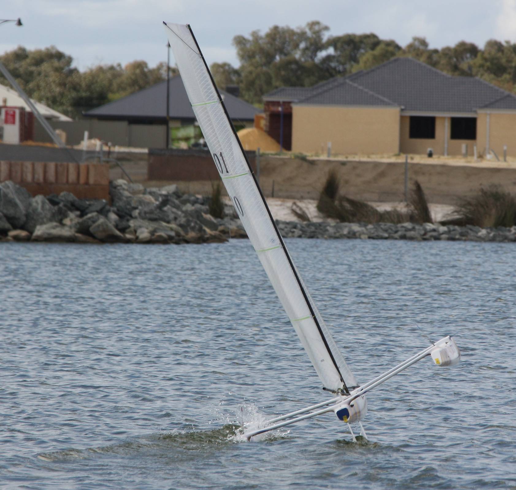

    More progress
    More action from last weekend is here - light winds and strong winds.
    On the Sunday I bent the rudder shafts on both boats - hence the erratic steering in the videos - and cracked a foil on the Mini40. The videos themselves are also erratic as I had the video camera taped to the transmitter as my usual cameraman (14 year old son) was not available.
    The One Metre was using modified foils - cut down from the previous weekend's attempts - and was performing significantly better, in both the light and the strong winds. On the Sunday the One Metre had its D rig up, which was the right rig for the strong gusts. Nice capsize at the end of the video, which is also caught with the onboard camera.
    Mini 40 action here
    http://youtu.be/Tx5mU76yYII
    One Metre action here
    http://youtu.be/MyJ5hS-eeWc
    Anyway, quite a bit of repair work to do before the next sail!
