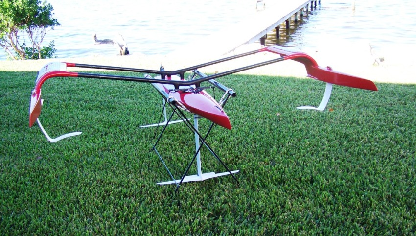

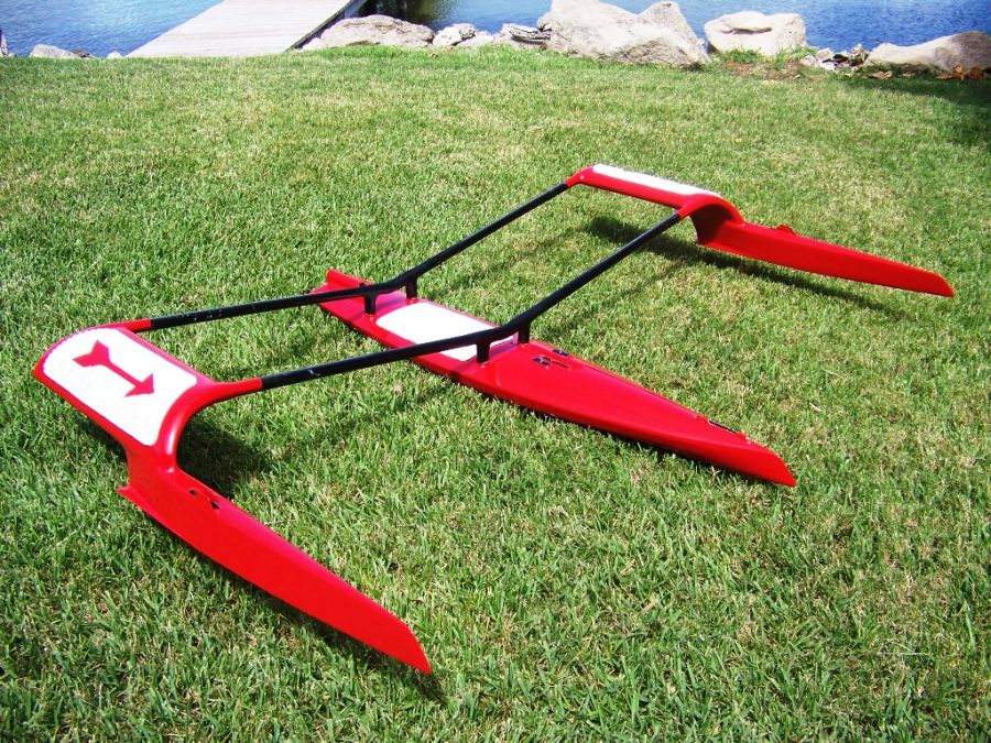

    D4Z update
    Radio box "loaded" and all systems tested( rudders, sheets, F&A ballast, Side to Side ballast), cover, hatch and mast step installed. All that left to sail is running the winch lines and fitting the already complete rig:
    click-

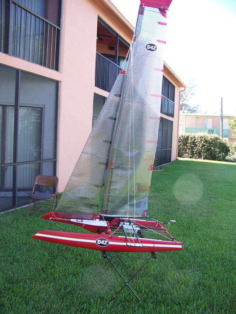

    Doug Lord Flight Ready
    D4Z and Fire Arrow ready to Test!
    D4Z ready for rig test and "dress" pictures( platform+rig+foils) tomorrow if wind is light enough and ready to sail soon after that. Fire Arrow ready to re-start testing June 2.

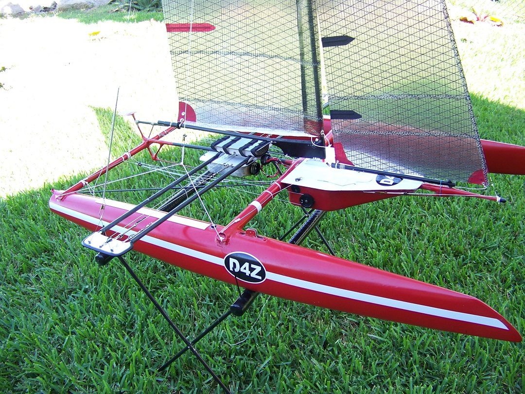

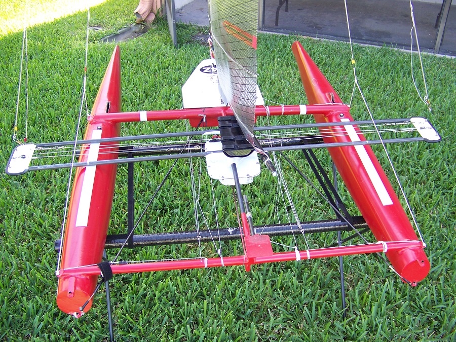

    D4z(ac 4.8rc)
    First test rig:
    click for best view-

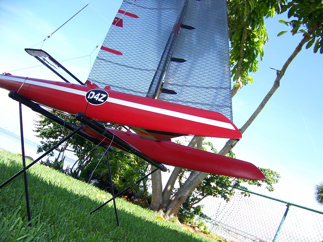

  9. Doug Lord
    Posts: 16,678
    Location: Cocoa, Florida

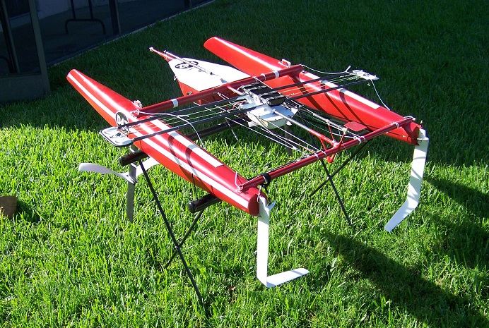

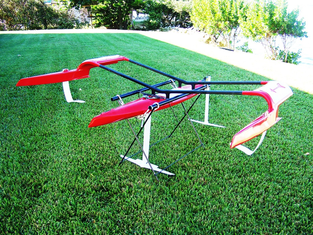

    D4Z Foils (Batfoils)
    D4Z with very experimental batfoils in place. The batfoils are surface piercing T-foils twisted from 0 degrees at center to +3 degrees at the tips. Each main foil also has an intrinsic 15 degree flap(iFlap) on each tip(whose area may be reduced in testing). The idea is to have low speed takeoff and reduced drag at higher speed. Because each main foil is canted bottom out 10 degrees it only requires a 4 degree angle of heel for the boat to fly the windward main foil, reducing drag a lot, automatically.

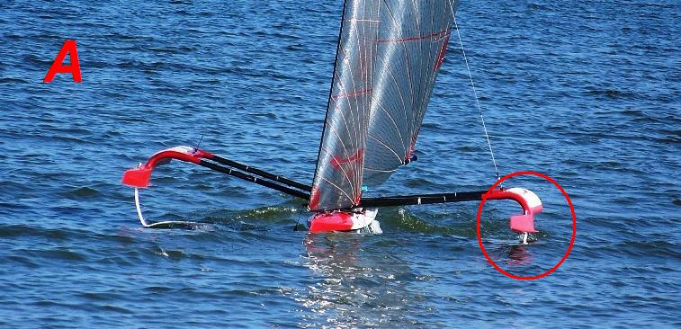

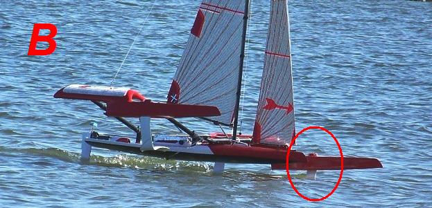

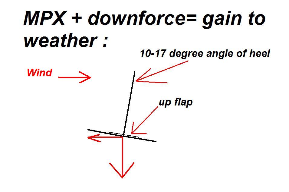

    Fire Arrow Foil Configuration

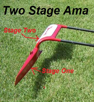

    One of the great advantages of using a properly designed UptiP foil on a foiling trimaran ama is SIMPLICITY: on the Fire Arrow the ama foil has NEVER needed to have the angle of incidence adjusted while sailing as is common on many UptiP foil applications. And if the foil is properly designed for it's application ,it's efficiency will be apparent. As shown in the pictures below the lee ama flies before the main hull, but as soon as the boat speeds up and the main hull flies the lee ama altitude remains the same. That illustrates that the lee UptiP foil is working PERFECTLY in two different load and speed cases.See pix "A" and "B" below.
    The Fire Arrow uses a wand controlled main foil which controls the altitude of the main hull and the angle of heel of the whole boat. Further, and this is very important: the wand controlled main foil works with the single rudder T-foil in a bi-foiler arrangement and the two together control the ride angle of the lee ama UptiP foil. That prevents pitch excursions caused solely by the lee ama foil.
    The way the mainfoil works is that as soon as the main hull flies the mainfoil begins to unload with the lee ama foil gradually taking the majority of load. That allows the mainfoil to work with the rudder T -foil to control the pitch of the boat with far more pitch authority than on a conventional tri. And, using a wand controlled(or similar) foil on the daggerboard allows the main hull to fly MUCH SOONER than it would if it had to wait for wind pressure to do it.
    The mainfoil can also develop substantial downforce* increasing the righting moment in response to gusts. All this is done 100% automatically making for a simple, robust system that requires ZERO crew attention!
    * with downforce, the main foil works similarly to a Moth foil with Veal Heel, generating a component of lift to windward.See illustration below.
    I'm getting ready to test a new type of surface piercing T-foil that may work as well as a wand controlled foil-only simpler. If the tests on the D4Z pan out then a version of the foil will be tested on the Fire Arrow as a direct replacement for the wand controlled main foil.
    The vertical portion of the ama foil is at +3 degrees AOI. The vertical portion of the daggerboard is at zero degrees. So the UptiP ama foil is developing lift to windward to allow leeway coupling and develop lateral resistance for the boat particularly upwind.
    In stronger conditions, when the main foil develops down force( upwind), the leeway components are greater than the vertical portion of the UptiP foil can effectively handle, there is a small extra component of lift to windward(due to downforce)-while the vertical portion of the ama foil is still working at 100%. The daggerboard is designed to be unloaded by the lee ama foil to reduce drag and facilitate leeway coupling.
    However, it should be pointed out that the ama foil will still provide substantial vertical lift with little to no leeway coupling-like can occur off the wind. Lift substantially(and automatically) increases upwind because of leeway coupling.
    Testing clearly shows the progression of the boat to full foiling from the problems encountered at the beginning-the last video is 100% proof that the foil system worked perfectly-regardless of any uninformed attempt to say otherwise. But testing is not done yet even though we reached a major milestone with the boat foiling in a 5 mph wind while using two different altitude control systems simultaneously. Hopefully, starting in June we'll get a lot more video and in stronger wind. But July 24th, 2014 was a major accomplishment for the boat after a great deal of development-and we will build on that this year.

    10) allows a "Two Stage" ama that provides back up buoyancy if needed but allows the part of the ama that would normally make incidental contact with the water, to be as small as practical.(see pix below).

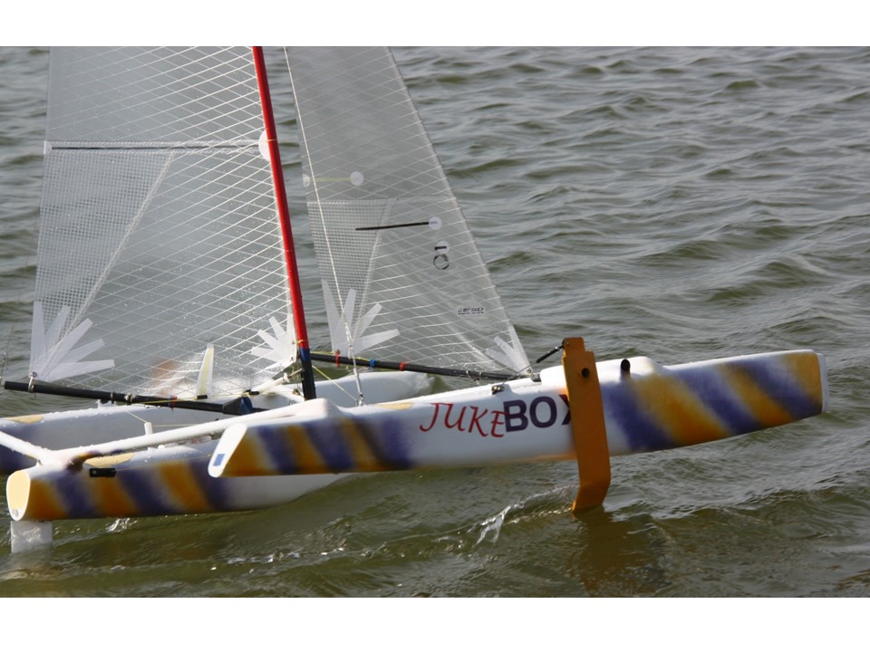

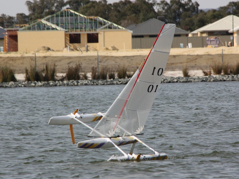

    One Metre trimarans
    If you are interested, I have just finished three new boats, two 1 metre tris and a new Mini40, and I now have some action of the boats in gusty conditions. It is here:
    http://youtu.be/Tjy8zr1fRig
    There are two different positions for the foils on the boats. In the windy part of the video, 01 (white yellow purple hulls) has the foils in the aft position, intended to give better manoeuvrability but less foiling stability, whilst 02 (white red blue hulls) has the foils further forward. Both appeared to work well, and there are brief glimpses of both boats foiling. I started off with the top suit on 02 which was a mistake - should have gone with number 2 rig form the start, but the hook in the ball bearing swivel on the jib tack gave way on a gybe, not the first time I have experienced this.
    The boats were fun to sail and did hydrofoil. Whilst not elegant, fitting the foils outboard of the hulls is simple and relatively easy to move fore and aft. You need to be more accurate with rig choice and definitely not overpower them. But they tacked OK in a breeze. In the light wind video clip at the beginning they are using just a centerboard.
    The new Mini40 - a Firedragon from Roland at rcsails.com - has foils that are connected to servos in the floats so in theory I can get some down-force working on the windward foil, but the kicker broke on the boom before I had started to see if it was going to be effective. . I think the fore and aft position of the foils is OK as it also tacked quite quickly.

  15. redreuben
    Joined: Jan 2009
    Posts: 1,778
    redreuben redreuben
    Perth man, really impressive, especially your skill in the conditions, what really impressed me was the forgiving nature of the boats, nose stands and high sides but always recovery. No doubt your skills as well ! The foiling is definitely getting there, some impressive runs, well done.
