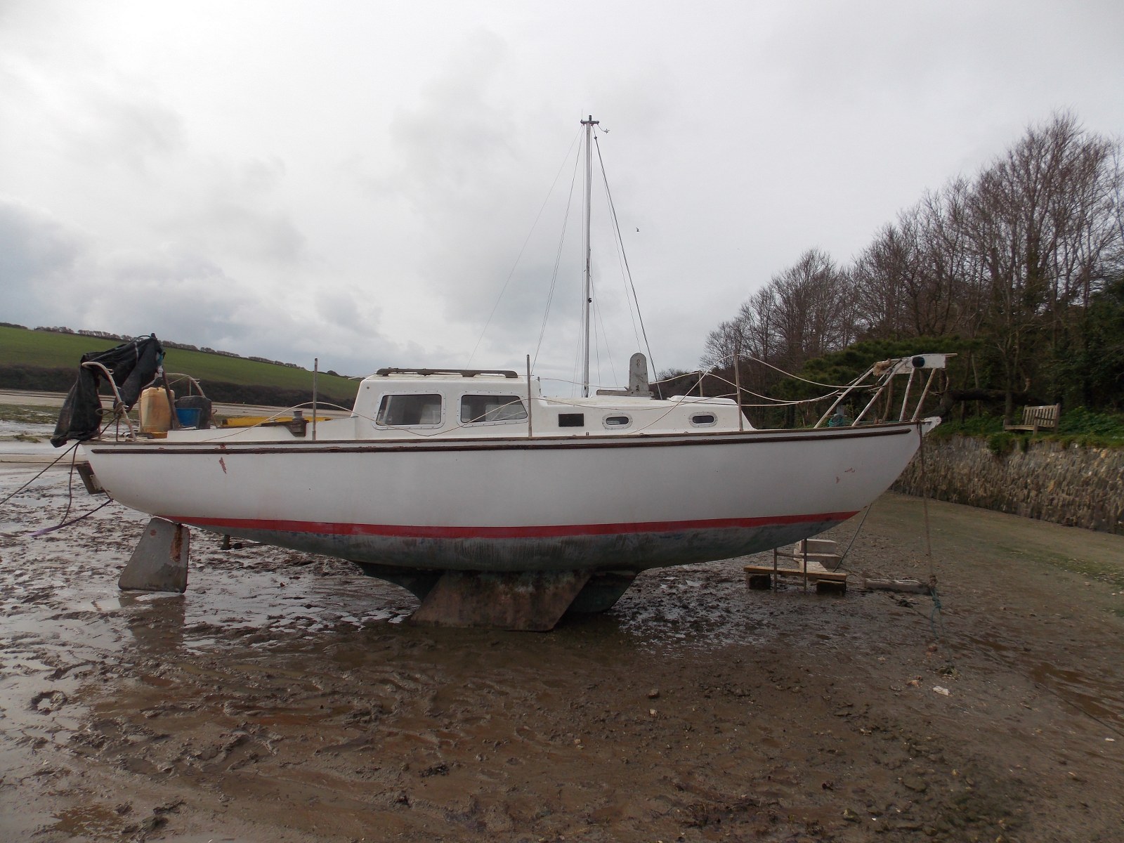

    Trident 24
    This is one of the Yachts a Trident 24
    Very strong old boats and solid thick GRP construction
    I would keep the roof on the cabin intact for strength but would lower the existing to match and level up with the fore cabin above the V birth, then would build my design around all this hiding and integrating the existing design.

    With structures you can do almost everything. Another thing is that, by weight or appearance, worthwhile or not.
    In addition to the stiffness and strength of the webs, you must consider how to join them to hulls, how to create the necessary embedding of the transversal beams with the hull, on the inside and the outside of the wet deck.

    The strong points are the tabernacle and chainplates on the mid-section. At the bow and stern, the chainplates. Usually there is also major reinforcement at the jib tracks and winches.

    Yes, you can do this, but these particular boats would make really lousy catamaran hulls. To make them anywhere close to efficient, you'd have to separate the hulls by a huge amount, just to clear each's bow wave.
    What might be more interesting would be to cut both hulls in half and bond the bows, end to end. In this same vein, you could cut each hull down the centerline, then bond over the cut with a flat plate, making two asymmetric hulls. This arrangement would sail better, though the hulls will still be quite fat, at least the inside bow waves, will be modest and you can get the hulls fairly close together.
