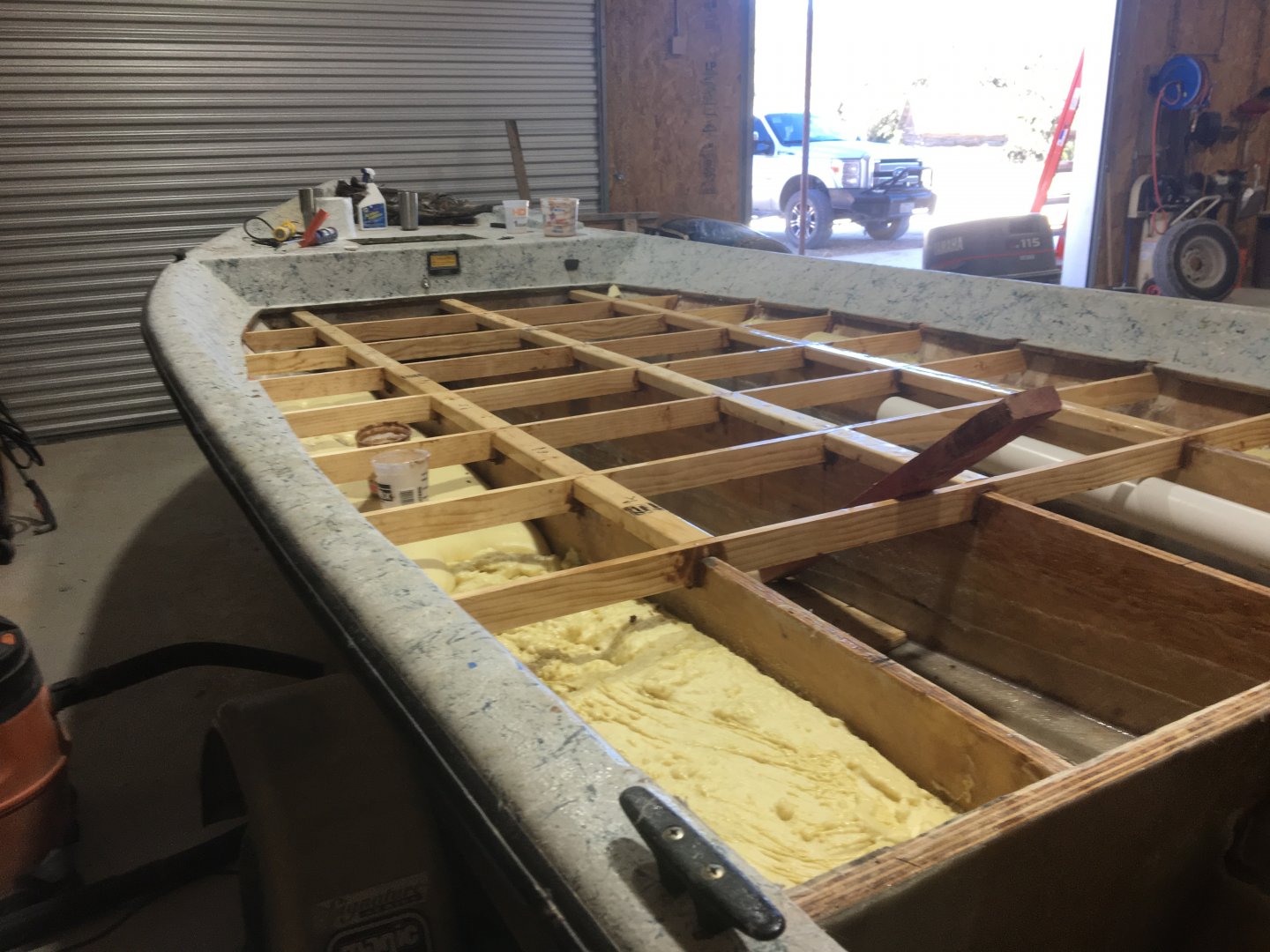

    Thanks, I have built the XF 20 twice and the SK 14 and gutted and rebuilt a 20’ Explorer
