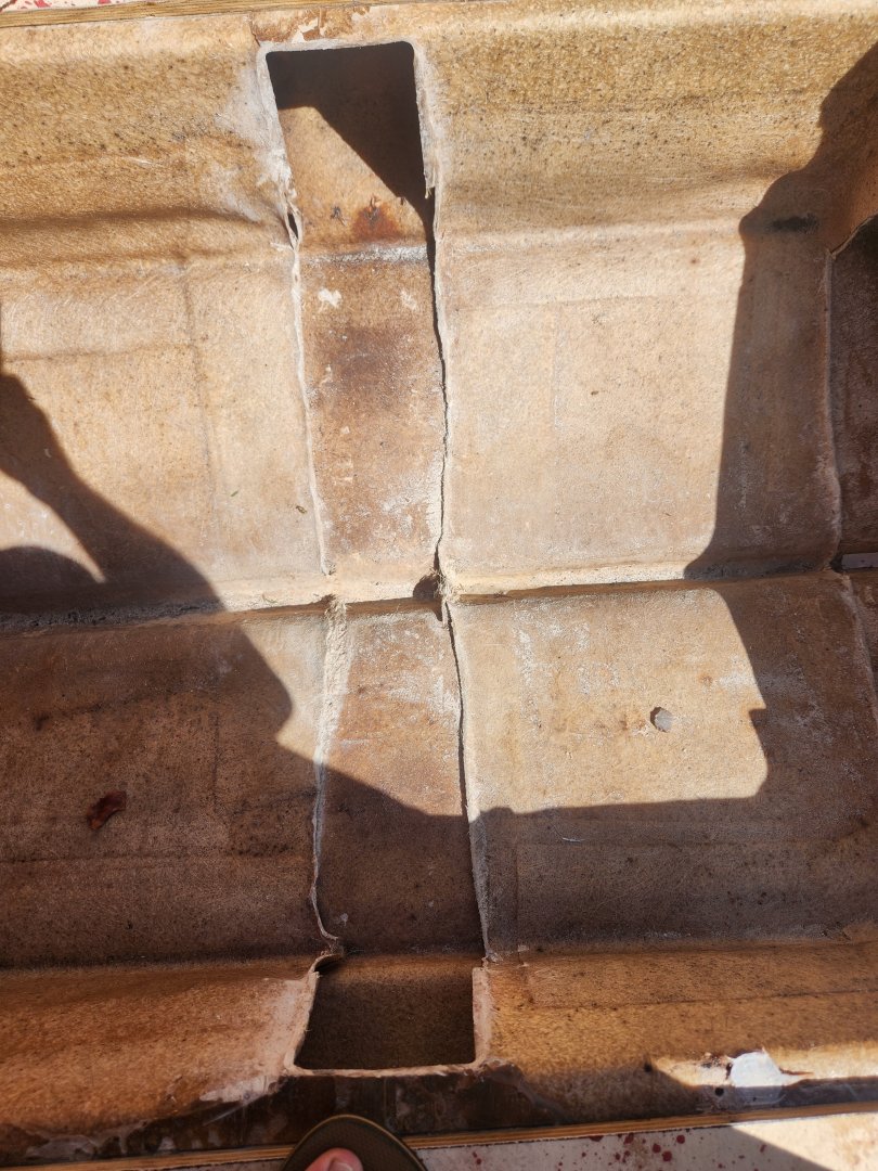

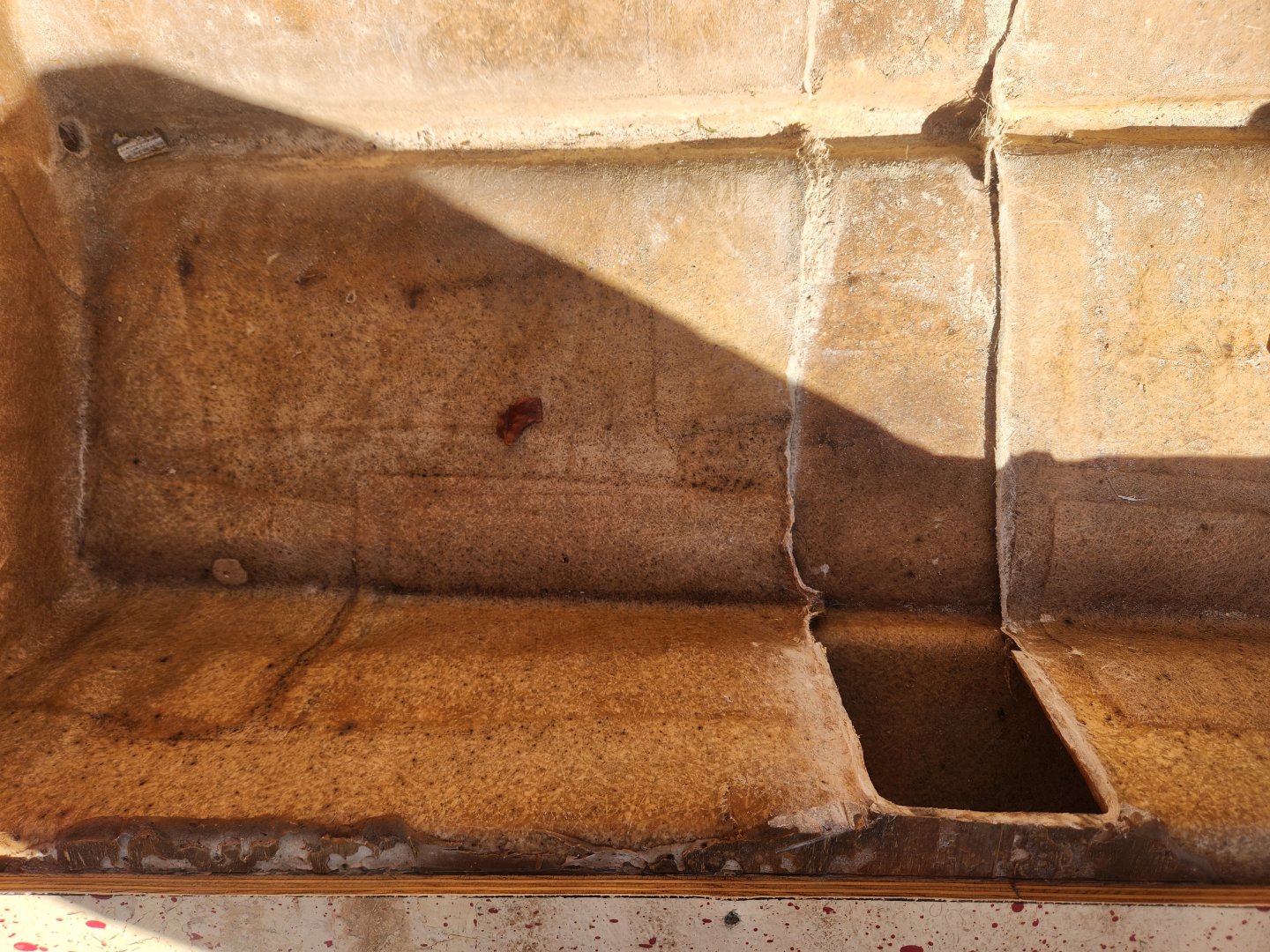

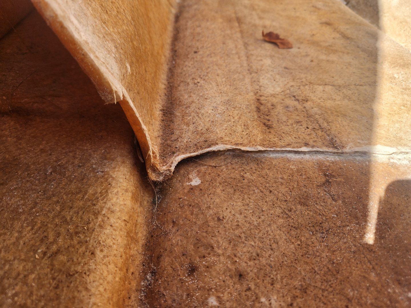

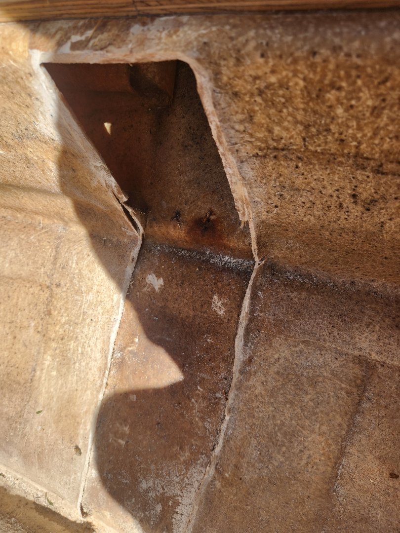

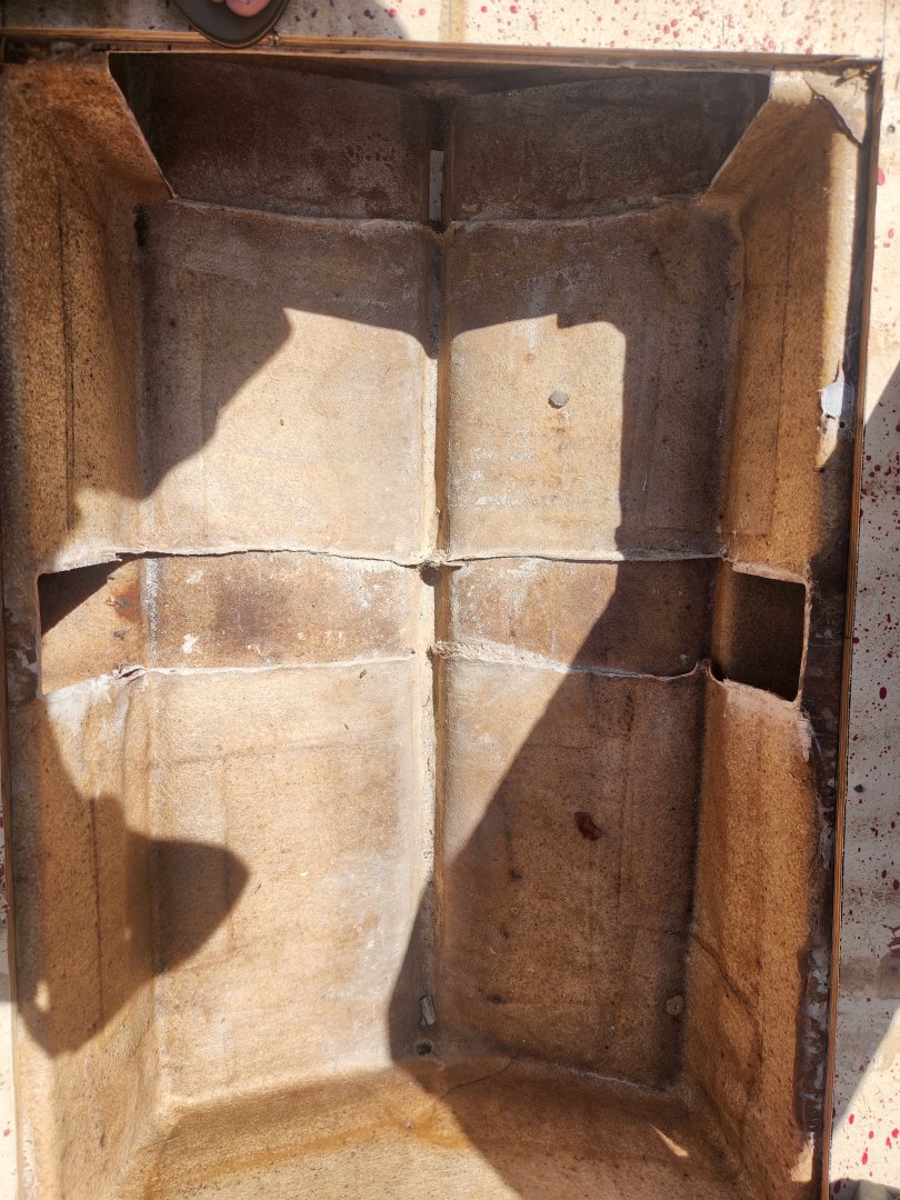

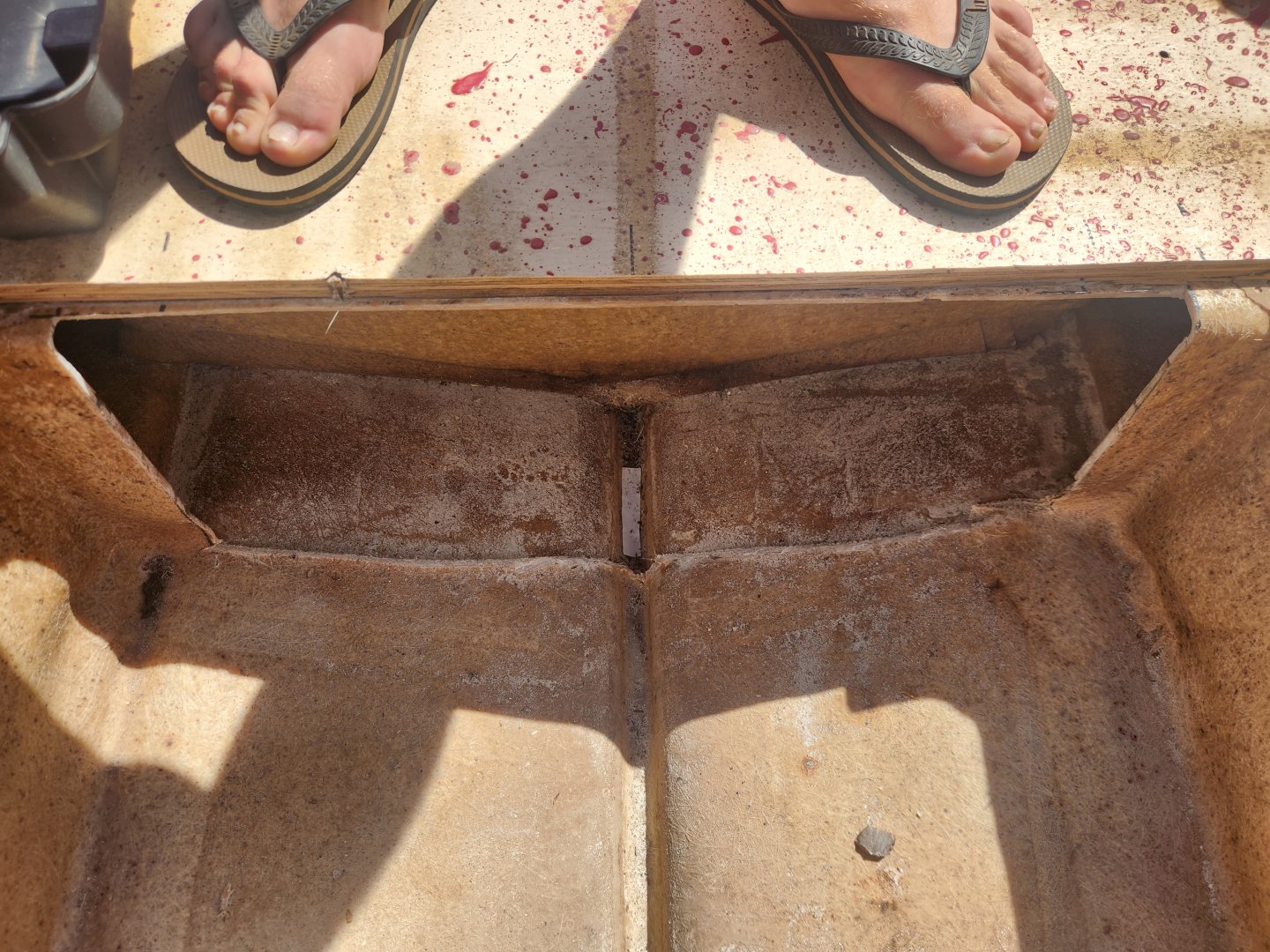

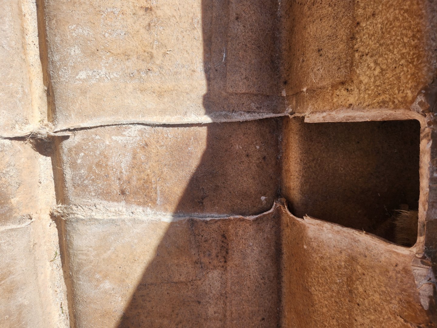

    Hey mate I managed to get some photos today I also went to a fibreglass shop to see what I could buy here and looks like I can buy 1708 and the West systems epoxy unless you suggest something else I have attached some photos of under the tank appreciate the help to make sure I do this repair properly

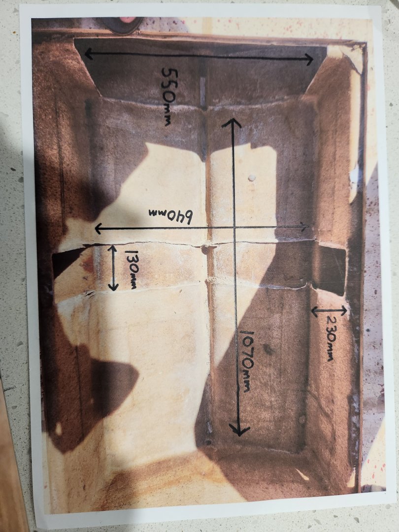

    So, I can give you what I would do later today. Gotta run for now.
    To get started, you'll need to shave off any high spots around the cuts and then repair the cutaway with filler. The vee areas you should fill in a couple of lifts to make sure it doesn't overheat.
    You don't need to do the entire section with glass, but if you don't, you'll create a hump, so it might be best.
    So, also give us measurements of it.
    You will need 1708, epoxy, and cabosil, aka fumed silica.

    Hey mate I have taken some measurements hopefully this is what you needed

    In the picture, it seems that one stiffener is removed, and another is slotted... Be carefull. In addition to structural issues, the tank has to be properly fixed, and the compartiment should not only be watertight, but also gaz tight from the interior.

    Crickeys, you blew threw another transverse I see now..
    That is frustrating, because it means the stringers are a bit more compromised.
    Repair that section first. Lay a timber up into the top edge; it may require some fancy rips. Bond it in and use screws to hold it. Make sure the top edge has a radius. On the bottom, put a timber in about 6" wide. Make them just a bit longer than the cutout. They are stay in place formers. Then cut three
    Pieces of fiberglass the width of not the hole, but the original stringer plus the height to the top edge and then make each one about 2", 3", and 4" longer than the height of the cutout; the excess will lay on the bottom of the opening. Make fillets with epoxy and fumed silica where all sharp edges are on the former/old stringer web interface. Start there, ask questions if you need to
    For ordering, calculate all the glass needs. So measure this repair and then add another four pieces the width of the entire section plus the height of the sides times 4. It cannot be measured short. If I was doing the work, I'd use a 50" wide piece and go up the sides.
    present back here the pieces planned dimensions and we can give you an epoxy estimate and make sure you planned correectly
    you'll only need maybe about a gallon or two of silica by volume
