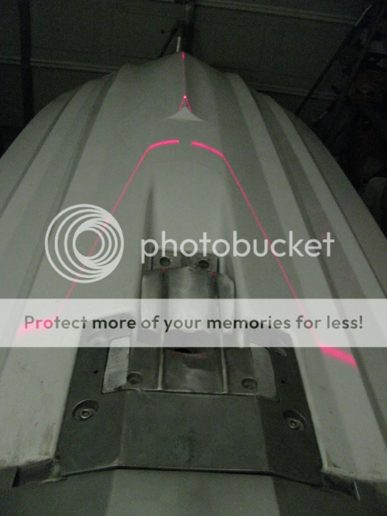

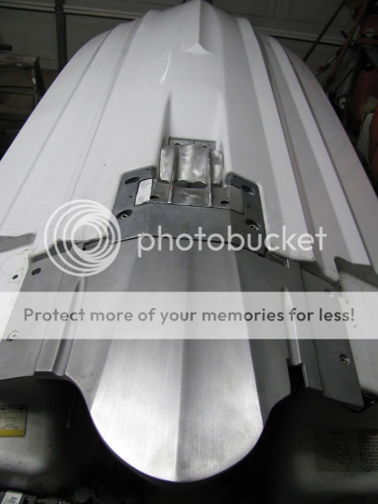

    Here are some of the basic pictures of my pump assembly, the intake which is molded into the hull, and other components such as the intake grate and the pump shoe.
    The last picture uses the level lazer to show how the hull would appear at speed. It is set at an approximate angle of attack of 3 degrees.
    Part of the keel is still, according to the lazer, in the water at high speeds, and this is what one would see if one were to take a picture of the boat as it traveled over 75mph. I am aware that many would comment that the keel could be part of the problem in that it could induce cavitation.
    Your comments are requested.

    Baeckmo, here is some of the information that you requested. I know that your technospeak is different from the PWC world, so at times I will be more descriptive.
    Pump inlet dia 155mm
    Venturi outlet dia. 85-87 mm (there are different sizes) style is round
    Wear ring Length 66mm (surrounds impeller)
    stator vein Length 33mm
    venturi Length 151mm
    steering nozzle dia. 88-90mm (swing bucket)
    total pump length 300mm (does not include swing bucket)
    Impeller dia. 155mm
    hub dia. (trailing) 78mm
    hub dia. (leading) 32mm
    Impeller pitch 14/20
    Distance from the (bottom of the) keel to the impeller (approx) 940mm
    Pump inlet to impeller 640mm
    Highlighted by the lazer shows where the hull begins to form into the inlet. The distance from the top of the keel to the inlet is 320mm. From the bottom of the keel to the inlet is 300mm. The keel slopes toward the bow.
    The pump inlet width starts at approx. 110mm and gradually opens to 120mm over 440mm into the tunnel. In the last 200mm of the inlet, the tunnel goes from 120 to 155mm in width where it meets the wear ring.
    Engine hp 165
    RPMs 7200
    Boat weight and rider approx 900-1000 lbs
    Present speed: approx. 72-73mph

    Thanx for this info, will first check possible operating point with regard to max flow. Two more q; the pitch numbers 14/20 would that be inlet/outlet pitch in inches? Or...? And in pic no 4 there is a "blocking plate" inserted in the roof of the ramp section; is this used for fine tuning?

    As to your 2nd question, in a manner of speaking, yes I was suggesting that part of the roof could be blocked off. In an earlier post I was suggesting that perhaps another wing could be welded to mirror the existing wing and deflect any water that may flow toward the roof closer to the center of the impellar. In the picture, I used a large 25 thousandths machinist shim to give that effect. I just laid it on top of the mounting portion of the intake grate to get your opinion.
    The bold rectangular part of the intake grate follows the roof line of the intake tunnel, and the long black straight line shows where (and at what angle) high pressure water enters the intake tunnel. High pressure water would enter from this line and lower towards the leading edge of the front "wing" of the intake all the way down to the leading edge of the rear "rake" of the intake. You cannot see the rear "rake" in this photo, but it is the very aft part of the inlet hole. Other photos to help you see what I am discribing to follow.
    When the craft is at speed, high pressure water does not get close to the roof of the tunnel, according to the level lazer.

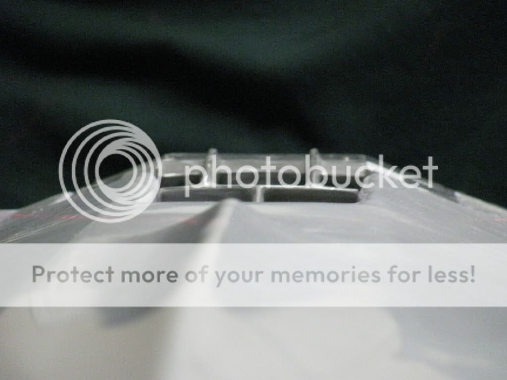

    To find the angle, I used a digital angle finder. The venturi (most PWC users call them thrust nozzles) on this craft is fixed at 3 degrees. I laid the angle finder on top of the shoe (flat pad) and adjusted the keel on the ride plate to 3 degrees to match the thrust nozzle Some peope call ride plates pump covers. The ride plate, if adjusted properly can be used like a giant trim tab and create lift.
    The level lazer was mounted on a tri-pod. You can see the lazer and tri-pod in an earlier picture located just in front of the bow in the back ground. The lazer height was adjusted so that at its LOWEST SETTING, the lazer light would touch both the most aft edge of the shoe and the most aft edge of the ride plate at the top of the keel. In order to simulate the wetted surface increasing and decreasing as the boat gains speed, you just raise or lower the heigth of the lazer.
    http://i900.photobucket.com/albums/ac208/shakadog/IMG_2307.jpg
    I took this picture with the camera right next to the level lazer to show how much of the inlet was exposed if the hull were truely riding at a 3 degree angle of attack. The inlet is very closed off at speed, as Baeckmo has stated earlier.
    http://i900.photobucket.com/albums/ac208/shakadog/IMG_2312.jpg
    In this photo, you see the wetted surface with the tripod in the background. The lazer clearly shows the keel of the hull in contact with the water at this simulated speed and ride angle. If the hull were in a 5 degree angle of attack, the keel would probably not be in the water.
    If you look closely, you can see the lip of the inlet tunnel, which is about 300mm from the keel.
