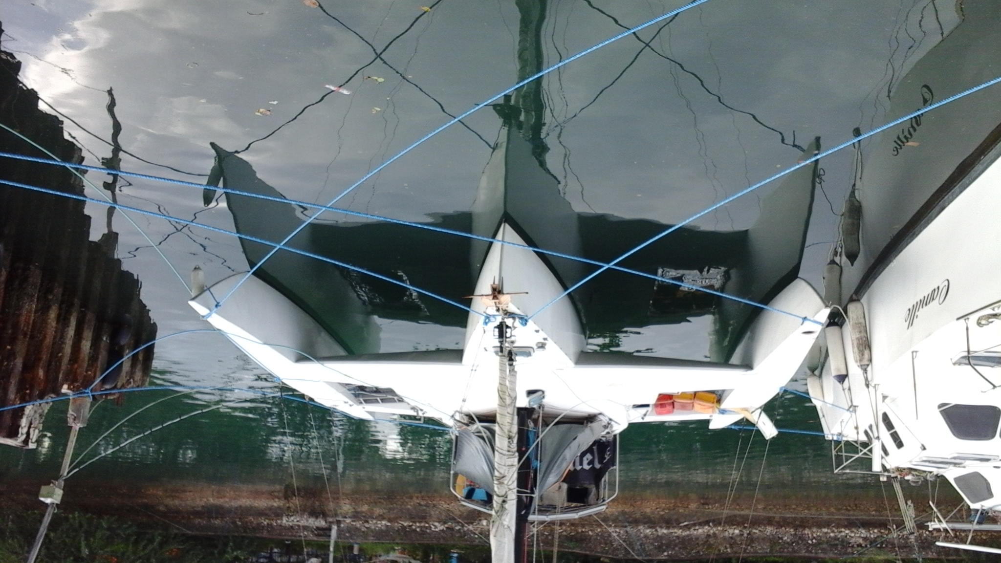

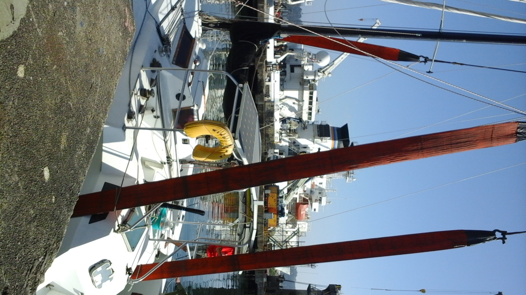

    Hello Cav and company,
    I am a newbie boat owner who bought what was advertised as a Hedley Nicol design. However, I have not been able to verify the actual design or designer.
    The boat is different from the early Nicol designs in that it is a much sleeker build. A Kiwi friend suggested that the boat resembles some of Lex Nicol's designs, and may actually be one of his.
    I have included 2 photos, which I hope will spark some neurons in the brains of conoscenti like yourselves. In one photo, the boat is "spider-webbed" in anticipation of an on coming typhoon, but it still has a tarp over the cabin, making it hard to identify the design. In the photo, of the boat being hauled along-side the dock, the small cabin is clearly visible, making it an unusual design for a Nicol.
    Please twist the photos around as may be appropriate and let me know if any of them ring a bell (the wife took them), and let me know if plans for the boat may be available. Have some damage that needs repair.
    Thanks to all,
    G2L

    It looks like a Hedley Nicol that got modified. The hulls are similar to the basic Wanderer/Vagabond/Cavalier/Buccaneer hull form. The scantlings could give a hint as to which one.

    Reverse sheer is used on all the Nicol designs, one of the reasons along with the ama bows we wanted to see a side view. Add a long stern to a 36' Cavalier and you have a 12m boat. Buccaneers start at just under 40' and are usually stretched to 42+ with the stern. If you take the pics it will be easier to help you.
