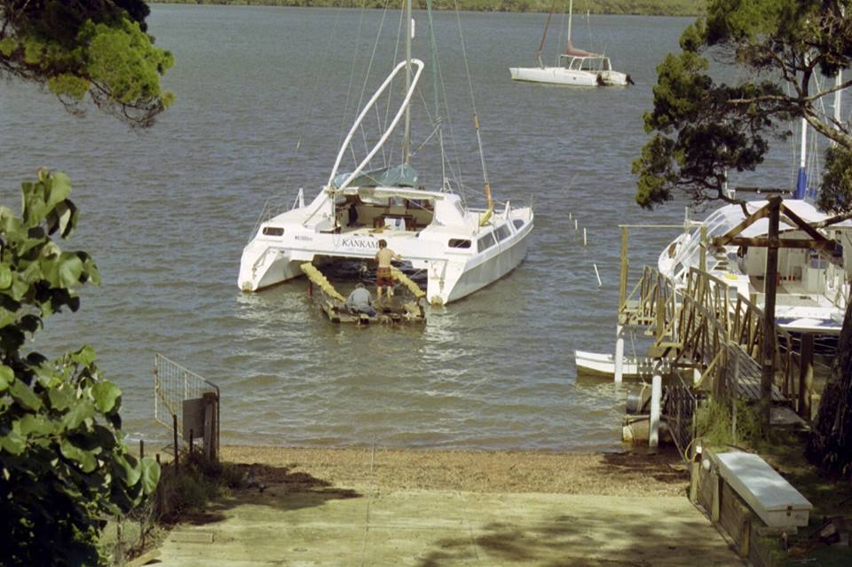

    PAR - I like reading your posts but on this you need size and toughness. In Australia we have Gumtree for cheap stuff. Craigslist is the thing in the US I think. A few minutes on gumtree and I found this
    http://www.gumtree.com.au/s-ad/ingleburn/trailers/box-trailer-free/1111254596
    Go in - rip off the rolling gear - axle, hubs, wheels. Put the word out and within two weeks you will find 4 sets of axles. Weld them with angle and you are off and running. I reckon I could pull Kankama out on most beaches given one week with my ear to the ground, 10 hours work and access to a wreckers yard. I have done it three times with my boat.
    If I had my own yard and wanted to steer then I would weld a frame on this
    http://www.gumtree.com.au/s-ad/wallan/truck-parts/wrecking-1984-f250-dually-chassis/1111681122
    Kankama got lifted out on my friends version of this support under the bridgedeck. Great for antifouling as the hulls are free of supports. Good for steering and very strong. And cheap.
    Don't re-invent the wheel. This is the usual set up for waterfront multi owners in Oz.
    Stop Press - Found this photo of Kankama about to be put on Glen's frame on chassis set up.
