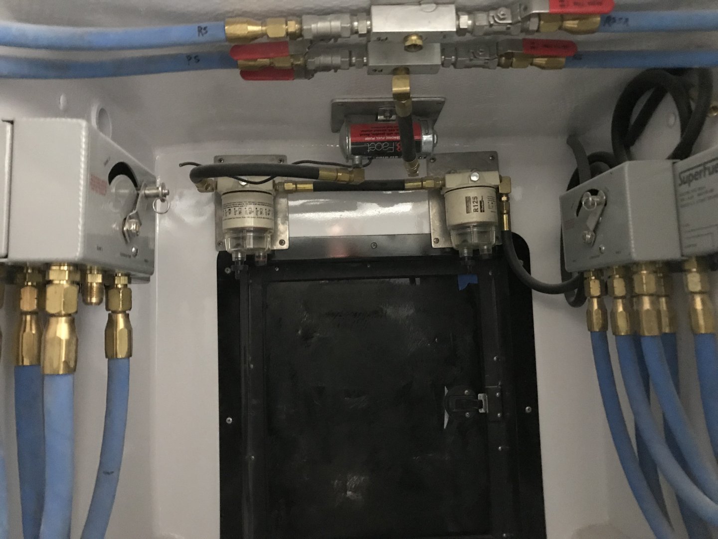

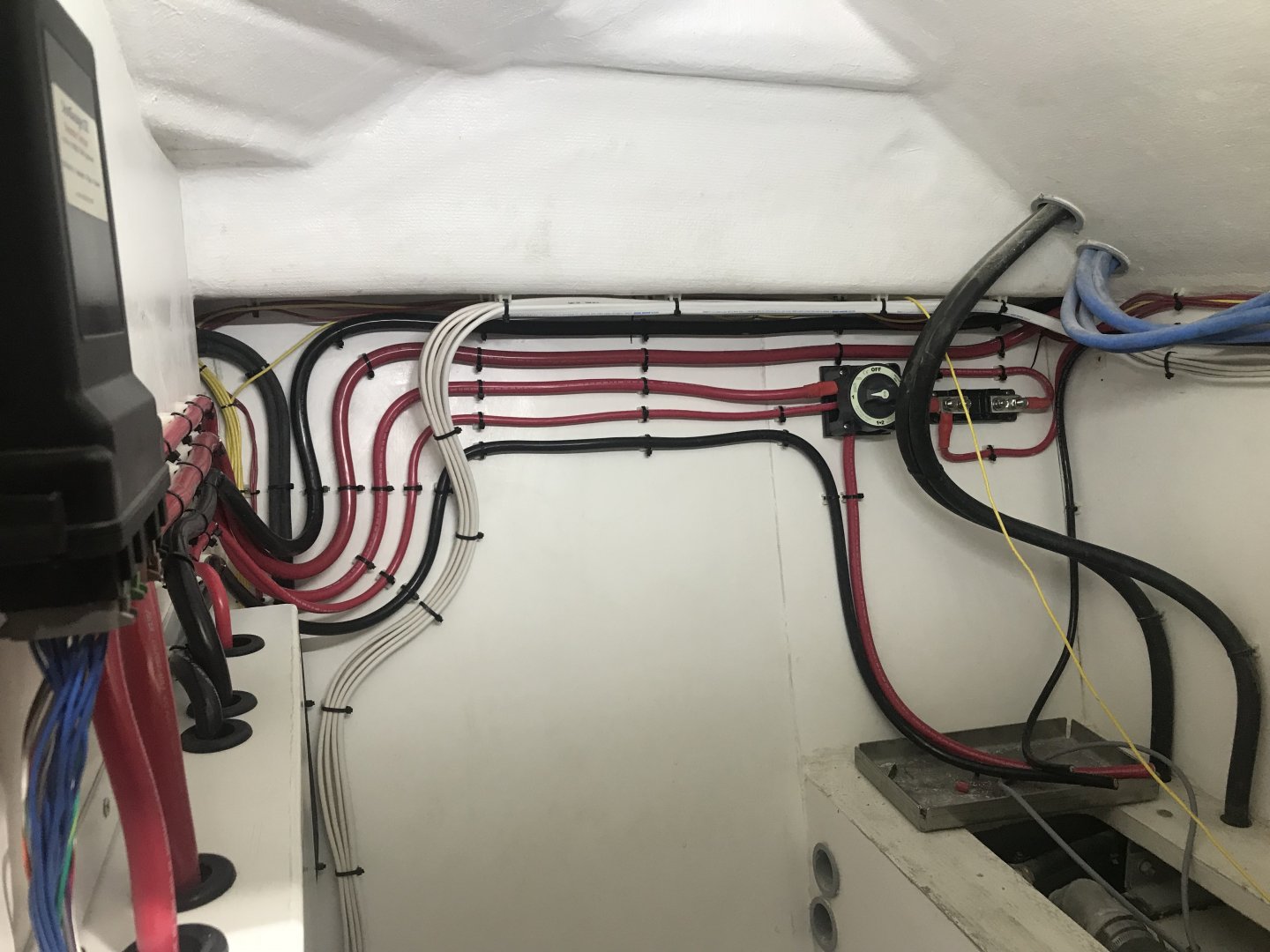

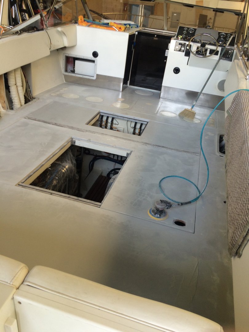

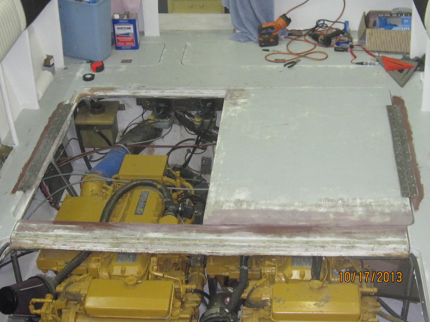

    Working on the project when i can:
    Disassembled engines to long blocks
    Replaced main, rear seals and gaskets
    Removed and cleaned all coolers
    All new water pumps
    New Belts and Hoses
    Rebuilt alternators and install light weight starters
    Stainless j-boxes, Murphy gauges and all new engine wiring
    New sending units
    Purchased Cheto C-guard G2 digital analog to digital gauge conversion system (did some testing on the bench but not installed yet)
    Fabricated mounts and installed direct drive Vickers Hydraulic pumps with raptor couplings for power steering on each engine
    Fabricated hyd tank and installed check valve and priority valves
    All new steering hoses and one new orbital steering valve for the upper station
    Rebuilt trim and steering cylinders
    Rebuilt transmissions
    In the process of going through drives
    Rehab Generator also
    Fleet guard 1218 20 micro primary filters
    Airdog primary and secondary fuel pump and filter system ( 4 micron factory filter)
    Imco high volume electric fuel selector valves
    Ops secondary oil bypass filter systems
    New motor mounts , fabricated stainless and alu mounting brackets
    Ran engines and gen on the stands then installed (removed for final engine room paint)
    Lots of glass work. New fuel tank covers and gen hatch. Glass floor gutter for hatches
    Fabricated, fit and replaced most of the plexiglass on the cabin door and hatch
    Finish floors and engine hatch next. That will take some time

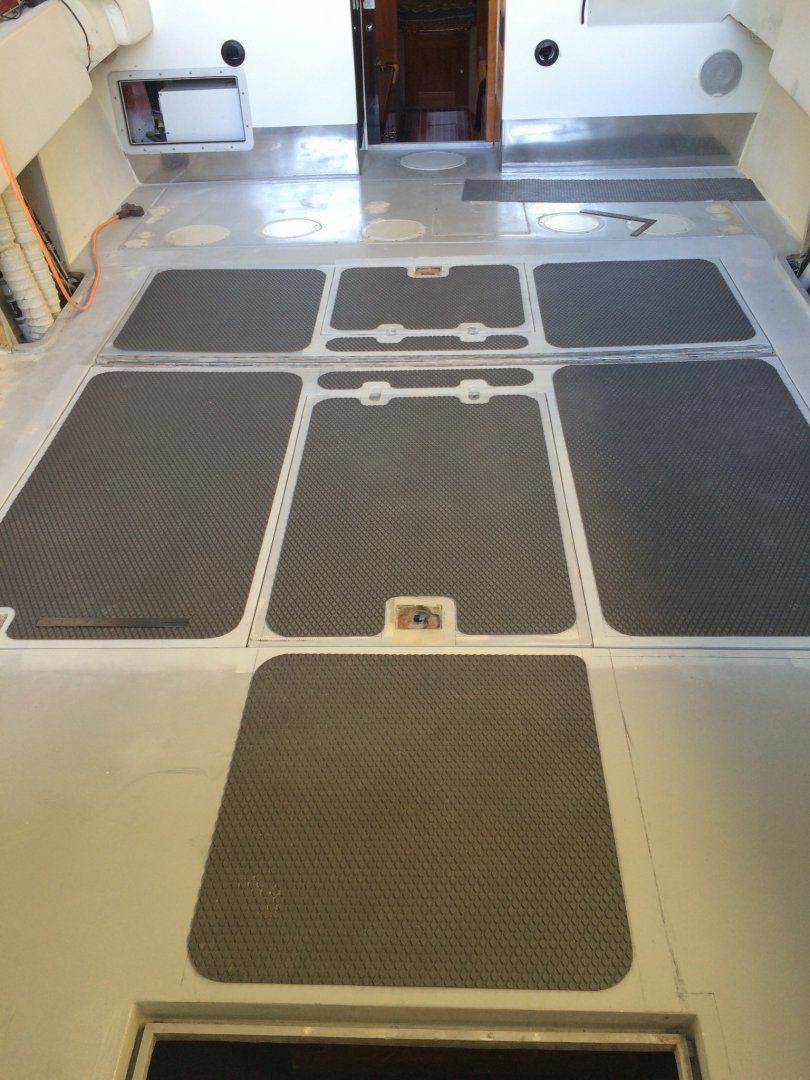

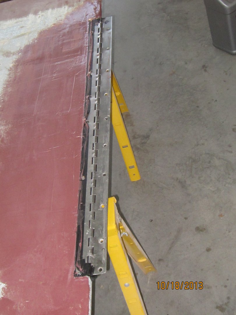

    Shawn. I forgot to mention that we changed our main floor to a two piece "gull wing" design. Much better. If u need information on that let me know.

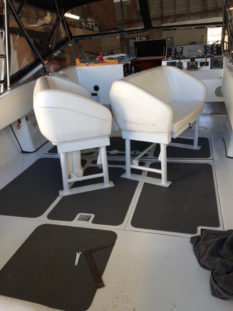

    I did get a small project crossed off my list. Last year the Harley was anchored out a ways, and I didn't visit it for the last two days of our stay. I packed up my stuff, hopped in the dinghy for the short ride to the boat, climbed aboard, and found that a family of otters had been using the cockpit for an outhouse! It was really bad!!. I dug through the garbage and found a Starbucks cup to use as a scoop. The 30 mile or so trip back to the truck was pretty smelly. No need to say the carpets were all ruined, which was fine because they were getting worn anyway. I had been talking about tossing them, and installing some stick on nonskid. I don't remember the brand, but it is heavy duty, and has diamond shape design to it. I also fixed the many dings and gouges in the cockpit floor, and repainted it before the final install. I took a few pictures during the project, but have not taken any of the finished product. I will try to do that soon.
    It’s great stuff, and much more practical for me than carpet.
