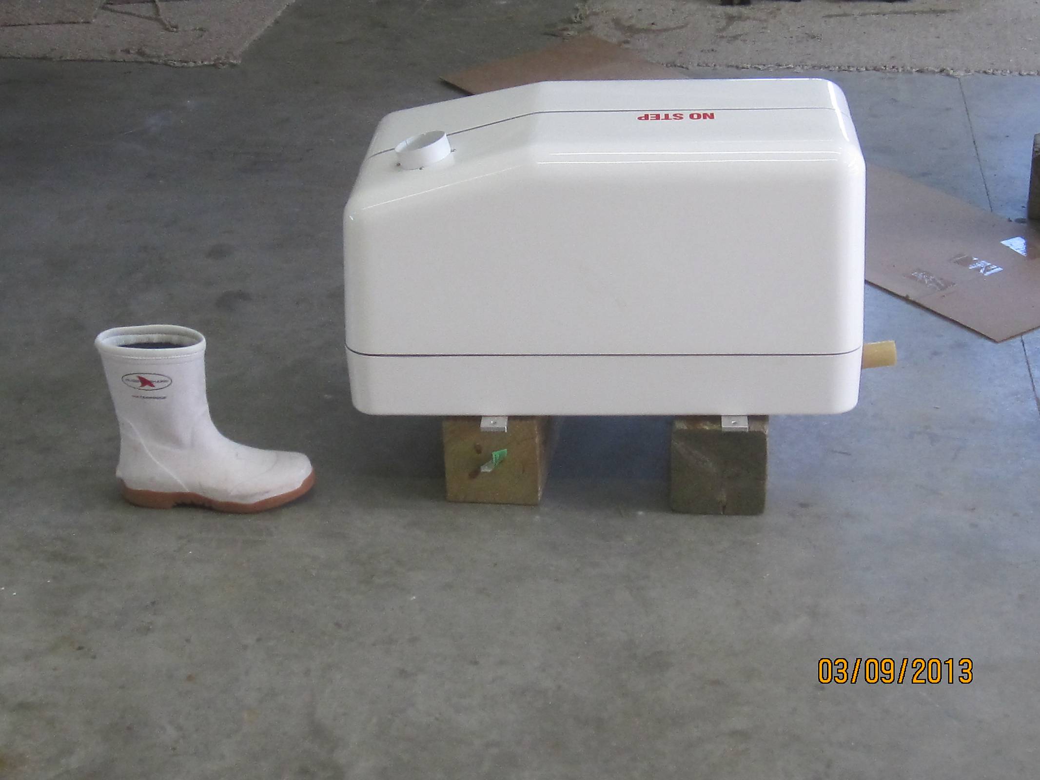

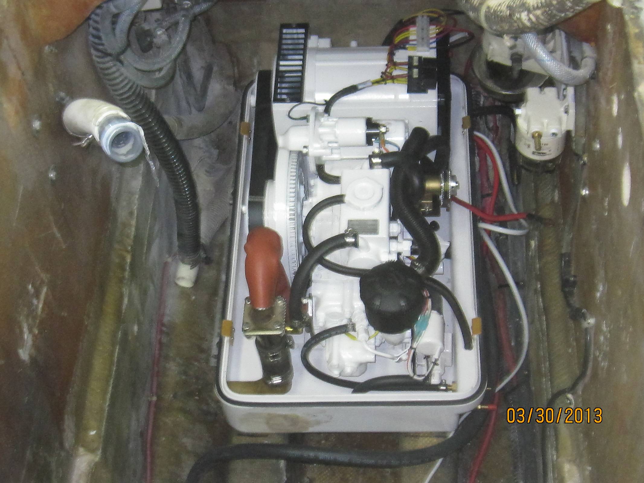

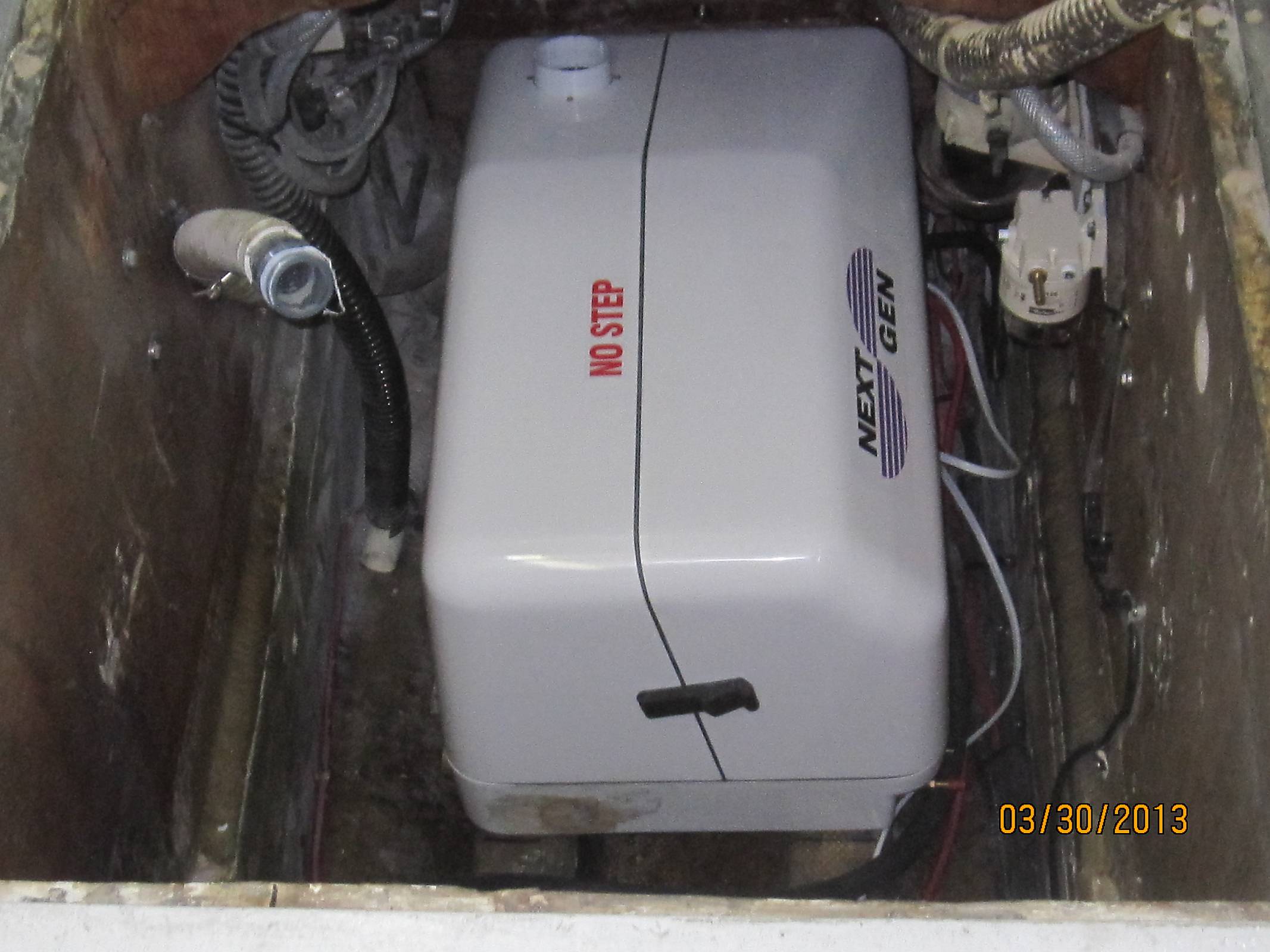

I put in a 3.5 KW by Next-Gen. It is a 7hp 1 cylinder Kubota diesel. I only have bout 50 hours (or less) But yes still like it-trouble free so far and sooo quiet.

That looks sweet - it drives your A/C, stove top and microwave concurrently?
My westerbeke 6.5 flaked out. Pulled it (that was an experience BTW as it weighs 400-plus pounds) - I dropped it off to a well known Westerbeke rebuilder here locally and he has ha health issues galore last 3 months.... trying to be nice understanding guy but getting ridiculous. Cant ever seem to find good reliable boat people in S. FL and this is the boating capital of the world???? Bitching aside - what did that thing set you back?
and when are you installing my bow thruster and finding me some decent diesels like yours to install ;-)
