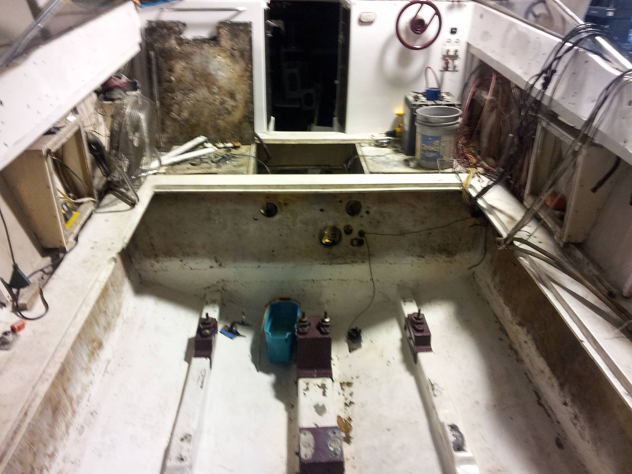

    Hey there "boating", are you in Atlanta by chance? I saw that other Harley a while ago. they were trying to sell the running gear at the time.
    I am on Lanier - restoring (a 2 year project) a 42' and hope to launch in April. DSC07784.jpg

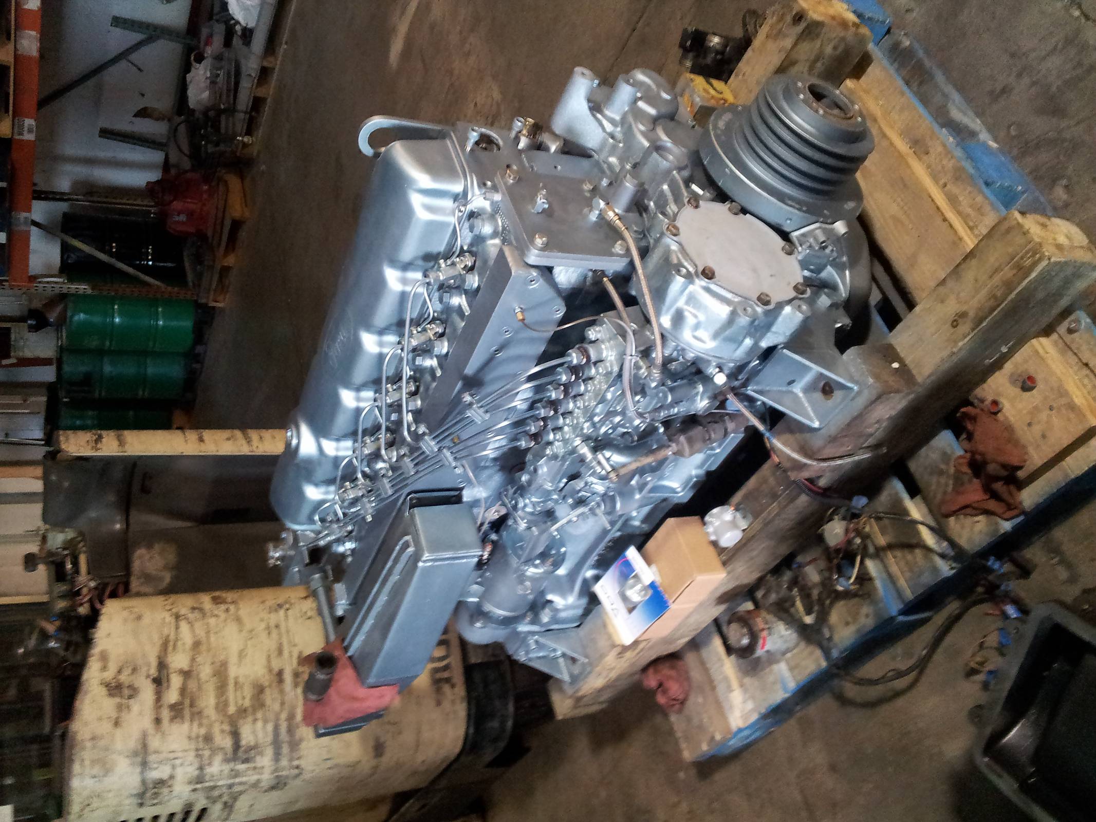

    The boat is finally coming together. Motor 1 is going (and pretty), cabin is stripped out, wiring out. Upholstery is done for outside.
    The miami boat show is the trip to decide on interiors, goodies, and electronics - gauges, radar, chart plotter, controls, lighting, etc - lots of shopping to do!
    message me back if you will be there and we hope to connect!
    Sorry about the motor pic being sideways - It was rotating by itself and can't fix it.

    Dreamchaser, what engines do you have in yours? They look l like they are mounted pretty close together.

    They are the original Merlin's - 450HP running Arneson ASD-8 below is a pic of what they looked like before I pulled them out to do an OEM rebuild.

    The Merlins were made from the Ford 7.8L (Brazilian) (inline 6 - 474 ci) or sometimes other versions (lower HP) were called Lehman's. Merlin took the basic 215 / 300 hp for 7.8L and marinized them and modified the pistons, injector pump, turbo, head, valves, added the after-cooler and water jacketed exhaust - and had several versions ranging from 350 to 500HP below is the before and after. Also a Merlin tech sheet.
