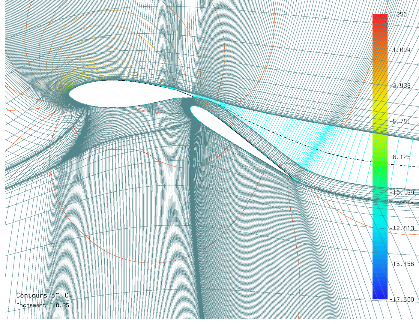

    However, for a multi-element section, things can happen in the middle of the flowfield that are not captured by boundary element methods. As the wake from the main element of a wingsail passes by the flap, it experiences increasing pressure over most of the flap chord. This can cause the flow to back up in the main element wake, leading to wake bursting and separation. An Euler code like MSES can predict this, while a potential flow code like Javafoil cannot.
    Here's an MSES prediction of such a case. MSES uses an adaptive streamline-fitted grid, so the grid lines show the flow direction.
    You can see that the flow through the slot is attached to the flap lee side, while the wake is separated. All the telltales would be lying flat, but the wing would be stalled!
    I can't put my hand on it just now, but I have run across a report of wake bursting being observed in the flight test of a STOL research airplane that used boundary layer control. Wake bursting really does occur - it's not just a numerical aberration.
    Mikko Brummer likes this.

    There's also the possibility that the wake from the forward element can merge with the flap's boundary layer, creating an even larger viscous region.
    I don't know whether MSES has been applied to such cases, but I suspect that's a condition that would require Navier Stokes codes, not just Euler/boundary-layer.
  11. tspeer
    Joined: Feb 2002
    Posts: 2,319
    Likes: 305, Points: 83, Legacy Rep: 1673
    tspeer Senior Member
    That case would only happen for small flap deflections, and MSES won't converge then. It would require an NS code. My approach has been to assume those cases lie in the linear range and extrapolate the lift, drag and moment from the cases I can get to converge.
