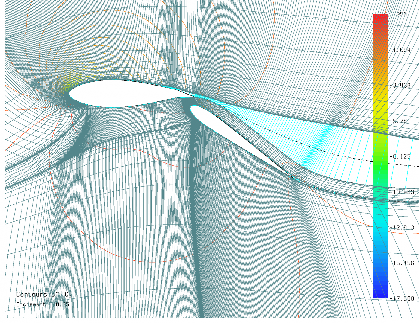

    You need to take maximum lift predictions from Javafoil with a bit of skepticism. There area stall mechanisms that Javafoil cannot calculate. One big one is wake bursting. This occurs when the wake from the forward element passes through the region of increasing pressure generated over the flap. The low-speed flow in the wake gets pushed backwards by the pressure, leading to separation in the middle of the the flowfield. What's left is the flow through the slot that adheres to the flap as a wall jet.
    The attached figure shows the streamline-fitted grid calculated by MSES around an AC72 wingsail section with the flap at 30 degrees and an angle of attack of 5 degrees. The wake has burst, leading to flow separation. The flow above the wake from the main element is no longer following the flap. But the flow through the slot is attached to the flap. Telltales on the wing would all be laying flat, yet the wing is stalled!
    The calculations in Javafoil only concern the boundaries of the flowfield, but for this kind of stall the entire flowfield has to be discetized.
    In my studies with MSES, I find it's pretty hard to get to get the maximum Cl to approach 3. Cl for the example shown is 2.5.

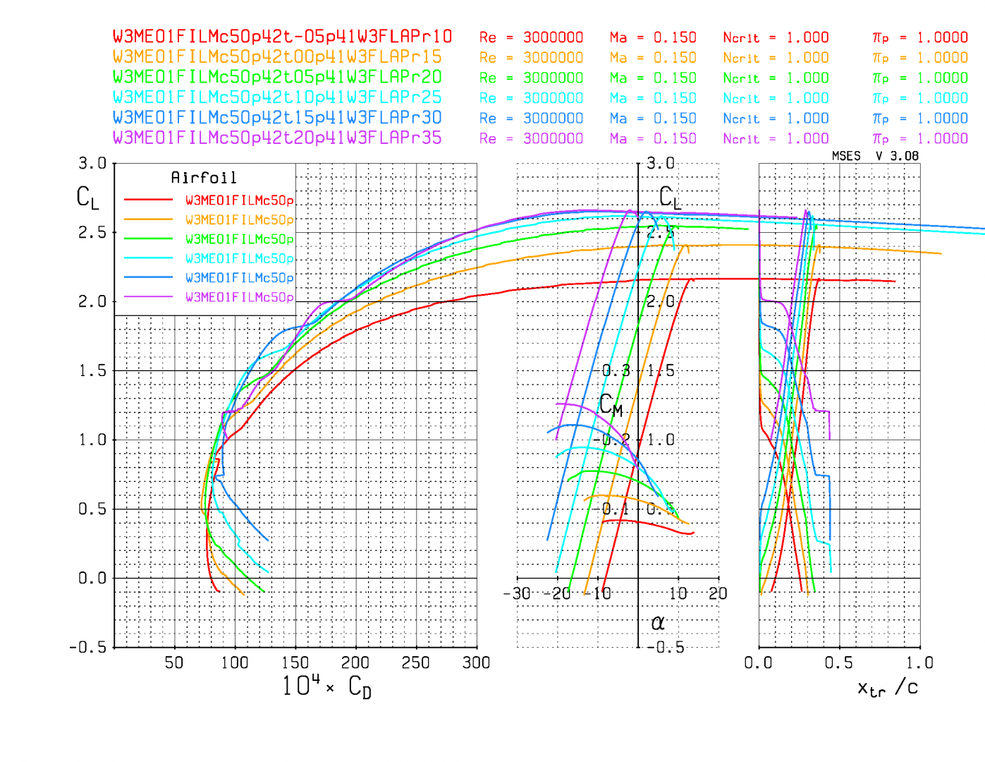

    tspeer Senior Member
    Laminar flow can be important to high lift. A.M.O. Smith talks about it in the attached paper. BTW, this is probably the single best thing I've ever read on the subject of high lift airfoils. However, he doesn't cover topics like wake bursting, and his design philosophies are mostly aimed at high Reynolds number airfoils. But the principles he describes are still applicable to other situations.
    As a practical matter, it's best not to design a section that depends on laminar flow to avoid premature separation. The risk of not having laminar flow when you need it is too great. When the AC72s were sailing in the fog on San Francisco Bay, the wingsails were covered with water droplets. I doubt there was any significant laminar flow to be had in those conditions.
    Supercritical airfoils and laminar flow airfoils are two quite different things. Supercritical airfoils are sections that are designed to operate at transonic speeds, where the local velocity can exceed the speed of sound over part of the section. This is not directly related to the boundary layer characteristics.
    Laminar flow airfoils are designed to maintain substantial runs of laminar flow. This is all about the boundary layer characteristics.
    Supercritical airfoils and laminar flow airfoils can often look much the same, because both often employ "rooftop" design pressure distributions in which the pressure is constant over for forward part of the suction side. In the case of supercritical sections, the design pressure distribution is driven to keep the maximum velocity just below Mach 1, or to minimize how much it goes past Mach 1 in order to not form a strong shock wave when the flow has to decelerate. In the case of laminar flow sections, like the NACA 6-series, an adverse pressure gradient is destabilizing to boundary layer, so a constant pressure region is often used to delay the amplification of disturbances that can lead to transition to a turbulent boundary layer. So you get similar shapes for very different reasons.
    The angle of attack range for laminar flow can be much greater than a few degrees. I've attached MSES computed polar plots for the AC72 section shown in my previous post. These were computed with the assumption of natural transition. The different colored lines are for different flap deflections, ranging from 10 degrees to 35 degrees. The plot on the far right shows the location of the transition location on the upper and lower surfaces. In the middle of the operating range, say 1.0<Cl<1.5, there is laminar flow over roughly a quarter of the chord on both the suction and pressure sides. As the angle of attack increases, the transition point moves forward on the suction side and aft on the pressure side. When a leading edge suction peak forms on the main element, transition can move abruptly to near the leading edge, which causes the sudden increase in drag. The blue 30 degree flap lines are a good example of this.
    The sudden shift in transition location due to forming a leading edge suction peak is what causes the distinctive "drag bucket" associated with laminar flow section drag polars. A section can be designed to have a wide, shallow drag bucket, or a deep, narrow one.

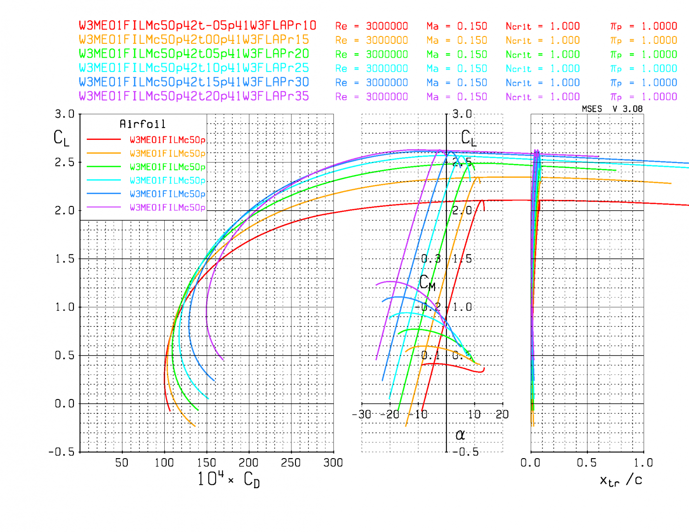

    Camber can be used to shift the drag bucket to a different range of angles of attack or lift. The attached plot shows an example of this. Consider the section operating at Cl=1.5. With 20 degree flap deflection (green line), this operating point is outside the drag bucket and there is excessive profile drag. Increasing the flap deflection to 25 degrees (cyan line) and decreasing the angle of attack to get back to Cl=1.5 puts the operating point just inside the drag bucket. This produces the best performance, but is risky because any additional angle of attack will result in a substantial increase in drag. Increasing the flap deflection still more to 30 degrees (blue line) and reducing the angle of attack further shifts the drag bucket to a higher lift range. The Cl=1.5 is now comfortably inside the drag bucket a the cost of just a few counts of profile drag.
    The last figure shows the MSES computed polar data for same airfoil and flap deflections, but this time the boundary layer was artificially tripped at 2.5% of the chord from the stagnation point - essentially a fully turbulent boundary layer. That's why the transition locations plotted on the far right are all near the leading edge. The drag polars are all smooth curves because there is no rapid change in the transition location. The drag is higher in this figure compared to the previous one, showing the benefits of laminar flow even for a comparatively high-lift section, and over a wide range of angles of attack.
    The design philosophy for this section was to aim for a balanced design that took advantage of laminar flow but didn't depend on achieving it. There isn't much difference to the maximum lift with or without laminar flow. The profile drag could have been reduced by pushing for more laminar flow. Or it could have been optimized for higher maximum lift by sacrificing some laminar flow in the middle of the operating range.
    I agree that it's not enough to design for laminar flow. The wing has to be built and maintained to support a laminar boundary layer. However, if we're talking about high performance craft that sail faster than the speed of the wind, drag is always detrimental to performance. They never sail for long near dead downwind where the rig acts more like a parachute than a wing.
