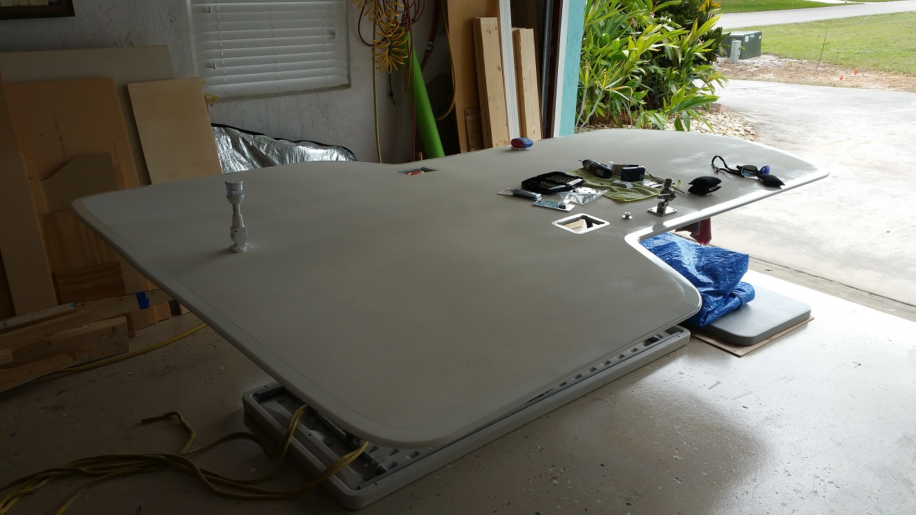

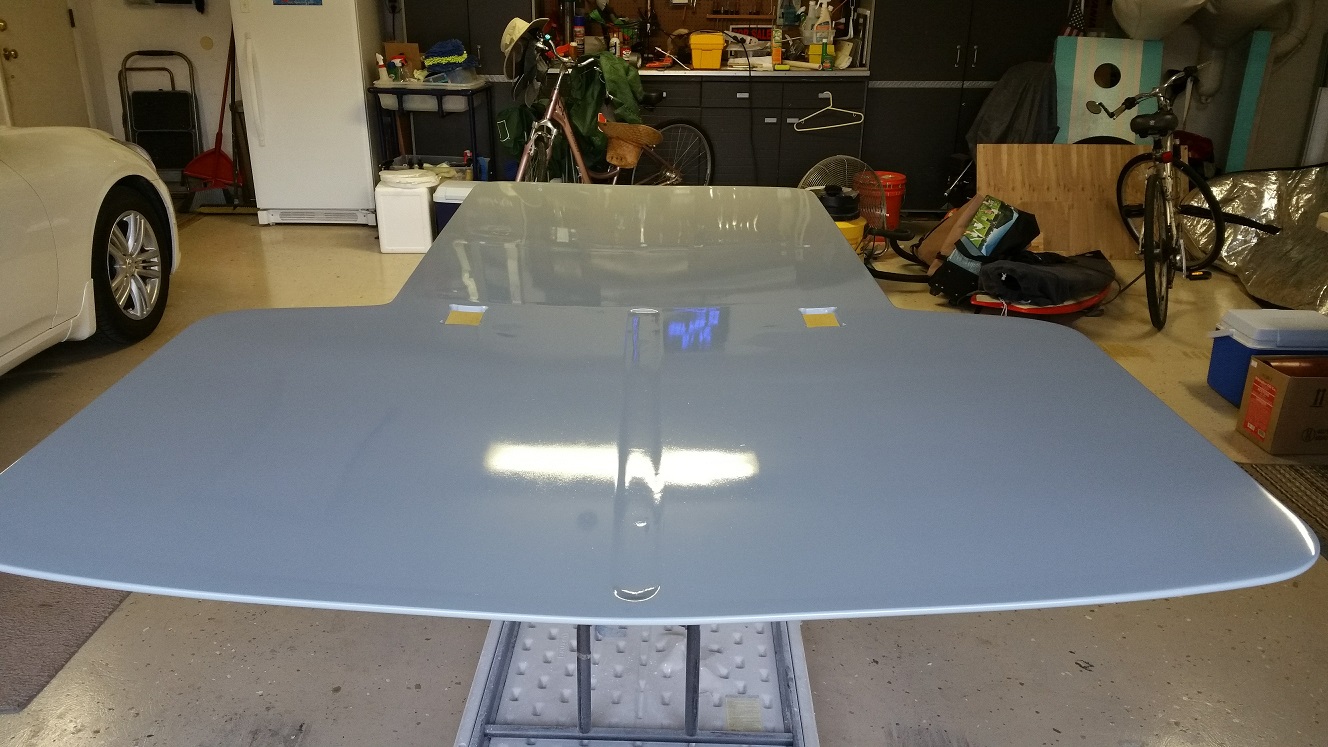

    My hard top is finally finished. It was a huge amount of work (8 weekends!), much more than I estimated, but it came out very nice. I've included a few pics below but this post is about my planned method of attaching this hard top to the T-Top tubing.
    First of all, the Key West style top was vacuum bagged using a 1/2" Divinicell H80 core with 10 oz glass on both sides and another layer of 1708 biax on top. This is all epoxy resin (US Composites). The finished product, with many coats of Awlgrip 545 and then Awlcraft 2000, weighs in at about 44 lbs.
    The new hard top was built with a camber that exactly matches the existing T-Top tubing. The boat is a 29 SeaVee that originally had a Weblon top.
    I am planning to use Sikaflex 221 to attach the top to the aluminum pipework. There will be NO fasteners holding the top down. The T-Top tubing is VERY rigid and well made and this top is about 1/4 the weight of a production hard top. The 3/16" gap between the top and the aluminum tubing will be filled with the Sikaflex (gray). The goal is to not allow any contact between the paint on the underside of the hard top and the T-Top tubing.
    There will be approximately 60 linear feet of adhesive with a bead of 1/4" wide.
    Does anyone have serious concerns with this attachment method or first-hand knowledge with Sikaflex 221? I'm especially interested in ideas that will help to ensure the best possible bond between the painted underside of the top and the aluminum. Aside from getting those surfaces totally clean is there anything else I should do?
    Thanks in advance.

    Well, I've just discovered this thread and yeah I have several issues. Sikaflex 221 is a sealant, not an adhesive, though it does have some adhesive properties, it's no way capable of holding the top on at speed or in gusty condisions. There's two basic reasons for this, first is you're bonding to paint, not the top's structure and second, the stuff just isn't very strong, particularly in tension, which it will be at speed and with wind loads. Wind loads are pretty easy to figure out, just multiply by the cantilever and you get the amount the minimum peel strength will need to resit. Add a reasonable safety factor and goo's in a tube quickly drop off the list. Simply put, Sikaflex 221 has about 250 PSI tensile strength.
    Bonding something that needs to be strong to a painted surface means you're relying on the band to substrate bond, to hold it on. You look to have done a very nice job of your hardtop, do you really want to lose it, the first time out?
    Yep, mechanical fasteners are the typical method and for logical reasons. A 1/4" stainless bolt will offer thousands of pounds of tensile strength in comparison to Sikaflex 221 or other polyurethanes, bonded to paint.
    If you want to isolate the frame from the top, the bead of goo idea can still be employed (I'd use a gasket) with small stand offs for the hard fasteners, possible made from HDPE or UHMWPE. Possibly some machine screws in the top and "nutserts" in the frame and you're good to go.

    First, thank you for the feedback - it is appreciated. This mounting issue has been gnawing at me since I started to build this thing. Let me list a few reasons why I'm not sold on the idea of fasteners:
    1) Galvanic corrosion between stainless fasteners screwed into the
    anodized aluminum top. In some areas this would not be an issue since
    there are 1/4" plates that I could use for the anchors. In other areas,
    unless I have a local shop weld on some tabs, I'll be tapping a 1/4"
    hole into a 1" OD pipe in places and this could lead to future corrosion
    and cracking.
    2) Large (ugly) fender washers or the like would need to be used on the top
    side to spread the fastener loads to avoid cracking the lamination/paint.
    3) The top is horizontal of course so while there are wind loads to consider,
    it's not exactly a sail since the cross-section area is very small.
    The Sikaflex 221 spec sheet here does say this product is a "Sealant/Adhesive" and also includes the following:
    "Sikaflex®-221 bonds well to a wide variety of substrates and is suitable for
    making permanent elastic seals of high adhesive strength.
    Suitable substrate materials are wood, metals, metal primers and
    paint coatings (2-c systems), ceramic materials and plastics."
    Using the stated 260 lb PSI tensile strength and about 60 linear feet of 1/4 wide beads of the adhesive, I calculate approximately 3900 lbs of tensile strength. That's pretty strong. Even at 50% of this we are at almost 2000 lbs.
    I know this isn't 5200, but I hate 5200.
    I may compromise in the end and add two forward mounting fasteners. In the aft part of the top the outrigger bases are actually serving as large fasteners since they contact the top (with a starboard shim) and are bolted to aluminum plate that is part of the welded t-top structure.
    So 4 attachment points and then Sikaflex 221 all around should work.
    Additional thoughts?

    Second, consider that you're not bonding to a square support, it's a tube. The actual surface area that you'd have for the bond would be pretty small. You're also depending on the paint to hold the top on the tubing. I know that Sika says it will work, but I'm suspicious. There's a big difference between laminating a couple of pieces of wood together and what you're looking at here.
    Why not consider stainless steel, through bolted (not tapped) and if you're concerned about galvanic corrosion use nylon sleeves between the bolts and the tubes.

    I'll do a final fit check this weekend with the finished top and take some pictures and add them here. As I mentioned in a previous post, I am leaning towards installing 2 forward attachment points along with the rear attachments that will be the outrigger bases. For the forward points I'll probably use some 3" tower pads to spread the load on the top and use a few 1/4"-20 stainless fasteners that will let me snug the top down to the frame. I see these attachments mainly as "insurance".

    Sorry, but I don't think you have a clue. That stuff isn't nearly strong enough, and even if it was, the paint isn't. Through bolt the lid about every 4 inches with 1/4 ss bolts. I'd suggest using an ss bonded sealing washer on top. Begin by drilling and filling 5/8" holes so that the fasteners all have a compression annulus. Then, reinforce the edge with 3-4 more layers of 1708 or similar making a decent C channel. Now you will have a 55# hardtop which, with 5# of bolts and acorn nuts, will stay attached and probably in one piece. The bolts will require a local laminate thickness of about 65% of their diameter. This can feather out starting about 2 diameters from the bolt Cl or just beyond the washer. So 4 or 5 layers of 17-08 flanging the bolt on both sides of the core.
    There is a reason the production hard tops weigh 4 times what yours does - they quit making them heavier when they quit ripping off the boats. Consider driving down the interstate with a 40 mph headwind or cross wind. These things need to handle hurricane force winds as normal everyday occurrences for 20 years. Unless there are metal bows underneath, your top will probably oil can out on the water. I think we used to use 1 1/4 Nidacore for this, with metal or wood ribs and a solid perimeter.
    I think this is why 65 people didn't say anything about your proposal.
