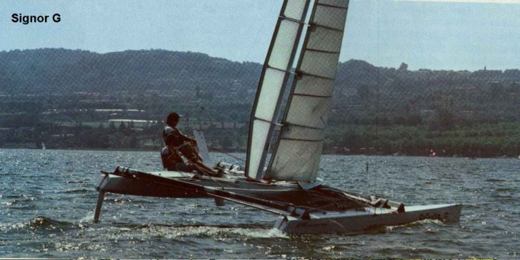

    Signor G had a gurney flap.
    Wing was a morphing surface controlled by cables.
    Flap was hinged at the aft end of the battens.
    The flap control system put additional compression on the battens, which having been deflected out of column, tended to explode.
    The control system was like tuning a piano with miles of very light wire and hundreds of little turning blocks. All the tensions had to be right for the system to work properly and if a wire jumped a sheave, battens that didn't reverse their camber would cause serial failures throughout the system. Replacing battens and rewiring would take all night.
    It's possible that modern materials and low stretch cordage would now make such a wing practical. Someone should try to figure it out.

    The best flap in the wind tunnel work was 2% of the chord, much smaller than the one you've shown, so it would not have the bad effects on the battens.
    I've used the flap on a sail sheeted like a junk sail with sheetlets at each batten and had no problems. My flap was also bigger than 2% so I'll be trying a smaller one on the next sail.

    It wasn't the gurney flap that caused the problem, but the larger "#2" that, because the control arms were so small, required quite a bit of tension on the control cables to give adequate deflection.
