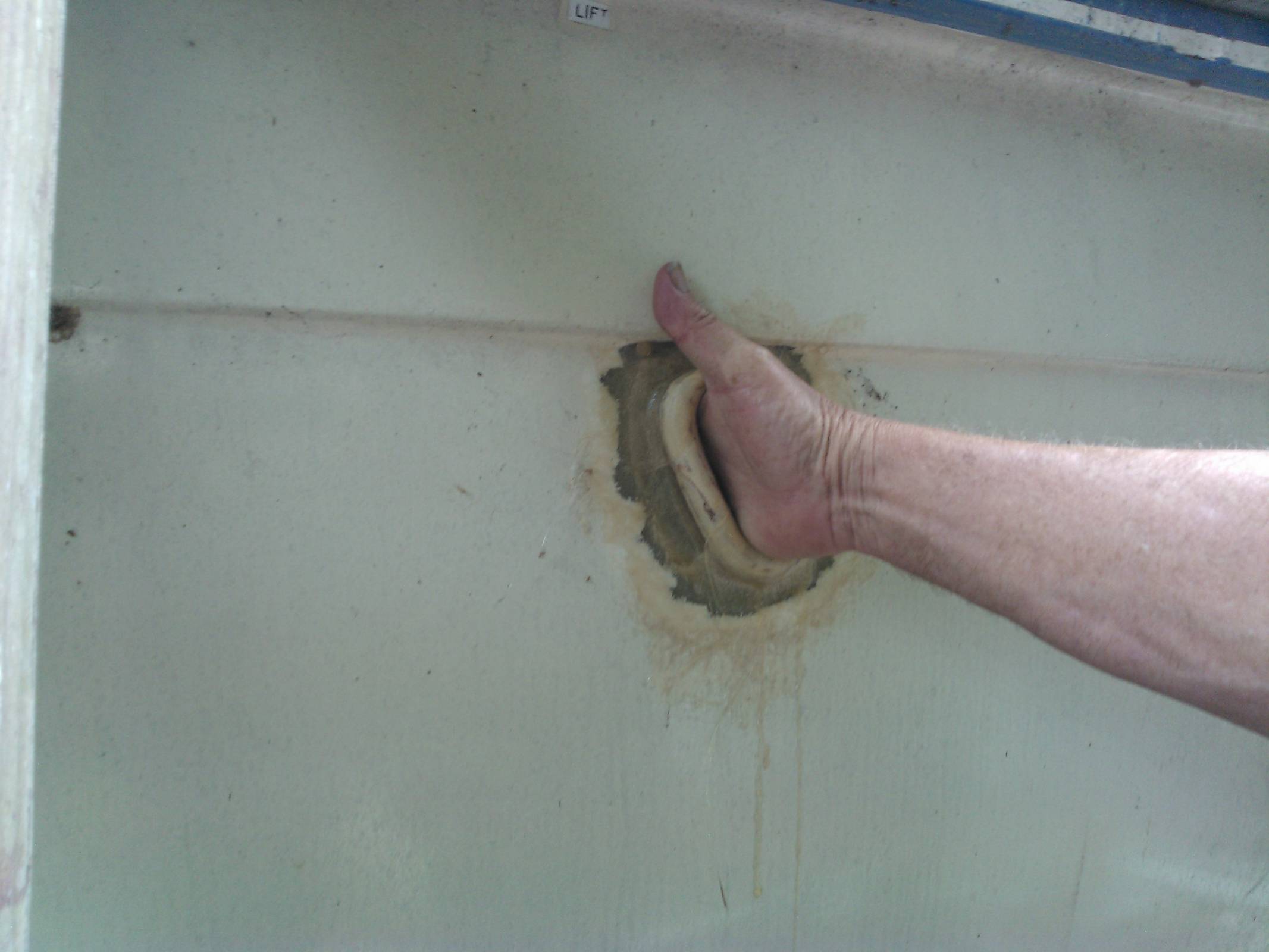

  9. hoytedow
    Joined: Sep 2009
    Posts: 5,779
    Likes: 352, Points: 93, Legacy Rep: 2489
    Location: The Land of Lost Content
    These photos show the scuppers/freeing ports/scupperzillas, the last one has Yobarnacle's hand to show the scale. These are located along the aft portion of the deck.
