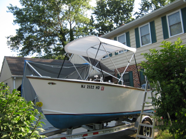

    Blue Heron
    20110717_0110.JPG My little dead rise.
