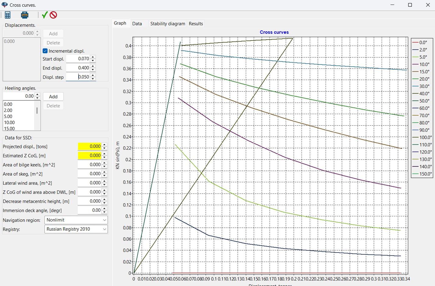

    First attempt was to build a nest boat cut in half. But I don't know if it's too much hassle during assembly.
    I'm leaning towards a one-piece build.
    Crew 2+2, crew weight 230kg.
    LOA 23' (7m)
    BOA 49"-52" (125-130cm)
    Freeboard: 27"(60cm)
    Draft: nothing
    Hull weight for roof transport : (???)
    Propulsion: 2x 30 hp 2stroke prop.
    Propulsion options: 1x50hp 2stroke, 2x50hp 2 stroke, 1x70-90hp 2 stroke, 1x60hp 4 stroke, prop or jet.
    Weight of the engine/s around 100-150 kg.
    Single engine setup make cumbersome engine hookup shorthanded.

    Hi montero. Draft zero = you are dreaming. 230Kg + 1 or 2 outboards + your extra gear and fuel will get you several inches of draft at least. 2 outboards on 130 cm beam will be a busy stern. Fuel for 2 x 2 strokes for 100 Km will not be light, even if going slow; 2 strokes are not fuel efficient by nature. How do you intend to lift it to your roof? Do you own a Hummer, or something stable enough to take a long 'heavy' roof load? You will be speed restricted anyway, especially taking corners, and in high head and cross winds. Mounting the OB's at the water will be about the same work as assembling a nested hull.
    Buy a junk boat on a good trailer, and sell the boat, then adapt the trailer to suit.
