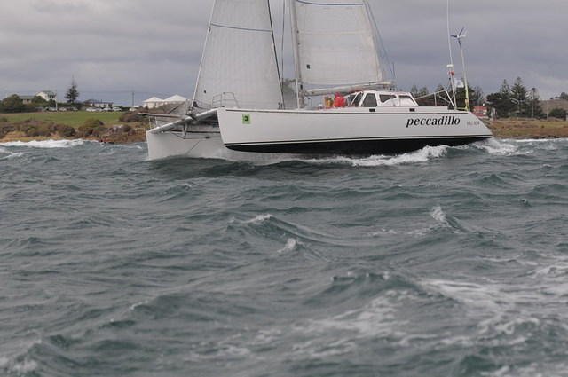

    http://4.bp.blogspot.com/-XVe7oF-kd9o/UVf8lVbtqnI/AAAAAAAAAAs/9o3p954DQ_Y/s1600/PSC_8429_resize.jpg
    http://4.bp.blogspot.com/-rm90BcOO0RE/UVf8pIc5zXI/AAAAAAAAAA0/Xr9YnlXUzRc/s1600/PSC_8398_resize.jpg
    http://multihullblog.com/2013/02/catamarans-and-waves/
    and did it not capsize - not sure but corley would confirm whether it did or not.
    A land cruiser will roll a lot sooner and faster than a
    Porsche on a dirt road. A Porsche will never roll on a dirt road if the correct tyres are used and has a better gear box gearing to slide around corners.
    Cats get severe slamming going to windward.
    Can you honestly say the cat in the two pics hyperlinked would get a good sleep even during the day if the owner as they always do put the crew in the grave yard watch time slot.

    Those boys on Peccadillo are very experienced it's an awesome boat no capsizes and one win so far in the Three Peaks Race. They set a new course record for the first leg but unfortunately both rudders gave up the ghost during the race on the second leg. Peccadillo's back in Melbourne now and fitted with new hopefully bulletproof rudders is ready for some more ocean racing challenges.
    I've reached the stage now where after being exposed to magic carpet ride, jiggled and flung around on a variety of cat's and tri's in rough conditions that I'm not sure whether either has a particularly preferable motion they are just different sometimes worse sometimes better. Just as their owners wants and needs are different. Peter Aschenbrenner of Paradox is very happy with his trimaran in terms of comfort and ease of motion. Bigger multi's are more comfortable than small ones no doubt there.
    http://sailinganarchy.com/2013/03/07/touching-the-void/
