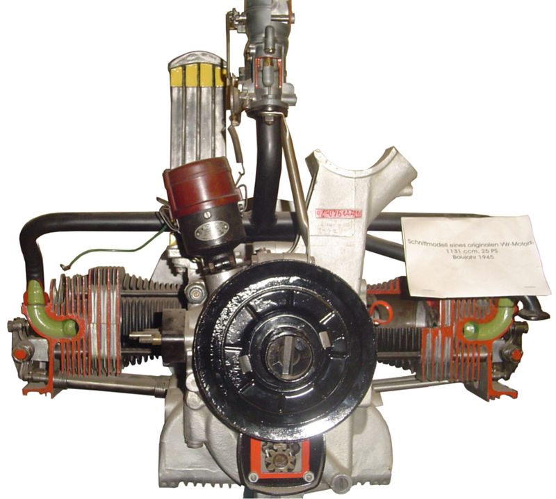

    If you can get extra torque from your boat motor as well as increased safety why would you not want to do that.
    http://shareaproject.com/manageProject.php?p=9
    The vw wagon motor is well known for it`s low RPM torque and has long induction tubes to achieve that.
    Using a long induction tube to remotely fit a carb out side of the hull so there are no parts of the fuel system able to leak fuel to gather in the bilges, and also fit your fuel supply out side of the hull must be a safer system.
    This system can be applied to EFI system as well.
    You can still use Marine parts and comply with boat building regulation.
    Using ram tubes can give more than 100% volumetric efficiency so replaces expensive troublesome turbo needs.

    Low end torque is not really needed in boat application.

    No one considers aircooled vdub motors torque monsters in any configuration.

    Good torque at low RPM is desirable in all internal combustion engines especially boats to get on to plane easily.
    Internal combustion engines need to develop revs to build up HP.

    Good torque at low RPM is important in any motor you wish to choose and ram tubes give motors better torque at the RPM you choose. There are few motors without ram tubes now.
    Why do you think turbo`s are fitted to motors, same effect but ram tubes are simple and effective and are free extra HP and do not put extra wear and tear like high lift cams and other devices, and less expensive and low maintenance.

    "Using ram tubes can give more than 100% volumetric efficiency so replaces expensive troublesome turbo needs."
    The problem is that proper induction tubes as well as a proper length exhaust work at ONE RPM .
    If you set the engine up for cruising at this specific RPM great , other wise it can be a power loss.
    The turbo will assist as long as the engine is spun fast enough and hard enough to have plenty of energy (pressure and temp) in the exhaust.
    6-9speed Transmissions allow the RPM to be kept low for fuel efficiency , after turbo boost begins.
    "Using a long induction tube to remotely fit a carb out side of the hull so there are no parts of the fuel system able to leak fuel to gather in the bilges, and also fit your fuel supply out side of the hull must be a safer system."
    Coming along side might be expensive if Webbers are used , andv an errant wave top into the intake could cost the motor.

    Tom I have quite a bit of experience with what you're calling ram tubes. Intake runner length is married to a number of things and have several good and bad things to consider about them.
    Intake runners are sized to the operational expectations, of the engine's performance environment. In most boat engines (full plane mode craft), you'll want short, straight, properly sized and shaped runners. Again, because of their typical operational environment, which is at or near WOT, much of the time. Also because of the operational envelop, long runners would cause atomization "drop out" in the fuel vapor/air cloud. This kills efficiency and intake manufactures have been addressing this issue for decades. Insuring atomization in the cloud is vital and one of the reasons, direct injection is taking over. This is because you can live with some turbulence, if it's just air, which can be reshaped and smoothed in route, but drop out is just a killer and not much can fix it, except shorter, cleaner runners.
    The ideal runner, used on the type 1 example you've shown was a direct evolution, from the early 35 HP version you've shown (which wasn't very efficient BTW) to the dual port, twin carb setup (and eventually injected). The cut away view of these show intake runners that are 1/5th as long and they drop straight into the port, without two 90 degree bends. Of course, this required a new head design (dual port), but class racers used the same approuch on the old single port heads, simply making 3" - 4" tall runners to stand directly over the port, to which a carb was bolted. These were far superior to the handlebar manifolds or the stock configuration.
    With carburetor engines, you'll get better intake efficiency with shape, texture (amazingly enough) and diameter. Flow bench testing has repeatedly proven straight, well sized and shaped runners will do more for you than runner length. The only place vapor column length can offer improvements is pre-throttle plate, not post throttle plate. With carbureted systems, the vapor cloud stacks up over the air horn, above the throttle plate. Most american car air cleaner assemblies limit this height, mostly for under hood clearance, but in race applications, where there's no underhood limitations, the air cleaner is taller, often much more so (3 - 4 times as tall). Additionally the inlet to the venturis and air horns typically have a smooth and shaped ram to permit shaping and partly pressurizing the air mass as it enters the top of the carb. If you take this one step further (many racers did), you put a velocity stack over it, which permits the vapor cloud to stand up further, straightening out the flow and making better atomization once it passes the through the carb. In fact, the stock 35 HP VW air cleaner did just this, with a 4" tall tube (old oil bath cleaner) within the air cleaner, which straighten out flow. On racing lawn mower engines, where tweaking every ounce of energy out of a 12 HP single cylinder motor is key, they'll install a length of pipe on the air horn and the air cleaner above this, again, to permit the vapor cloud to stand up over the carb and get straightened out, all the while retaining as little drop a out as practical.
    Lastly, long intake runners make starting an engine in cool or cold weather, all but impossible. Most applications with long runners required some sort of runner heating arrangement to permit cold weather starting, which in itself is a crutch for a clearly less efficient setup. Anyone that's owned one of the cross ram style of intakes from the early and mid 60's muscle cars will simply tell you, you could start them in the winter. Some would use a sleeping blanket on their engine, others wrapped the intake runners with block warmer wire. I had a 413 wedge with a cross ram and it wasn't startable in winter and though some modest improvements were seen with the cross ram setup, it was quickly abandoned in favor of straight up and down twin 4 setups, which incidentally had shorter, straight runners too.
