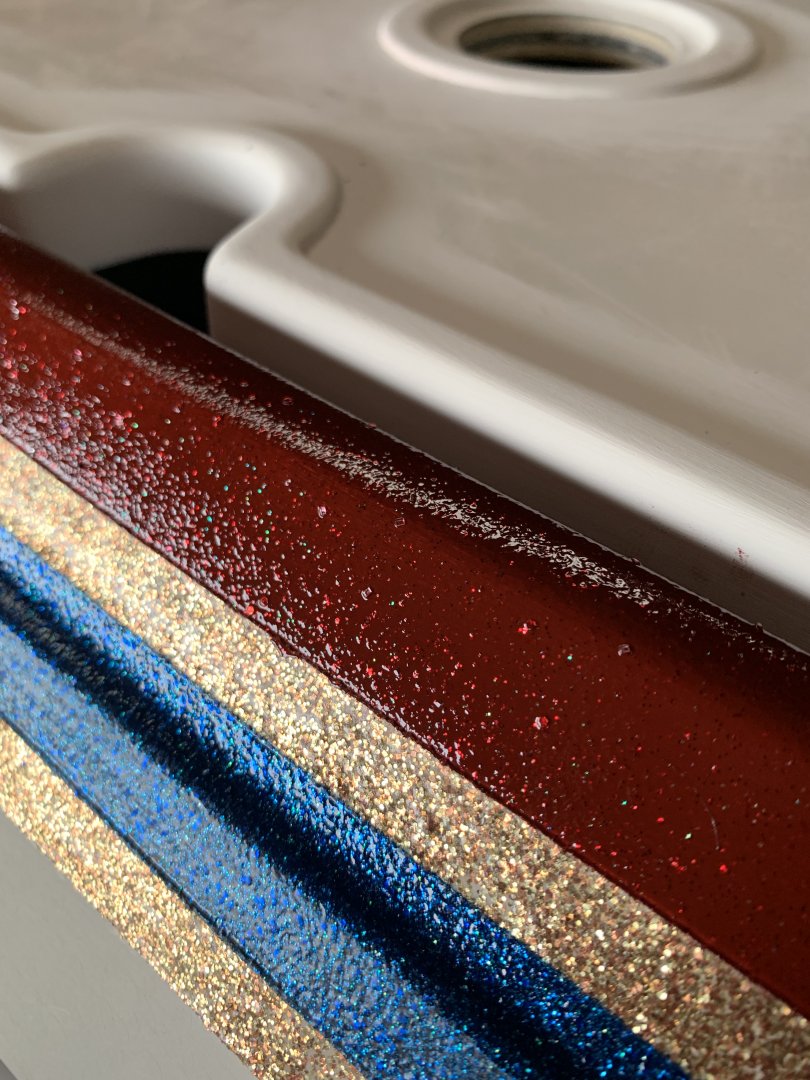

    6D515E9E-A903-4667-AF87-BA83A92ED09B.jpeg 3319671E-F8A8-4D12-B11E-7677843806C0.jpeg B9EDBACF-A0EB-4BCC-98D5-D4C905228ACB.jpeg Just a little closer.
    Kind of like life just one color at a time.
    Sanding a little on the off days / cool and rain.
    One white left to do clear, then metal flake and a sand coat of clear.
    Then it’s sand, sand, sand, and final clear coat of gel coat.
    Then buff, buff, buff.
    Have encountered all the dreaded obstacles, from tape left a little to long,
    Adding not enough MAKP , and to much for the temperature conditions and having it set up in my gun.
    Fortunately I was able to clean it out.
    Acetone is spray guns best friend and don’t forget tooth picks and brush kits made for the equipment.

    Well I may have shot myself in the foot, by sanding my metal flake smooth.
    I cut thru in mot of the clear and cut the metal flake.
    The whole surface looks cloudy and dull so my question is will clear coat bring it back to a shine.
    If I shoot over this with a little abalone in my clear will it help hide my cut metal flake in my red?
    Or do I need to shoot my red clear coat with metal flake again ?

  5. ondarvr
    Joined: Dec 2005
    Posts: 2,978
    Likes: 610, Points: 113, Legacy Rep: 506
    Location: Monroe WA
    ondarvr Senior Member
    Sanding into the flake can change the look. Try putting water on it, if it looks good you may be ok. You can also spray some rattle can clear on it, this will also show you what it will look like with clear gel coat on it. The clear can be washed off with an acetone rag.

  6. elkmaster101
    Joined: Dec 2018
    Posts: 42
    Likes: 0, Points: 6
    Location: Ames
    elkmaster101 Junior Member
    I haven’t done a thing to the white yet, it will get a white and abalone pearl clear gel coat then follow up with a clear gel coat over the whole boat.
    This will be a one day shoot . And possibly shoot it 2 coats of clear.

  7. elkmaster101
    Joined: Dec 2018
    Posts: 42
    Likes: 0, Points: 6
    Location: Ames
    I’m going to do that In a small area.
  8. ondarvr
    Joined: Dec 2005
    Posts: 2,978
    Location: Monroe WA
    Try to not build up too much clear over the white, you’ll notice it will darken the white. You don’t notice this as much over darker colors.
