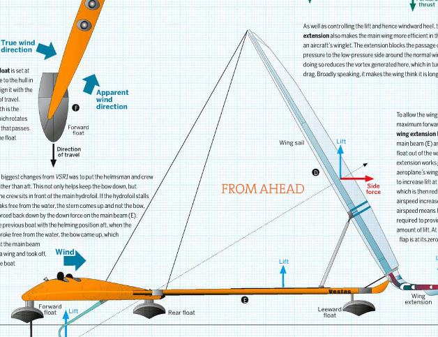

    Illustration from Yachting World(Matthew Shehan). This illustration shows a net vertical lift from the foil when the boat is flying:
    click-

    That's obviously completely wrong, and disappointing from Yachting world. If that was the force distribution the boat would take off and lurch to leeward. Ridiculous to make such a basic error for a Smith vessel.
    Edit: Assuming the rest of the figure not shown does not give an alternative force component!!

    There is a more complete version of that sketch around but so far I can't find it.

    If I remember correctly, they experimented with a few types of main DOWNFORCE foil designs - and then ended up reducing the areas of the finally accepted version by some considerable amount. Need to re-read the information again though.
    Yes, that is inexcusable by Yachting World.

    After much looking I found a version of what I was looking for. Remember, I said that the portion of the foil above the transition curve is designed for vertical lift:
    from www.sailrocket.com/node/497 (comments-"reply armchair")
    Yes, the foil is blunt above the transition (radius). The foil above the radius is affected by both the leeway angles of the boat and the pitch settings of the foil. Seeing as the upper foil is at 30 degrees to the HORIZONTAL, the horizontal pitch settings affect this section of the foil more than the more vertical lower section. The upper section of the foil is more responsible for generating vertical lift. If it generates too much then the back of the boat rises until we reach the transition (radius) of the foil where the vertical component lessens. If we go too far then only the bottom section is left in and that is angled so it is pulling down more than the rig is lifting i.e. we will have net negative lift and be pulled back down to the transition. The boat should seek balance around this transition. If we are riding too low we can increase the pitch of the foil to generate more lift on the top section or decrease the whole inclination/roll of the foil. Getting the right settings is key to making the foil perform. We are still playing with it.

    As can be seen in the photo's in that article, and others, the horizontal portion of the foil is not in the water at speed, so is not generating any substantial lift in this condition. If it was, then it would be fighting the lower portion of the foil, and just making unnecessary drag. However, looking again at the record run (different foil), a small portion of the upper foil does look to be immersed for most of the run, so you may indeed be correct and they are using a small portion of the upper foil to ensure close control of the foil immersion. If so, very good spot Doug!
    This would suggest there is more performance available from SR2.

    That last comment by Paul is not the only reference to using the upper portion of the foil for vertical lift and there are many references to the curved radius of the foil as the "transition radius"-which he explained above as the transition between vertical lift and downforce and is the main altitude control geometry of his foil concept.(and why he refers to the boat as a foiler)
    The comment by Paul that I read years ago and kept me searching the last few days where he specifically references the upper part of the foil being used for vertical lift up to around 25 knots-remains elusive but his comment in my last post is ,perhaps, better for a more complete understanding of altitude control on SailRocket-at least the role the foil plays.

    Okay, the upper section is lifting, however that is small potatoes to the lower section's hard negative lift (just look at that spray from the hole it digs).
